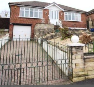

To my way of thinking, bungalows are all about accessibility. Yet near us, there are many of them on a hill, meaning they have steep driveways and steps up to the front door.
Same here re steep and NARROW driveways and busy roads on hills. Most have cr..py little narrow steps at the front door and from kitchen into the garage. They sell like hot cakes if they're in any sort of a decent area. A lot are 1960's builds and must have been built for folks in their 60's not 80's, plus cars were a lot smaller then and a lot of couples didn't own 2.

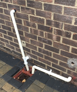

Apologies. Have a head full of fluff ATM. The drain I posted the photo of is the one for bathroon sink/shower up the side of the house. There's a downpipe on the front corner of the property, but how much of the surface water run off will end up in there is debatable. None from the area that was the original drive. Pain in the proverbial. Have posted on the Planning forum. The local council website says anyone who's making any changes to an existing drive or creating new parking MUST contact them, whether PP is required subsequently or not. Be interesting if we contacted the council to get a license to extend the dropped kerb as it says they will ask for evidence that you spoke to the council about the changes to the drive before they even entertain an application. It gets better.
How do you find out whether they're going to the drains ? LA drainage search?
I can tell by looking that at least one of my downpipes empties into the sewer because it is routed to the drain where all the grey water from the house goes. In fact there is a hopper half-way down it which the bathroom wastes run into.
i.e. when you look at my equivalent of this:
you'll see they grey water waste pipe from the kitchen and one of my gutter downpipes.
I'm not sure if the water from the downpipe at the front of the house goes into the house sewer, or the street surface water drain.

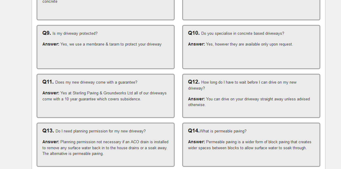

Exactly! Madness when you've paid for a new combi'. It's their first house. Maybe they'll learn the hard way. Agree re block paving guarantee. Somewhere (in the legal searches I think) it says what the nature of the soils are. I'll have a look but don't think it's clay. Not sure the company actually understand what needs PP and what doesn't TBH!

That faq is a joke, "do you specialise in concrete driveways? Yes but we only do them on request"
So firstly block paving is not their specialism, and secondly why would they do a driveway without being asked to:LOL:
So it kind of suggests they got the new trainee to make up the FAQ information and they probably don't care if it's right
