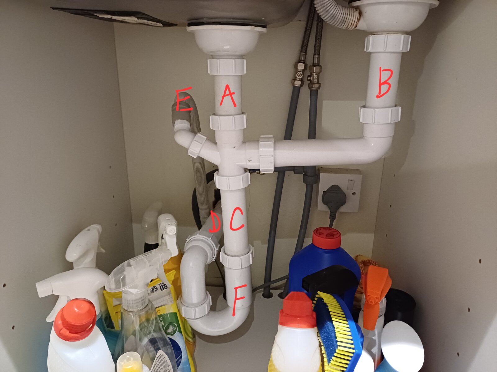

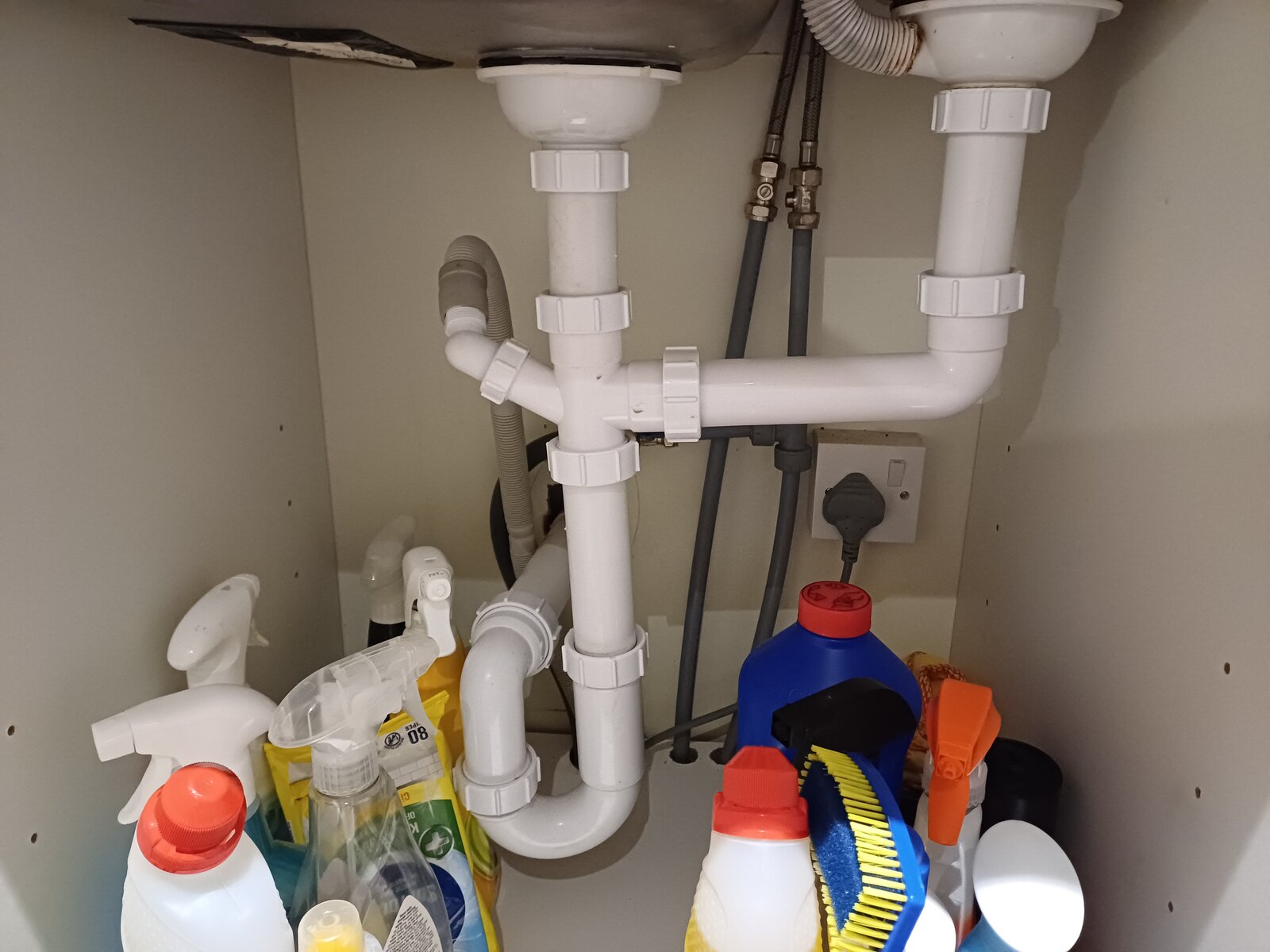

Here's the pipework under the kitchen sink.

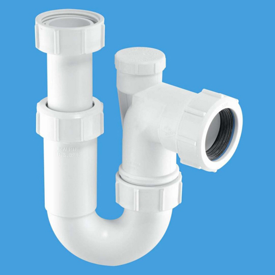

OK - look like an adjustable anti vac (syphon) trap will replace that.
Adding to that - they could have made all that a lot tidier - taken in higher up closer to the sink bowls and then down the back of the cupboard to give you more useable space in there, the appliance waste should also be raised up as high as possible inside that space and then down to connect to the spigot.
All of that makes good sense. I just need to understand exactly how to do it. The simple bit seems to be replacing F with the trap you've recommended. I understand shortening A and B, and possibly C and D too, but not clear on how to direct to the back of the cupboard to create space. As for E, do you just mean raise it as much as I can at the point it connects to the spigot? I don't think I can get to the bottom of it though. It's for an integrated dishwasher that's right next to the sink cupboard.
Your machine drain, E, needs to loop up, just as high as possible, before dropping. Ideally, the top of the loop, should be higher, than the highest level of water, you can ever get in the sink. The idea is - if the outlet D, becomes obstructed, as E is at the moment, water plus debris in the sink, will back flow into the machine.

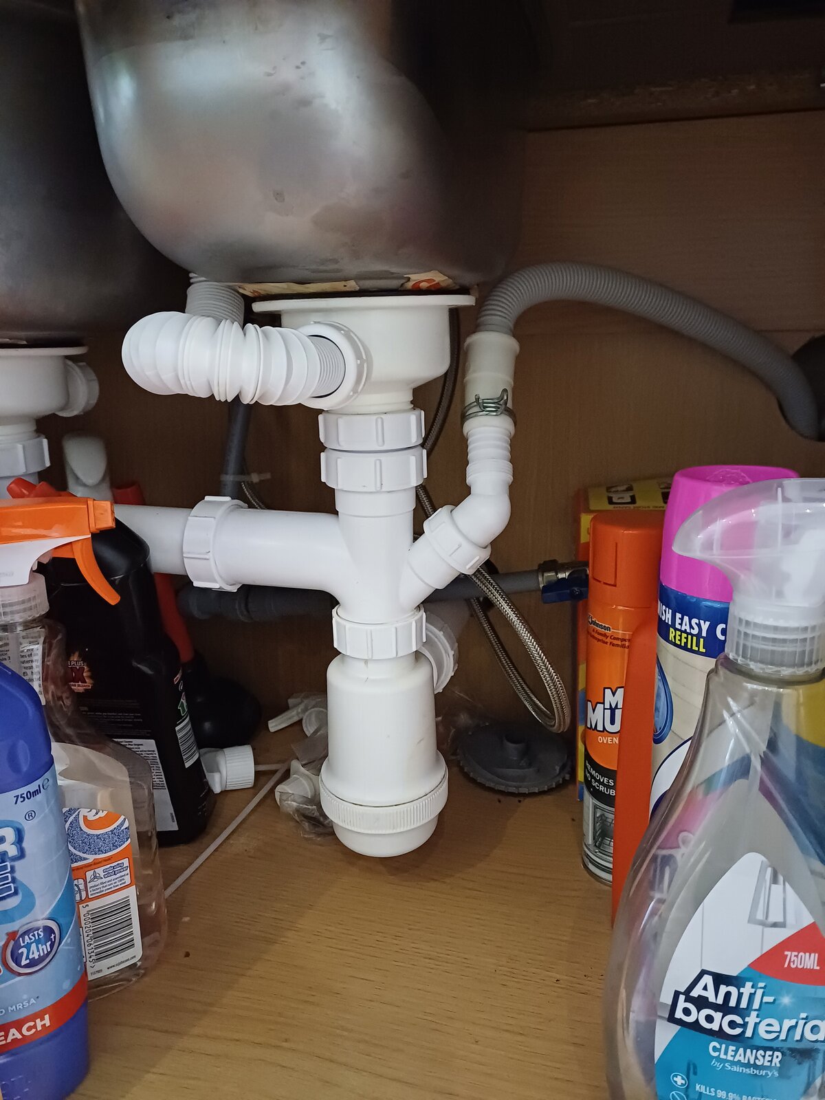

Something like my son's tidier configuration?
The bit of the suggested reconfiguration I'm still unsure about is how to shorten A, B and C and still be able to connect F to D.
I'm not sure either :)
I would shorten A and B, to the minimum you can manage. Fit your new anti-syphon trap on D, leaving D unmodified, Then just replace C with a new piece of pipe, what ever length fits.
You might, by juggling the bits of pipe you have - get away without buying any new pipe.
I don't think there is much to be gained by modifying D, but doing as I suggested, with make for a neater arrangement, and better use of the space in there.
