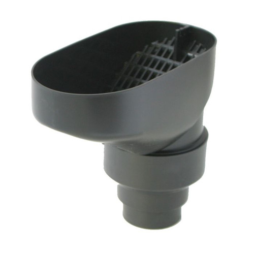

I have seen , but don't know what they are called - devices that go on the downpipes, just above the ground . Open front with a grid angled so debris falls onto the ground and the water passes through.. Found IT Rainus downpipe filter ! (y)
They look like they would do the job , but at around £110 each, I need 14 of them so at £1540, I could get a little man in to clean the guttering so a bit expensive. Thanks for the tip Nige.

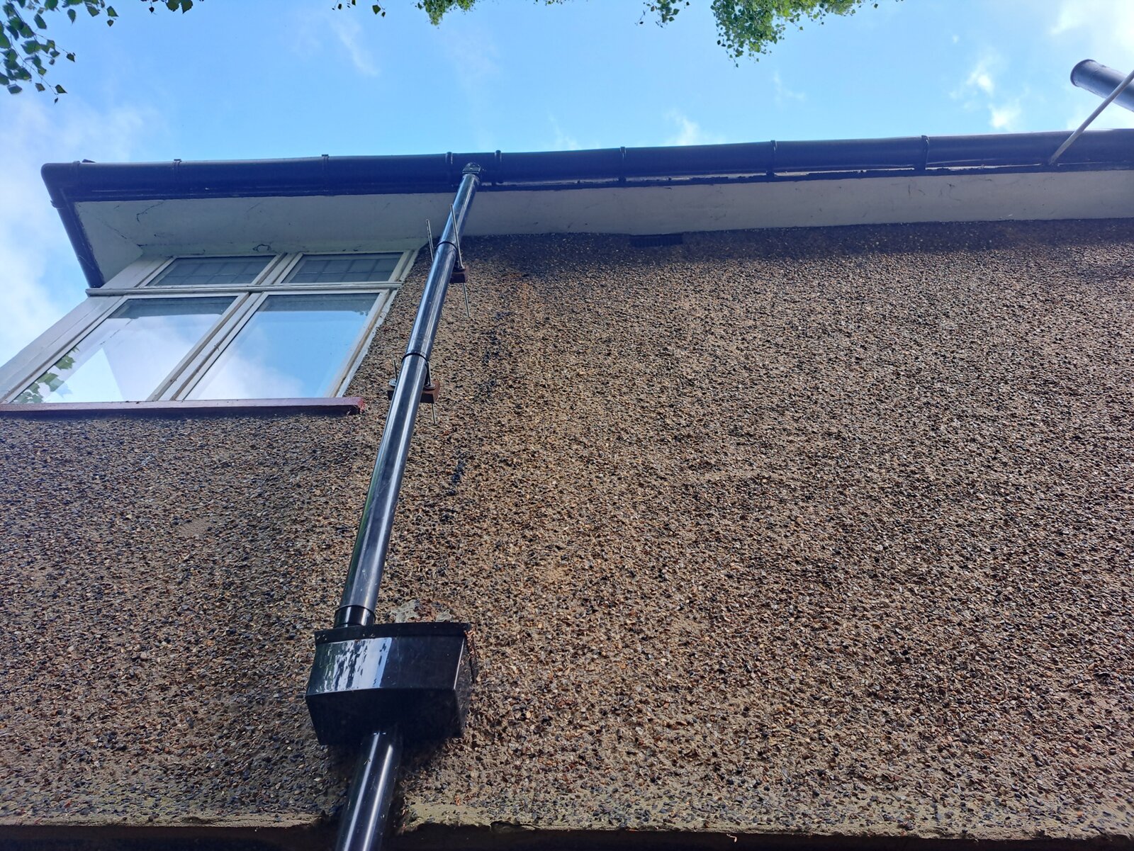

I have lots of mature trees near me (including field maples which have very large leaves) and in one area the offset would clog regularly, causing the gutter to overflow the next time it rained.
I removed the offset and put in a downpipe from the outlet to a hopper. In the bottom of the hopper I put a piece of steel mesh to catch the leaves, etc, that get in there. Obviously the hopper now needs cleaning but it is much lower - so I can use a step ladder rather than an extension ladder - and it brings most of the muck to one place.
Before I removed that offset I looked at adding a leaf catcher and I found they varied greatly in price. I can't find the list of options I looked at but with a quick web search I found
all cheaper than that.

I don't know if it is 18" but my eaves are substantial and I had no problem in taking the downpipe straight down to the hopper, see the photo

The downpipe leaf Guard you identified at around £50 would work if I mounted them just below the gutter
I have never used one but AFAIUI that is not the intention. Rather they are placed lower down , where they can be accessed from the ground.
Partly if the device is throwing leaves etc out then you want this to happen lower down so the leaves are not broadcast too widely. But principally any device like this will need cleaning out now and then and it is much easier if that can be done from the ground.
That is an excellent idea, transfers the problem to much more accessible location. With the home made flushing arrangement already discussed for clearing the pine needles regularly to the collecting receptacle means to whole process becomes less arduous. Great idea. Thanks.
