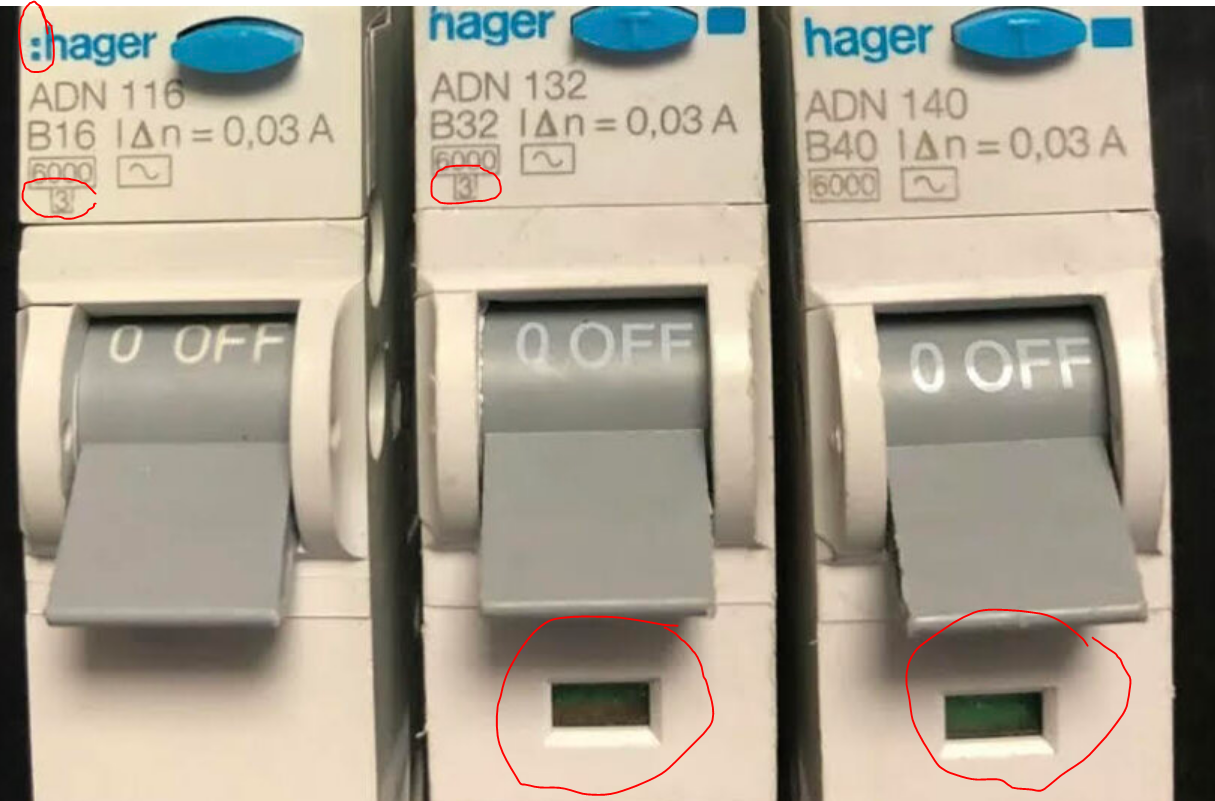

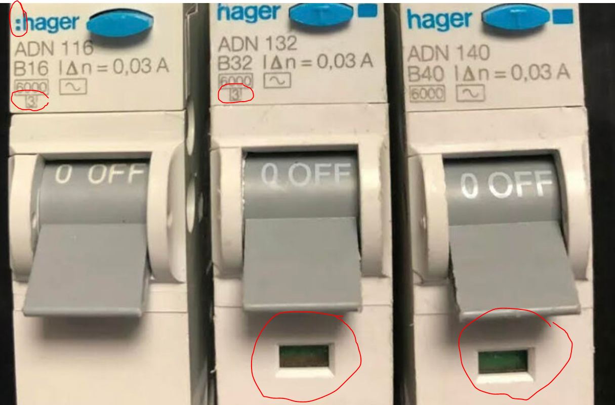

Hager RCBOs - difference?
On my older mk rcds, if you manually turn them off the flag remains white.
And no these aren’t the ones with the mid position
