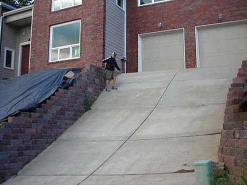

My handbrake, nose up, would hold on that. I would be less confident of it holding, tail up, because rear tyres tend to dig in better, nose up.
No chance in my case, thinking along the lines of a cable from the front towing eye to something immoveable :rolleyes:
