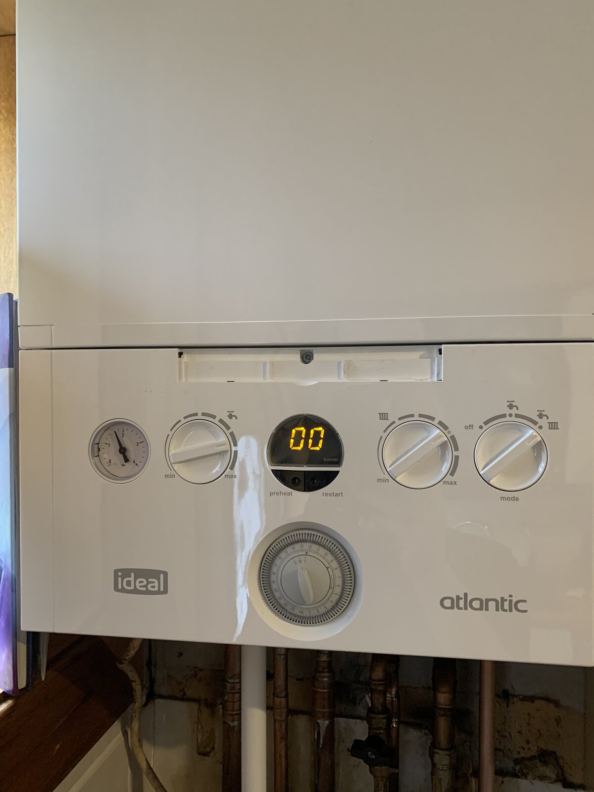

But out also sounds like the installer told a few fibs.Probably isn't 30kw.. you should be able to look up exactly which model you have
Will NOT be a 30 kw boiler. If it says 24, 24 it is.

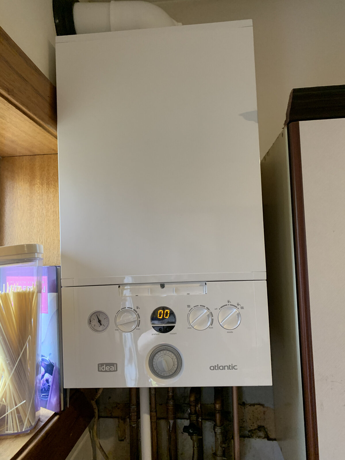

If you give us a few pics of the boiler. It should say what KW rating it is on the front, it will have a 24/30/35 on the flap at the top of the control panel.

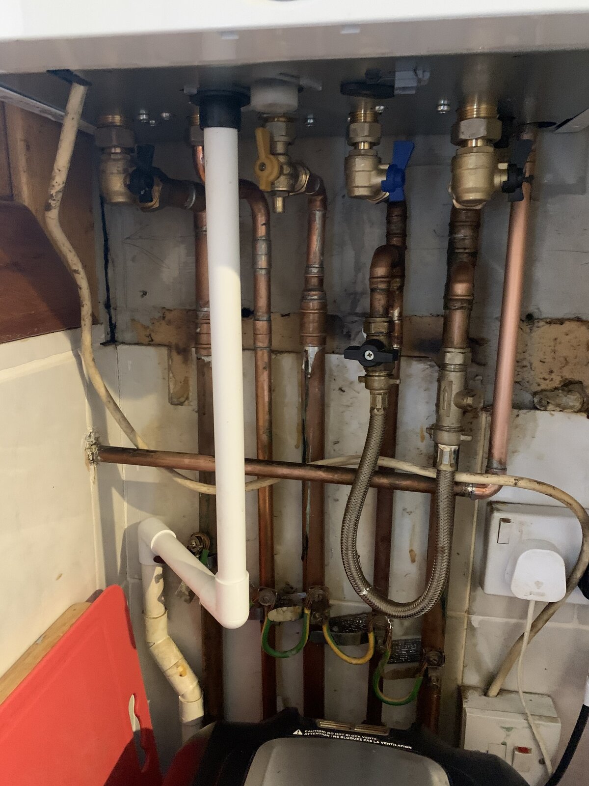

He doesn't get copies of the guarantee, he registers the boiler for the warranty and Ideal send you the warranty confirmation doc. The gas safe cert should be given to you straight away. As suggested check the manual that you should have, there is a section at the back called the benchmark, this needs to be filled in for the warranty to be valid, if it isn't then that needs sorted out. Did he fit a mag filter too?
Had a look at the manual when he put the Boiler in. Definitely a 24. I’m sure I went through the manual but didn’t see anything filled in though I will check it again. No idea if a mag filter was fitted. Could that be done after if needed ?

Post a pic of the boiler and pipework.
A mag filter being installed is a pre requisite of the warranty, and extended warranty usually require the manufacturers own filter to be installed.
Here’s a couple of pics of the Boiler.
