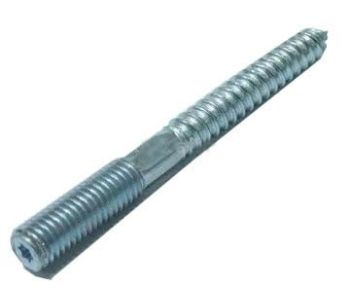

The example in my OP:
take (looks like) a Torx bit, so if I left the machine screw end I'd not need locknuts/mole wrench/pipe grips/stillsons....
try googling (other search engines are available) part threaded rod.
You don't with those threaded dowels anyway. You tighten two nuts against each other on the machine thread. Then turn the 'front' nut to drive it in, turn the 'rear' nut to extract.
would be too long.
How much do you want sticking out then? Would using threaded dowels and then put a threaded sleeve nut on just finger tight to make it look prettier be any good?
Indeed.
That might work very well indeed - probably 10-20mm protruding.

Have "floating" shelves in an alcove.
I'll try to clarify my position.
I already have these shelves, but they are going to be moved to a narrower alcove. They are actually supported now on regular woodscrews left protruding from the walls and with the heads filed flat on the undersides so they don't stick out below the bottoms of the shelves. But it's always annoyed me that this was a bit of a make-do-and-mend bodge rather than a "proper" fixing.

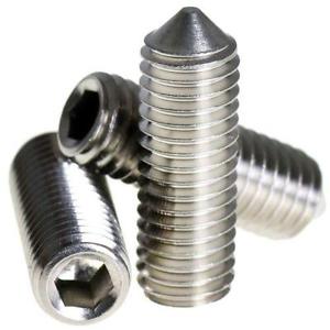

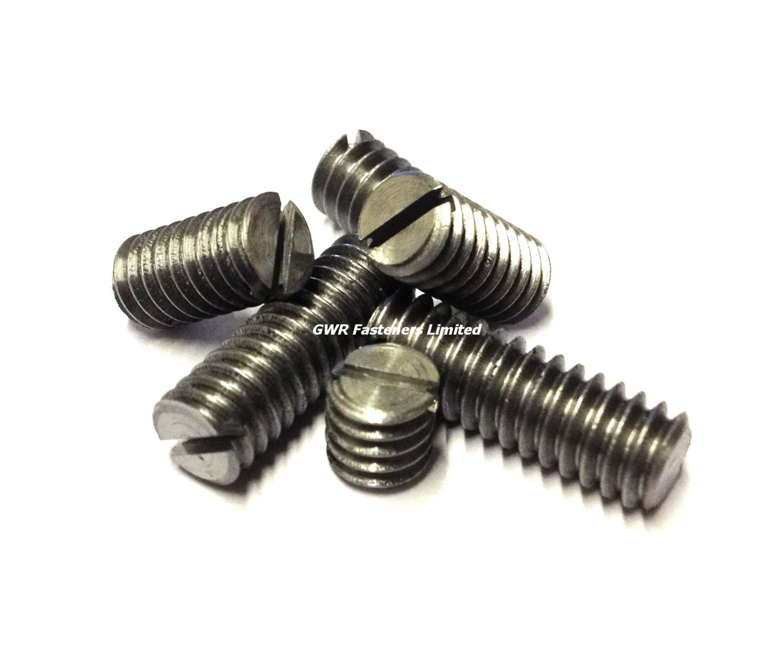

Self tapping grub screw. Pilot hole required.
