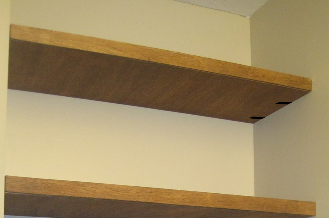

Yup, supported on somethings screwed into the wall, with short amounts protruding, shelves grooved like this:
so the supports are "flush".

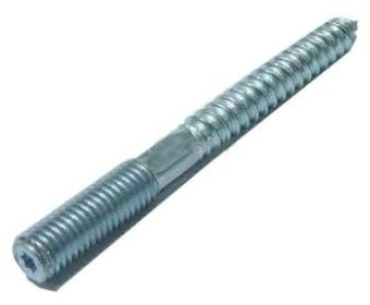

I'm not after the method of support being totally invisible, just unobtrusive, but because they do show a little I wanted something a little less of a hack than a woodscrew with the head filed flat on one side.
What I wanted was something like this:
with a smooth shank instead of the machine screw end.

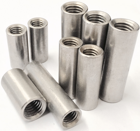

But I think that something like that with these over the machine screw
will work just fine.

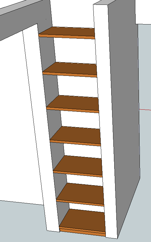

Why not just have a rail fixed on the back wall and cheeks then route in a rebate around sides then?
Now knowing what you wanted I'd have had it done in the time spent searching for the right screw.

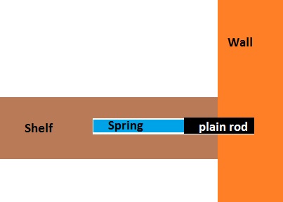

Completely secret fixing
Shelf can only be removed if the rod can be pulled back into the shelf by a string magnet
