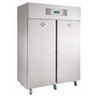

Appliances that produce heat
Big two door fridge and two door freezer
If these are big "foster" type units like:
then these do produce a LOT of heat, and if this heat is not given any means of escape it will just build up in the room. Your chimney fan will only be running when the cooker runs and is primarily for the removal of grease and moisture.
You need some "trickle" ventilation, ideally on a thermostat, so that the fans run when the temperature rises above, say, 23 degrees and cuts out at 21. Two fans, one either end of the room, one sucking, one blowing (on the same stat so they run together).
