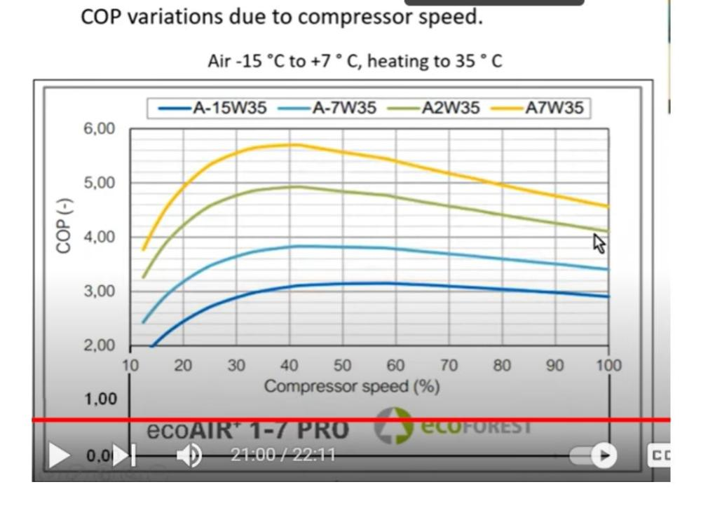

I have just been reading something which, if I have understood it, may contradict part of the Heat Geek presentation.
Heat Geek says:
One more variable to add to this, is that the compressor is most efficient at maximum output. When the compressor speed slows, it actually drops in efficiency.
There are two ways we can ensure this sits at the maximum output as much as possible.
But this thread appears to say the opposite and includes the chart below. Can anyone clarify?
That's extremely useful, and adds to my conclusion that the only way is to get the stuff installed and actually try it. With your own system in your own building.
