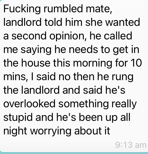

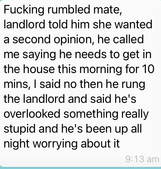

Sorted apparently. It was turned up too high. Just had this from my son.
