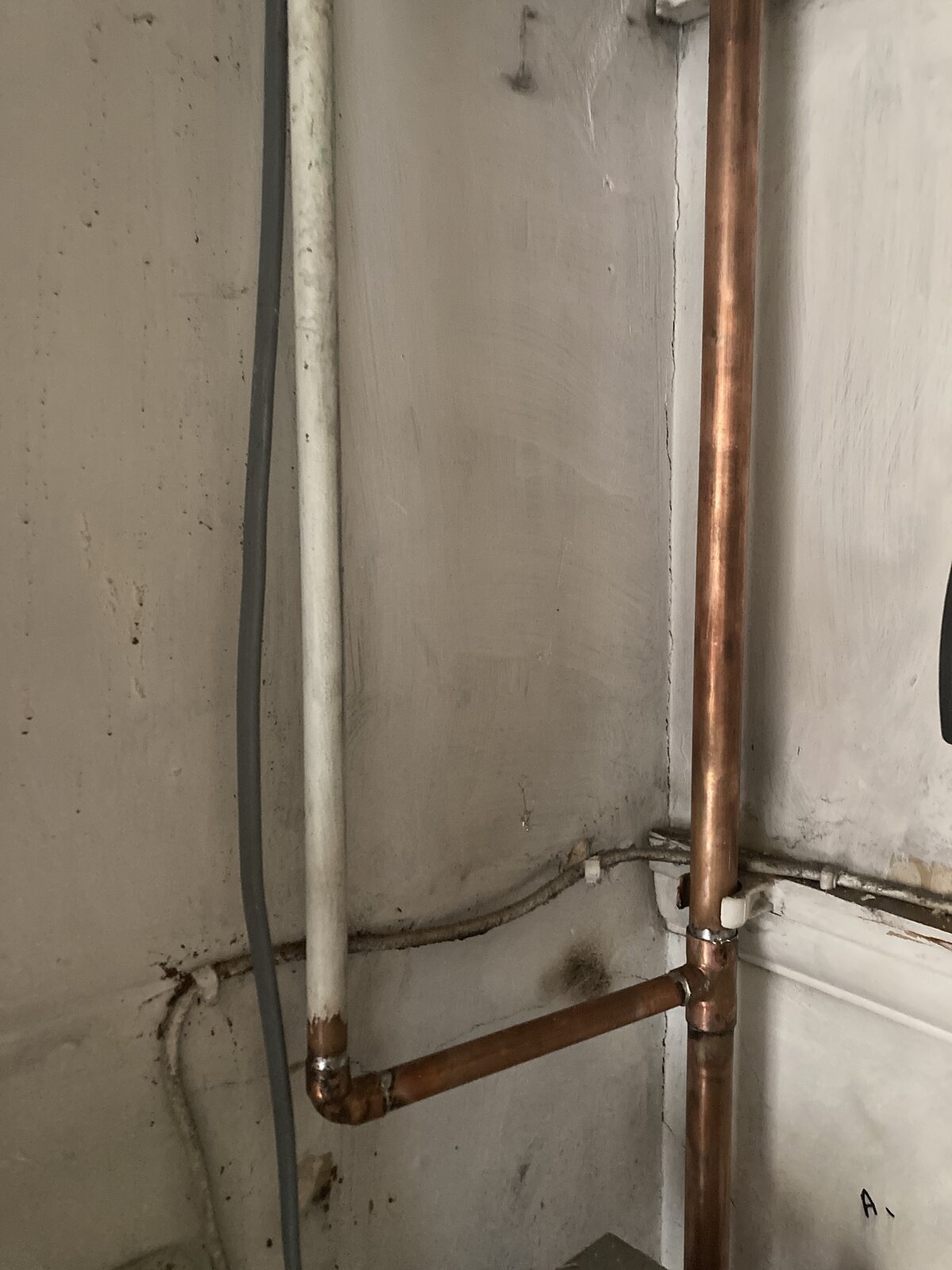

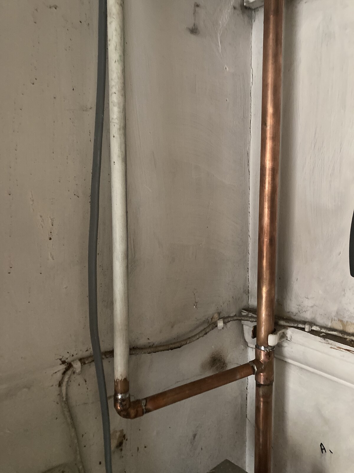

It looks like it's plumbed incorrectly...and the feed and vent should be within 150mm to reduce the pressure drop between the 2 connections.
Get that right for starters...

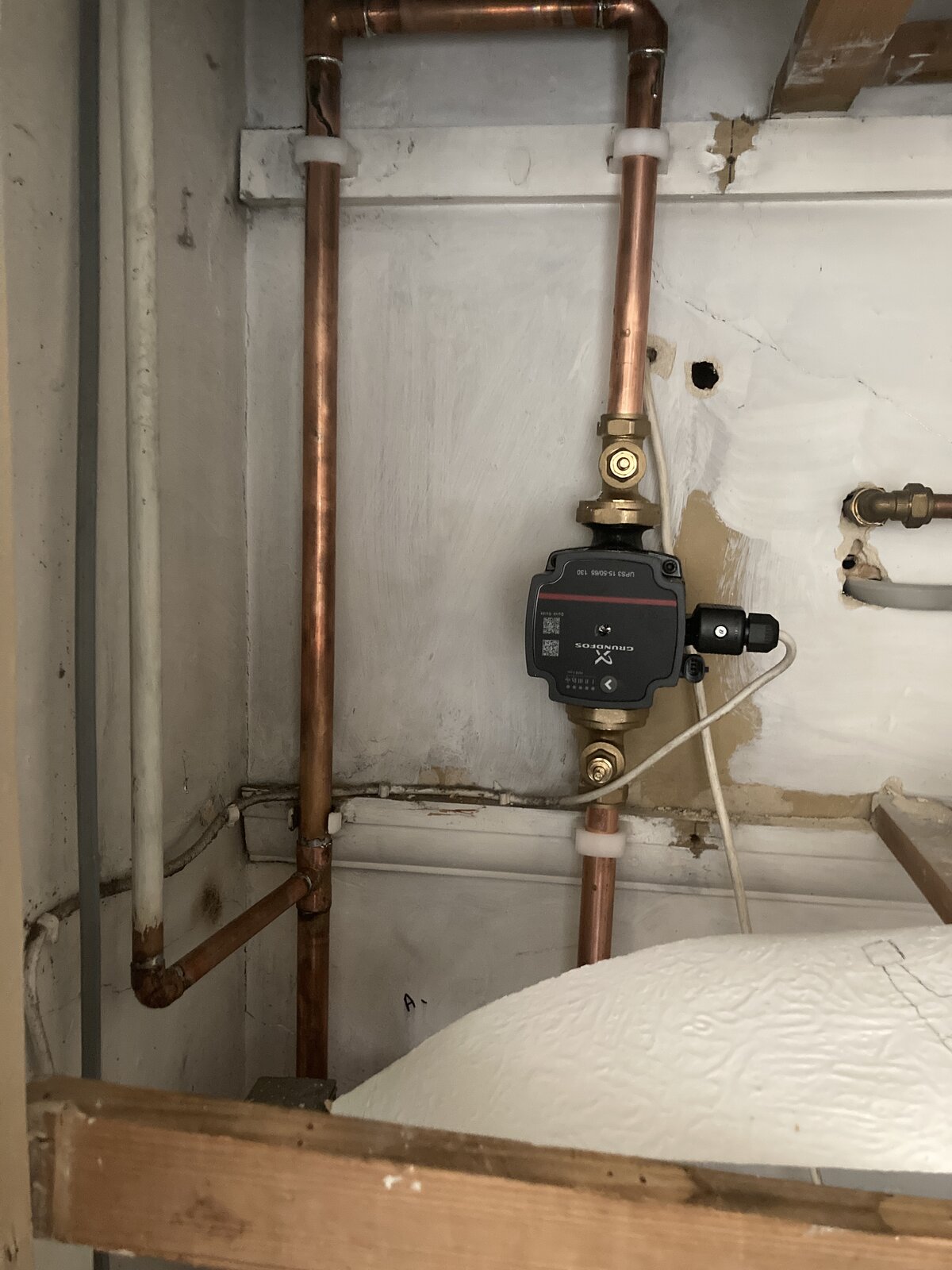

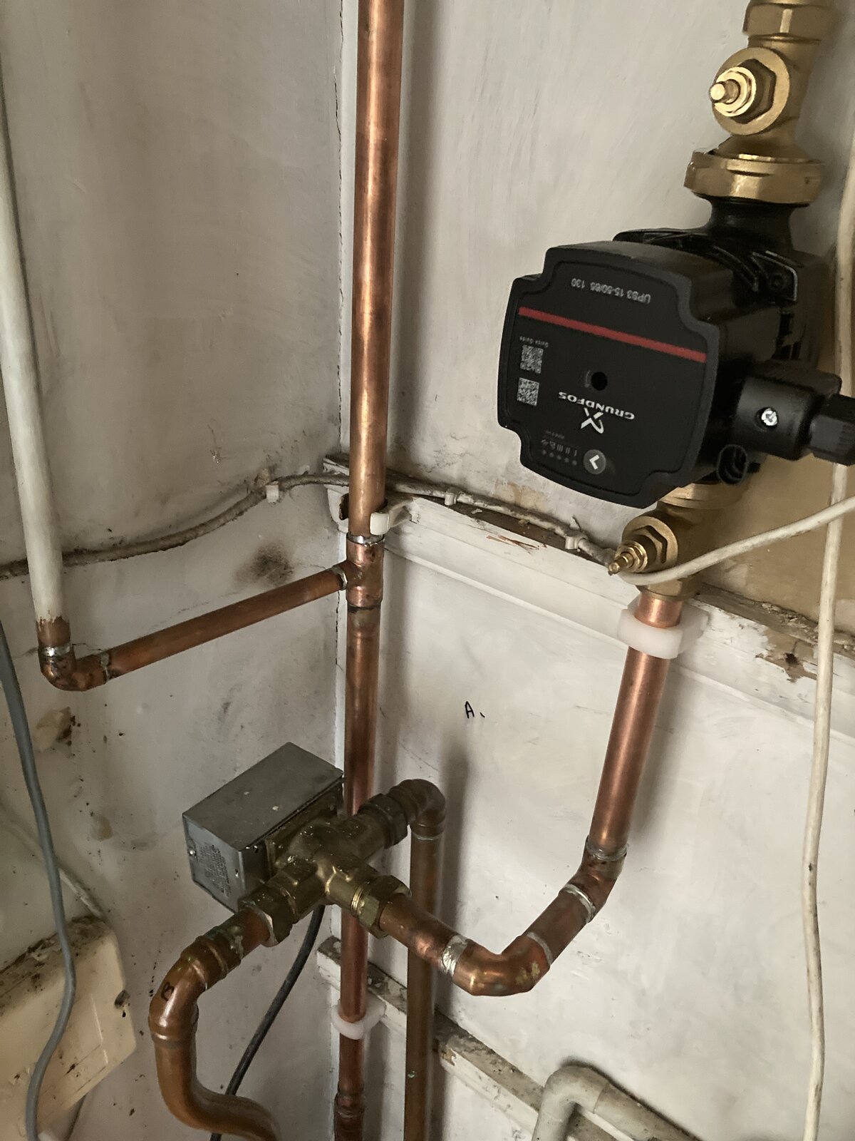

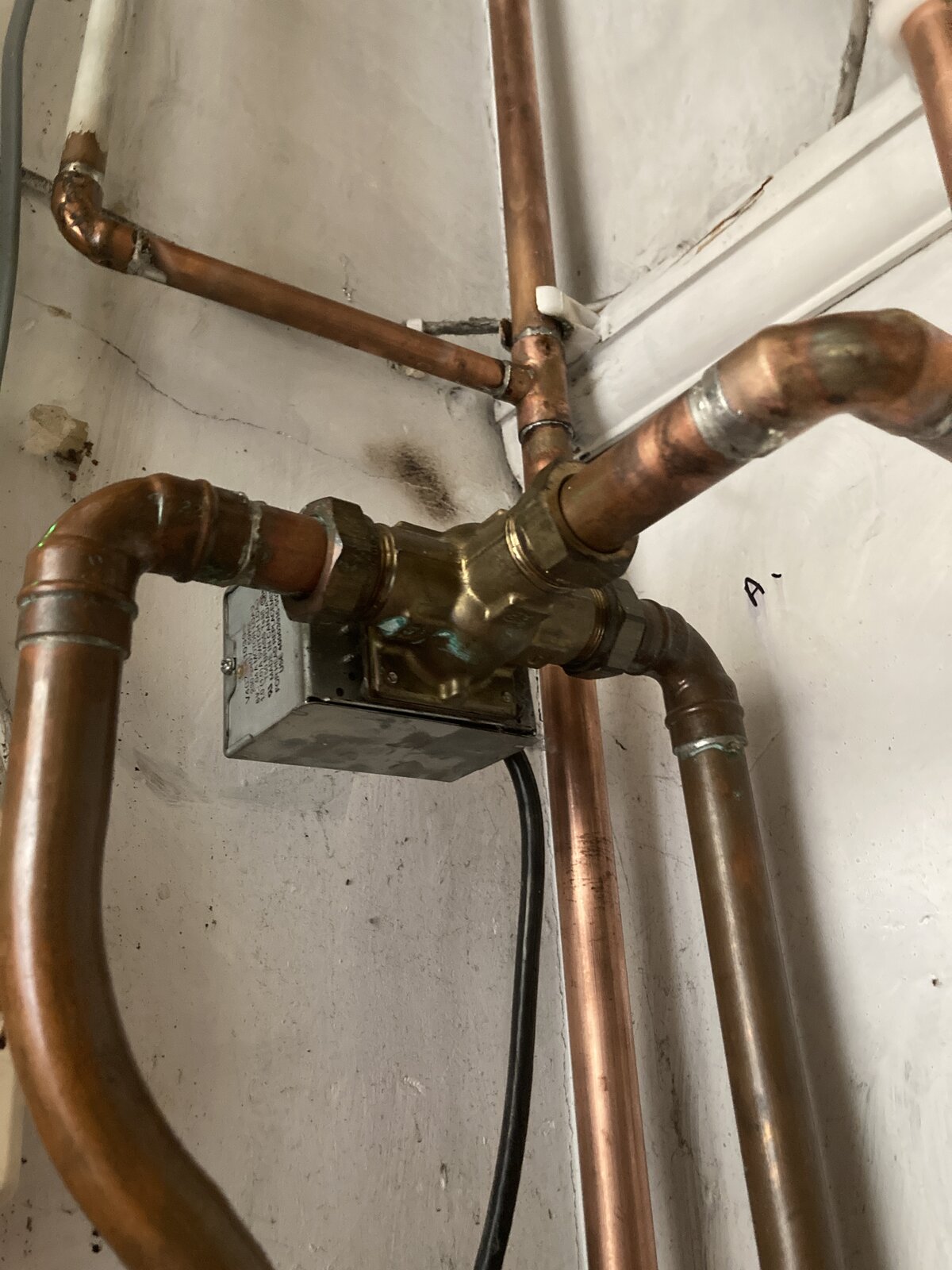

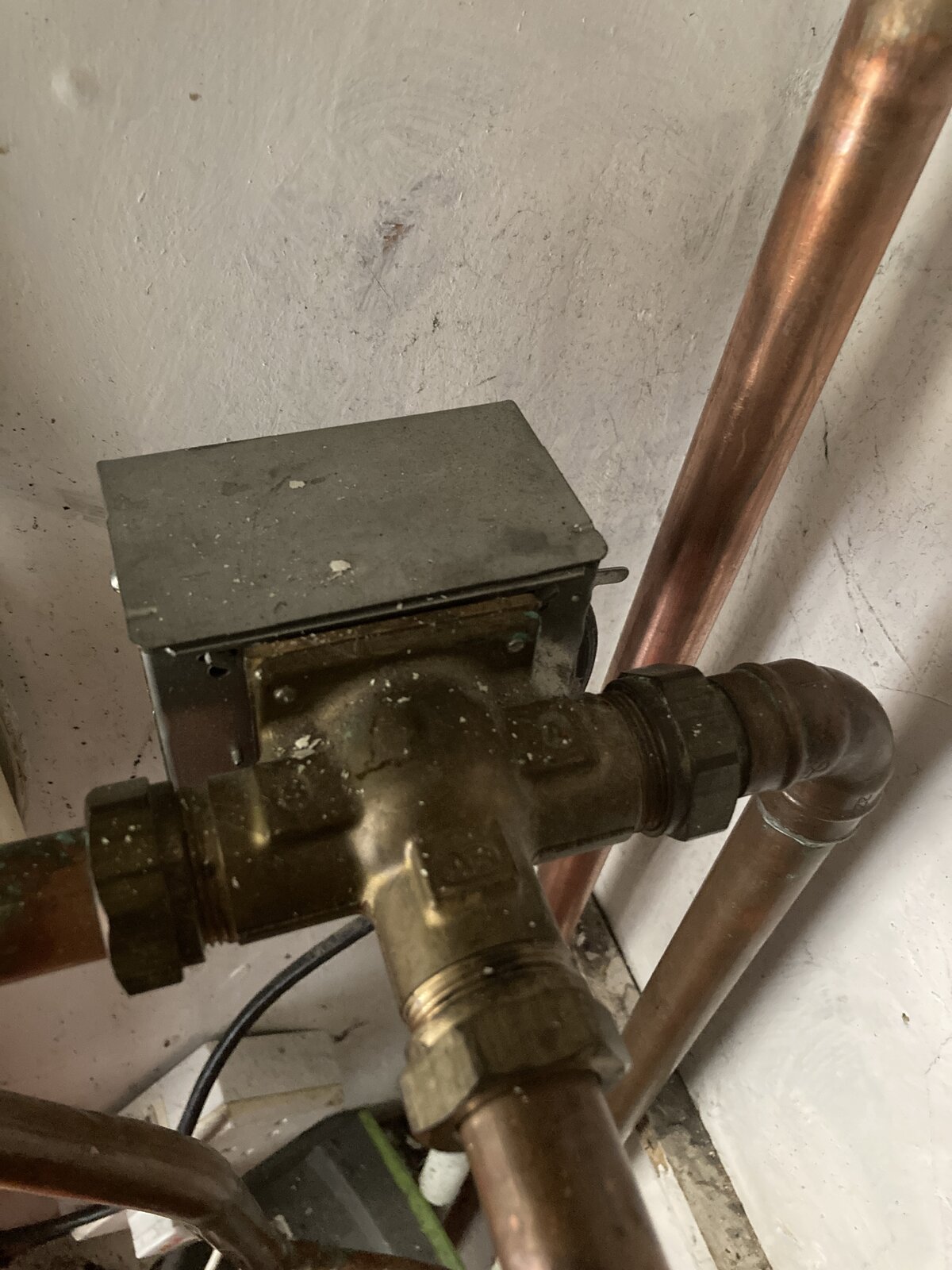

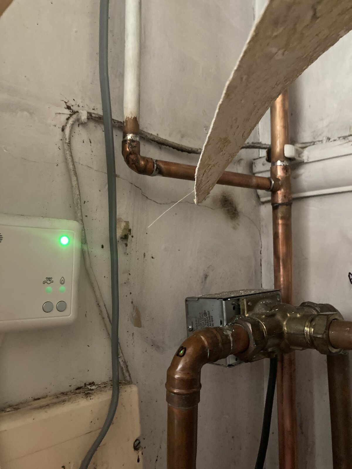

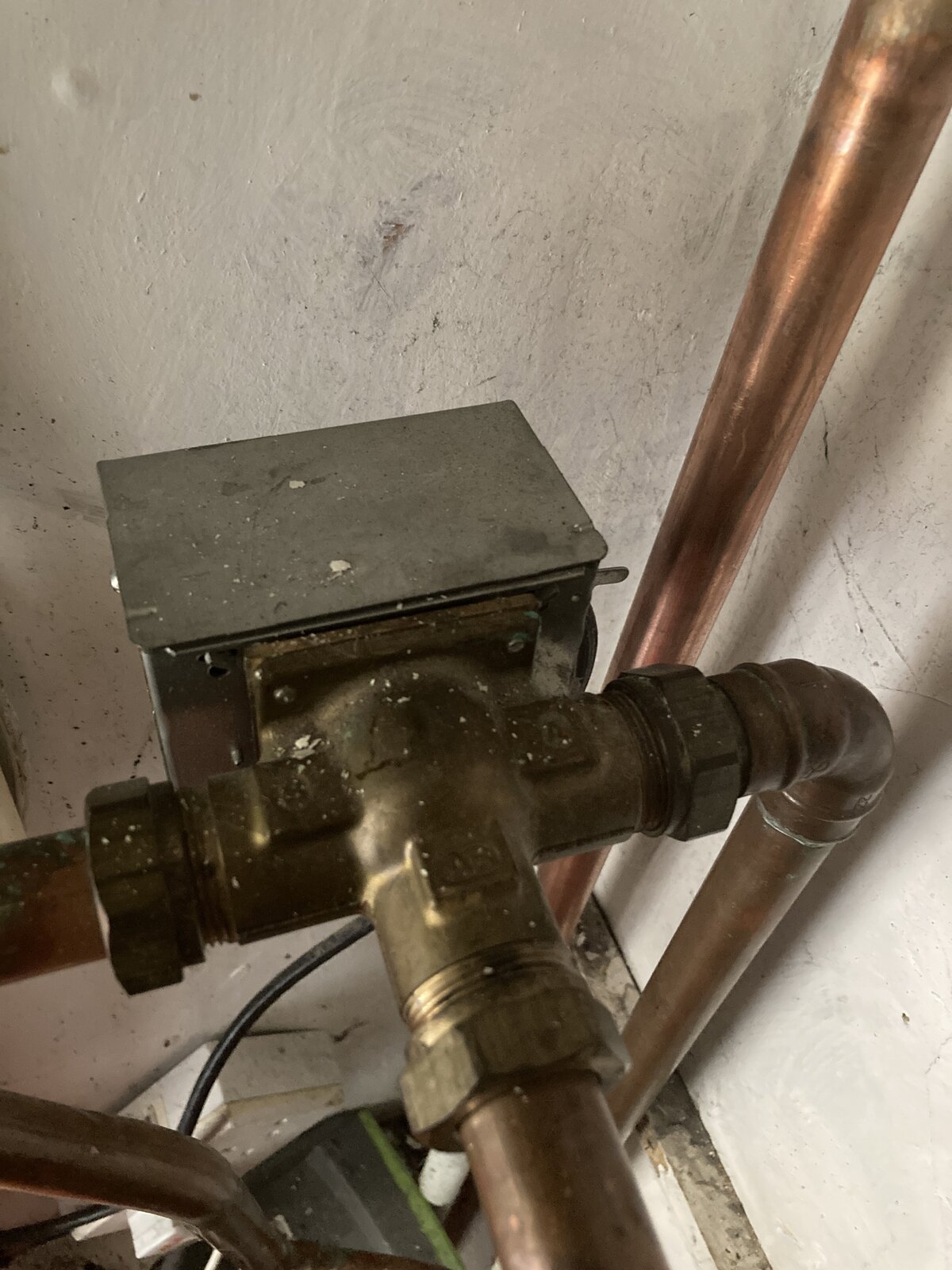

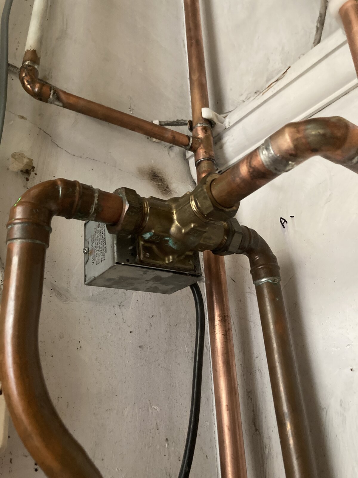

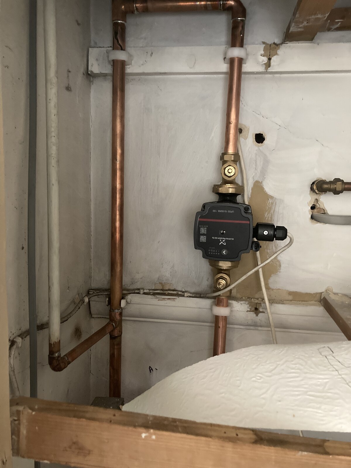

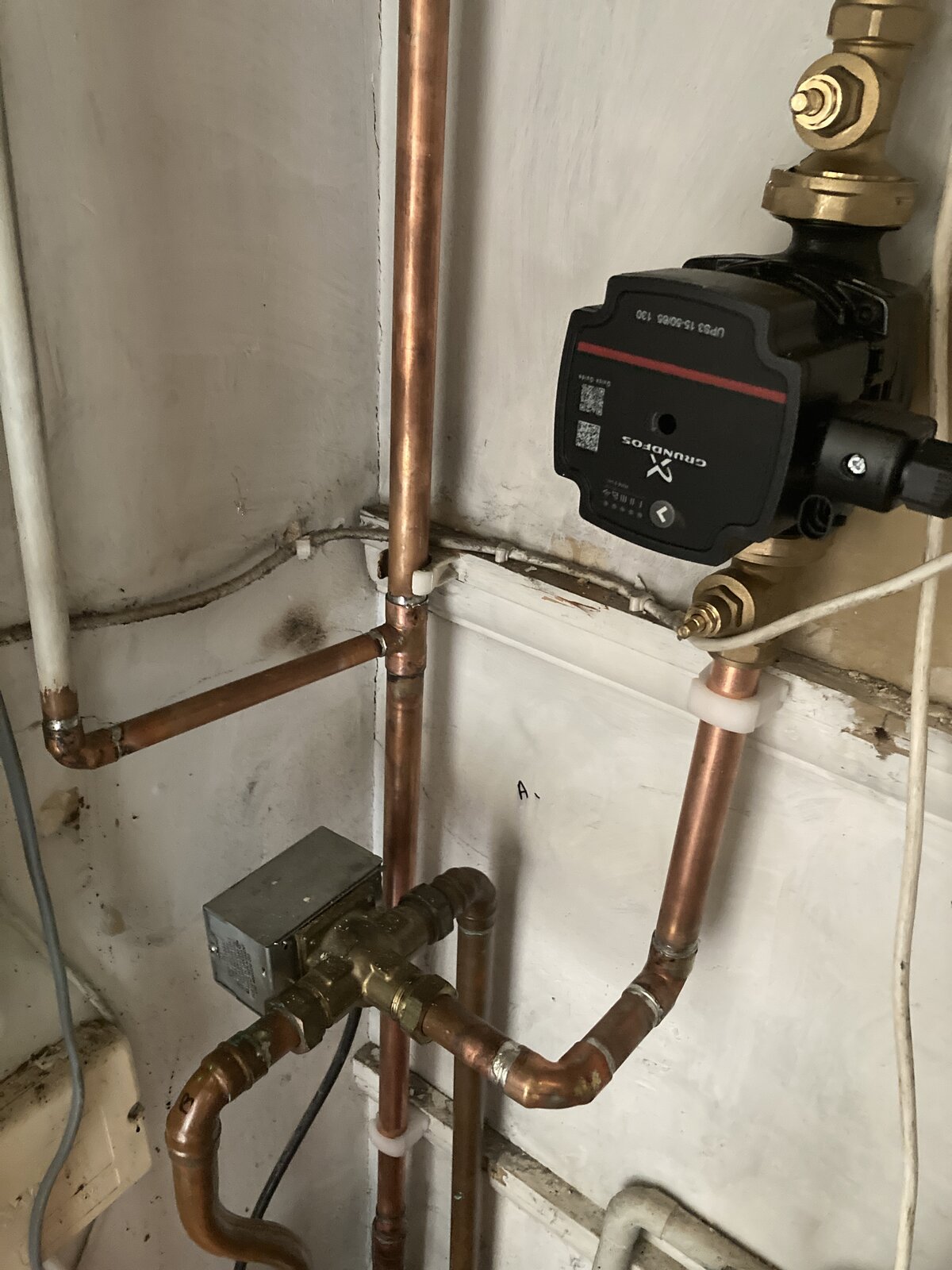

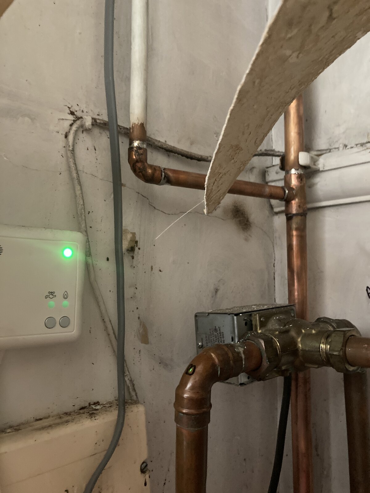

Well, I’ve just had a look when I took my grandson back. The 'plumber' has been round, fitted a new pump and some sections of pipe near to the pump and......no effing difference! It runs for a short while before water starts coming out of the loft ceiling. The 15mm painted pipe going up to the loft gets too hot to touch. He’s coming back on Saturday to powerflush it. Doesn’t seem right to me. It’s a Worcester boiler they have fitted with a mag filter. One thing that seems odd to me is that although all pipes going in to the three way valve are cold, the valve electrical bit is quite warm. Also the little lever you use when filling/bleeding the system doesn’t seem to be connected to anything, it’s just flopping loose. Any idea's? A few pictures:
View attachment 232740 View attachment 232741 View attachment 232742 View attachment 232743 View attachment 232744 View attachment 232745
Just to be clear - are those photos how it's always been, or after changes have been made to try to correct the current problem?
According to my son, the pipes have always been like that but the bloke said they were blocked and it was easier to replace them than unblock them.
OK thanks, so you mean he didn't change the layout, just replaced some pipes to get rid of the blocked sections?

The whole point of the close coupled feed and vent connections is to keep the pressure drop between the 2 pipes near to zero. With both pipes at the same pressure pumping over is eliminated.
Where there are issues with pumping over in these configurations it's generally due to a restriction/blockage in the short pipe section between the feed & vent.
Of course to keep installation costs low the pipes can be brought together so close that they effectively become a single pipe...what's known asl the combined feed and vent.
It's often used in low head systems but air elimination can be slow.
I wonder where the water is coming from? If the F&E is full, the float valve must be shut. Pumping over would not last long. Is the boiler boiling? Or the immersion heater? A thermometer would tell you. Check the tapwater temperature. Tie up the float for a bit and the supply of water to leak out should stop.
Or is water entering somehow? Perforated coil, maybe? What colour is the HW cylinder? And how high is the cold-water tank in relation to the F&E tank?
yous son doesnt have a Gravity Hot water system, he has an open vent system, they are not the same, the pipes are 22mm, you can not turn a boiler up too high and cause it to pump over like that if the system is fitted correctly
Thanks, I know Ian. What I meant was that the pipes in the upstairs airing cupboard and the downstairs boiler cupboard are 22mm. The pipes in between are 28mm at least, where it used to be a gravity hot water system at some time in the past. Also, I do suspect the system is not fitted correctly.
