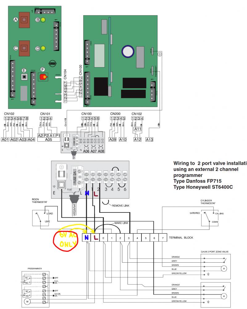

Hi, I am new on here and hope someone can help.
I have the Ariston microsystem 21 boiler and it supposed be support 240v AC to the junction which connected to water tank, 2 pumps and timer as attached diagram but it supported only 6v AC somehow.
The honeywell ST6400C wasn't display anything because rack of power I think.
Shall I change the PCBs? It has 2 PCBs, one has LEDs with switches and the other one has many small parts on it.
Pleeease kindly check the electrical diagram which I attached and tell me what shall I do.
Many Thanks!!

I could be wrong, but I think the 230V is supposed to feed the pcb, the pcb does not provide the required 230V to feed the boiler.
Apart from that, if you find 6V somewhere, your earth is probably not 100% either.

Thanks for your reply.
Yes, the 230v is supposed to feed the pcb and coming out from pcb and supposed to feed the terminal block which connected to others. The pumps and timer needs 230v but the power should be supplied by boiler (actually from pcb's external terminal, N and 1) as shown in the electrical diagram. I couldn't find any other power input to terminal block except from boiler.
I though something wrong with one or both of pcbs and supplied only 6v instead of 230v at external output terminal as I marked on a diagram.
Oh, I checked my earth many times by the way.
Actually, I changed one of pcb which has LEDs and switches but same.
Shall I change another one(999498, CBM2 AT-MI2X)?
It is such pain especailly in cold weather, help!!
Jack
the mains supply to the boiler is via a flex to the left of the The terminals he has highlighted
terminal one is indeed a live feed from the boiler to external controls

there are two to check one in the spur and a 2 amp one one the conections board
jack you dont say if you have any power to the boiler
is the mains and central heating led on?
if so also check system pressure is not low as there is a pressure switch connected in series with terminal 1
Matt

I checked system pressure and I found it was low!
Once put some water in order to make the pressure higher and... it WORKS now!!!
Such simple check point but it was greatest Christmas gift for me, Matt!!
Thank you so much once again and I wish you merry Christmas!!
