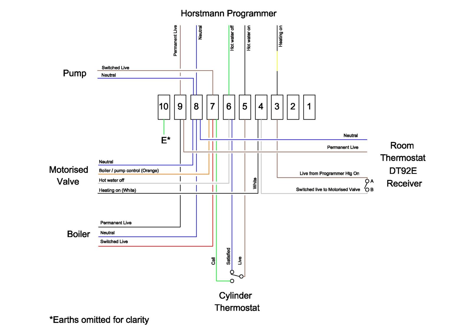

Can I be really cheeky and ask if you could provide a revised wiring diagram showing the permanent 230V supply for the receiver, I followed you advice and used terminal (9) second from the left as the permanent live, and terminal (8) third from the left as the neutral.
Having a full diagram with all the correct wiring colours will be a great help in the future.

stem thanks a bunch. Terminals 3 & 4 are currently as per your original (brown & grey). Unfortunately the cable to the receiver was only 3 core (black/brown/grey) and earth so although not right in order to get it working I used the earth cable for the live (which I have sleved brown) and black for the neutral.
I am going to get my grandson to change the cable so if you could show the colours as you would expect, that would be ideal. I assume it should be a four core plus earth cable so he would use brown live & blue neutral for the 230V supply with grey and black for the receiver switched connections. If I am not right please correct as you feel fit.
Personally I would have left the original thermostat A & B cable for terminals 3 & 4 as it was, and installed a new supply cable with Brown / Blue wires for the new L & N. So, as per your previous post, that's what I have shown. I can change it if required.
You did well to get 5 neutrals in terminal 8. I thought you might have to use vacant terminals 1 or 2 as an additional neutral terminal.

Thanks stem that's great, only suggested changing the thermostat A & B cable for terminals 3 & 4 if my grandson fits a new cable to keep things tidy.
It may be awhile before I get him over but hopefully you will still have the plan if I need to make any changes. Incidentally, which software are you using?

I did it using AutoCAD and then converted it to jpg for posting on here. If you want me to email it to you, I can send it tomorrow, in AutoCAD, PDF or jpeg. If you do, just private message me with your email address.
