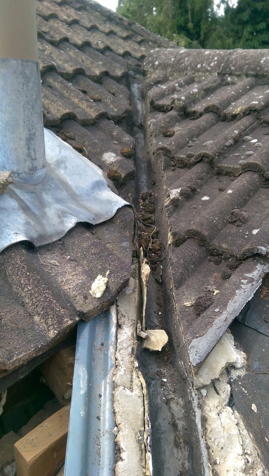

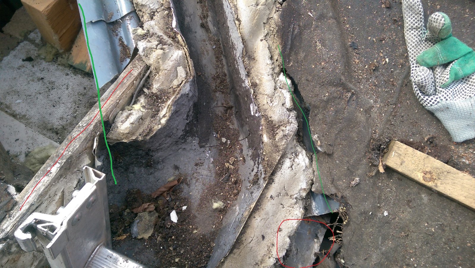

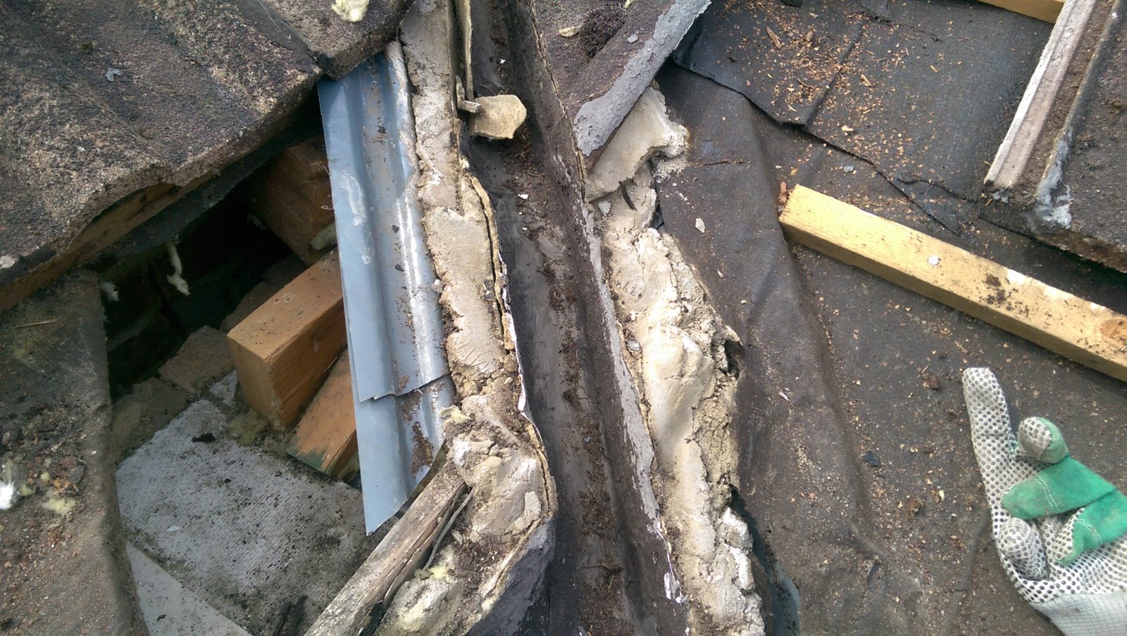

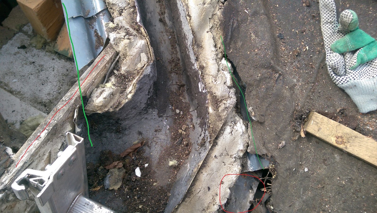

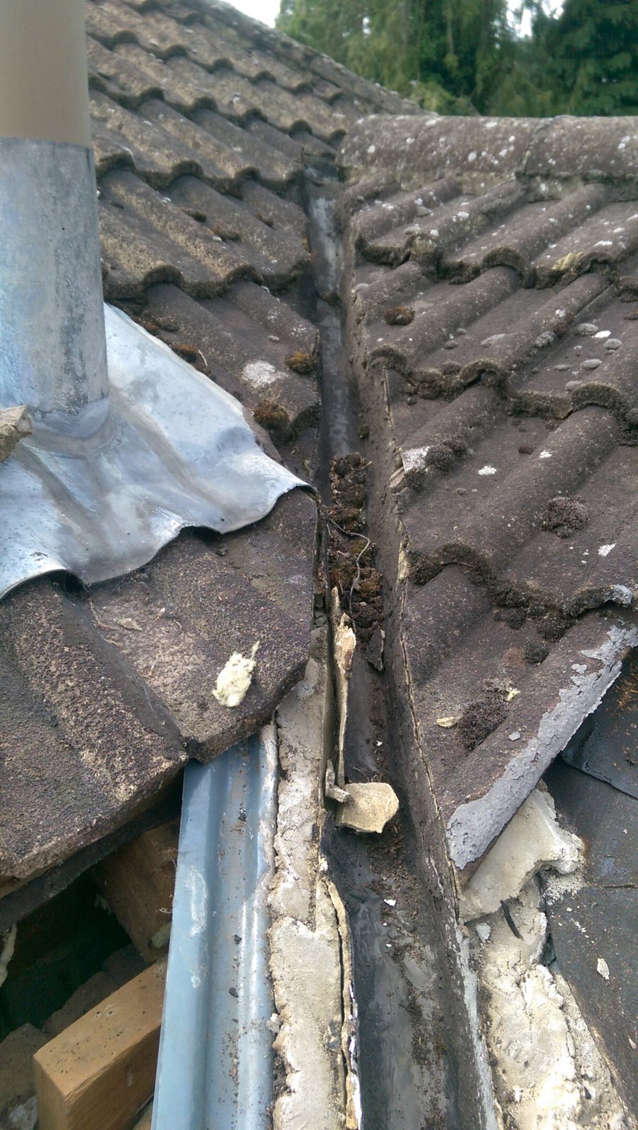

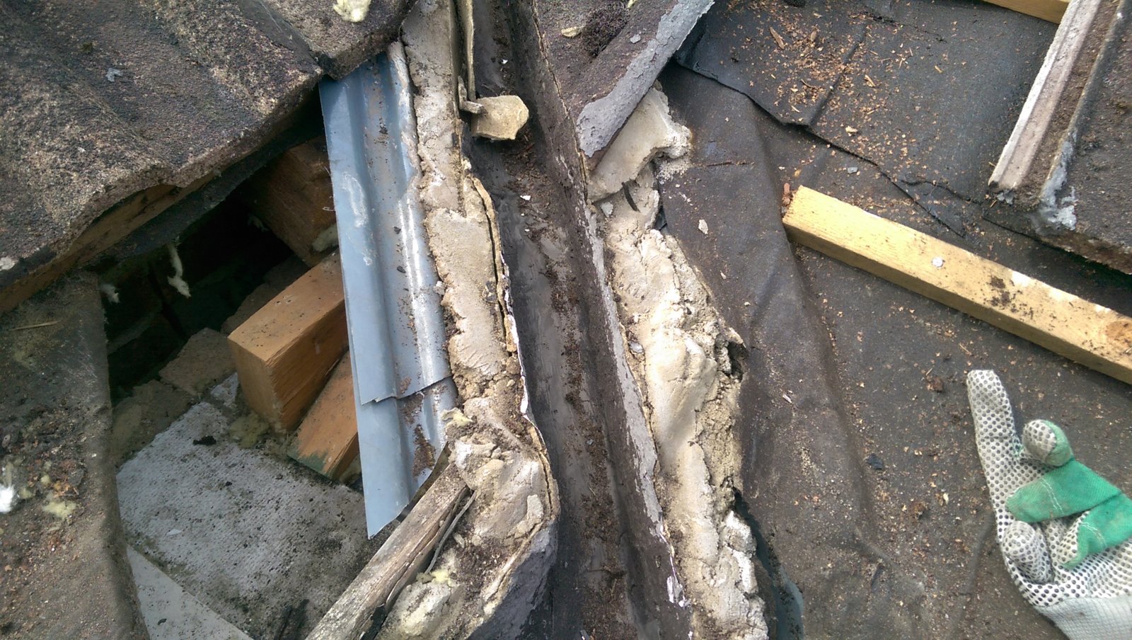

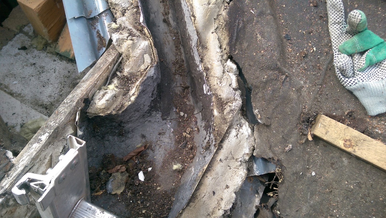

So we have a leak at the bottom of the roof valley - water drips onto the soffit and then internally.
I've taken off some of the tiles today and posted two pics: One an overview and the other a more detailed picture.
I think I can see that it is leaking because the roof valley on the left has been cut short and there is no way water can escape outside. What I obvisouly don't know if how to fix this! And should I worry about all the motar in valley itself?
Thanks a lot in advance for any advice!

from what i can understand from the photos you might be best advised to strip the valley on both sides and lift outthe valley trough materials. you might even have to strip backinto the roof plane of tiles on either side to pick up the underfelt.
the bottom of the valley looks shaky but leaks could be entering higher up the valley an presentin at the bottom.
best to start early in the morning with two of you an a tiedin ladder that wont get in your way as it projects 3 rungs above the gutter.
when its stripped off post photos on here. if youve got doubts about workin up there then give the job to a roofer.

Under lay isn't the cause of the leak and should not be relied on to keep you dry.
The bottom of the valley is incorrect. The first course of tiles to the right should be cut into fascia on left. A big lead saddle then fitted and dressed to shape. allowing for the GRP to over lap . all side edges turned up to prevent water running off the sides.
Clearly the inadequate lead currently fitted has no turn ups and is too small anyway.
Judging from the lash up you have I would expect no lead saddle to have been fitted below the ridge either.
Easiest option is strip the mess out and start again.

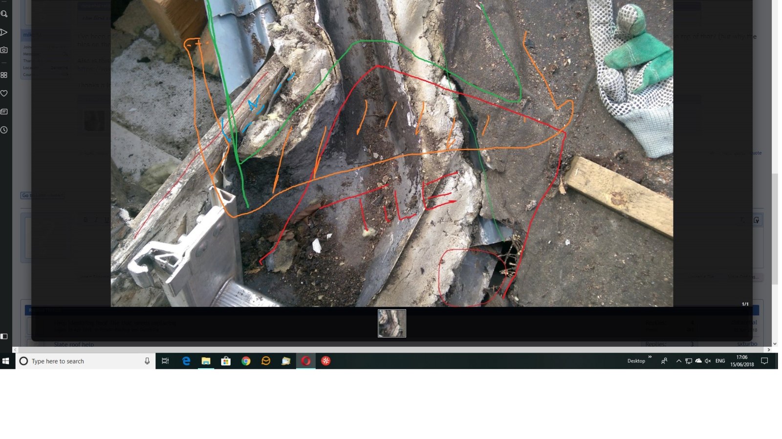

I've been running that through my head over and over and still can't get my head around it. Does it mean there should be a notch cut in the left facia and the valley allowed to run over it with tiles on top of that? (but why the tiles on the right?) I've attached pic again with thick green line on left showing what I think you might mean?

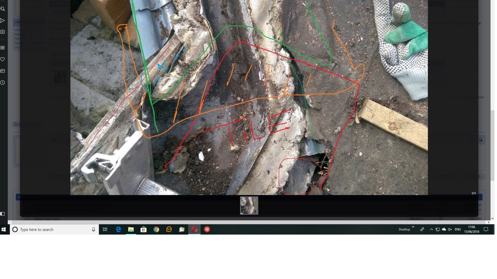

Red line + tile
Green = GRP valley where it should be
Orange =Lead works
Blue = fascia notch
Valley runs over the lead saddle which is dressed over the first tile on the right
It's a common detail which if you look around you may see replicated.. yours is a lash up..

Thank you so much for that!!! That is pretty clear and also pretty clear the original "builders" didn't do it properly at all. Will get it fixed a bit later in the summer.

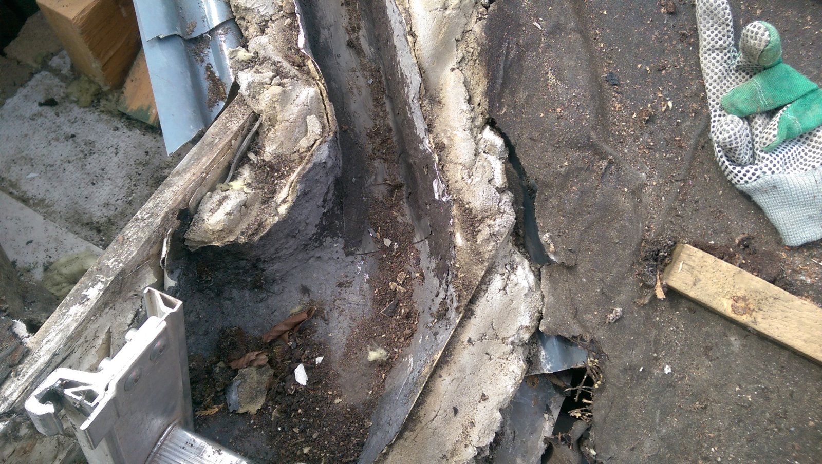

Just revisiting this. I don't think the pictures I uploaded showed that the valley discharges into a gutter. Does that mean I don't need the lead apron at the bottom?
I worked that out from your pictures.
You shouldn't need a saddle under the first RH tile
You need a saddle over the top of the first tile (RHS) and under under the GRP and First tile (LHS) turn edges of saddle up to prevent water running off sideways
If you are careful and don't scrimp on the saddle size it can be dressed to weather where the first RH tile butts the LH fascia

By saddle (goes over the ridge etc) I'm guessing you mean soaker. This is how we would do it too.
I'm planning to get this done in the next couple of weeks. At risk of being shot down for ignoring advice, I'm planning to redo just the bottom part of the valley - at least for now. The reasons are I'm now 100% sure the leak is due to water running down the valley on the left hand side then simply falls out of the valley just before it hits the facia board. Also it would be an easier job than the whole lot especially since its the first time I've done anything to a valley.
The two main things I still don't understand are:
1/ Trying to figure out what the existing grp valley is so I can get something close for the bottom of the valley. It measures about 360mm wideand the tiles are redland. Maybe I can use any grp valley so long as it is the same or wider width? The redland 125 is 400mm wide for example, maybe I could use that? Danelaw would be easier for me to get though.
2/ Having read so much from the manufacturer websites I still can't get it into my fick skull why I need a lead saddle at the bottom? I mean if the facia is notched, and the grp valley flows over it into the gutter what is the saddle for? Its not that I'm trying to save pennies but I just still not clear where to put it if its mandatory.
