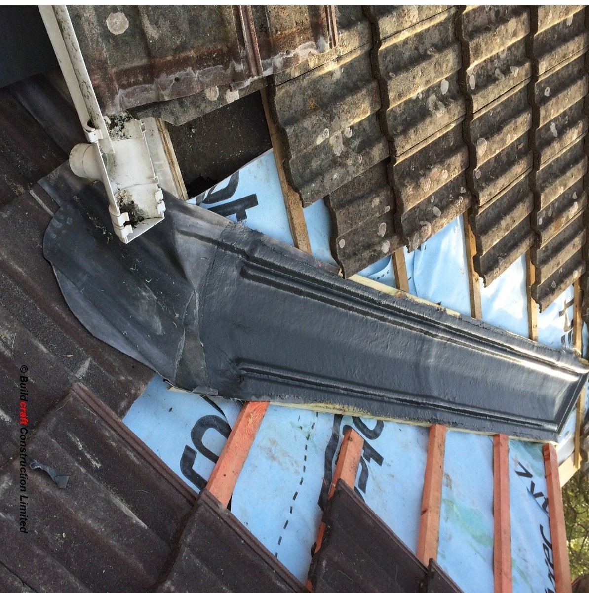

It seems that what may be required may be something like this. (Why it came out sideways I do not know.) At least there is one thing that I have learned from reading this post,l the meaning of "GRP valley troughs"
OP, get out of here.
your still sayin whats what, proposin your notions, instead of listening to very simple advice given by me an another - strip it an it will be obvious what to do next.
youve wasted weeks with maybe a hole in your roof an no further ahead.
same idea , but this is not preformed grp valley trough. lead arrangement is what you need but just extend your grp to hang in the gutter , the lead will take care of the the side.
The pictured isn't without its invulnerability as it appears on edge of the lead has not been turned up enough in my opinion.

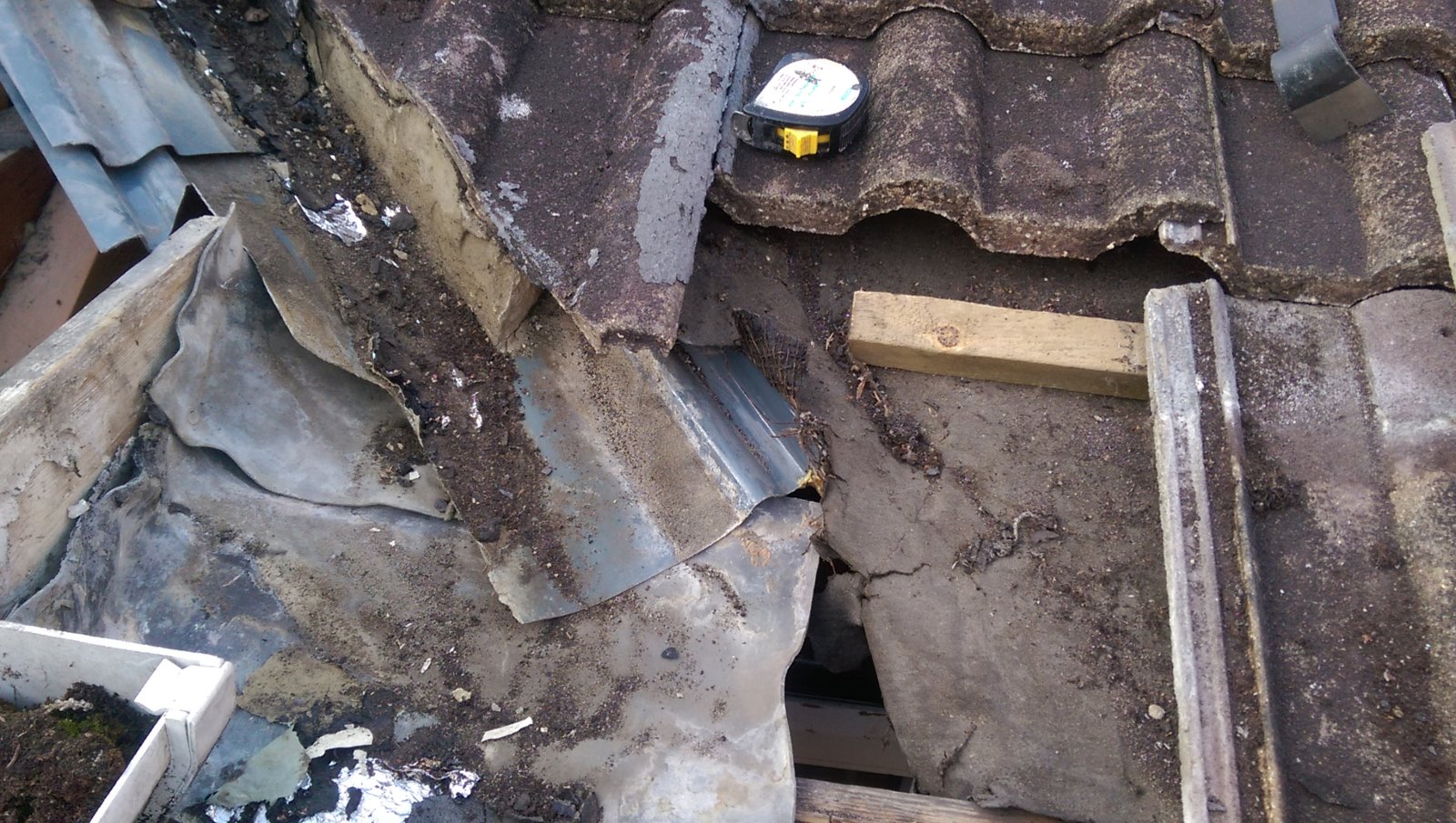

I opened up the bottom quite a bit today and have got some better pics. I think I now get why I need the saddle - without it it would be pretty hard to trip a new piece of grp to drain into the gutter. It sort of begs the question whether I need to extend the grp if I can get a big piece of lead under the lot? If I do, I don't know which grp to get?
Anyway, next set of pics:

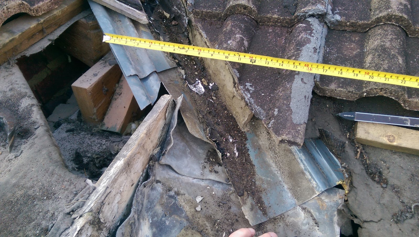

End of the valley is visible here (top left):

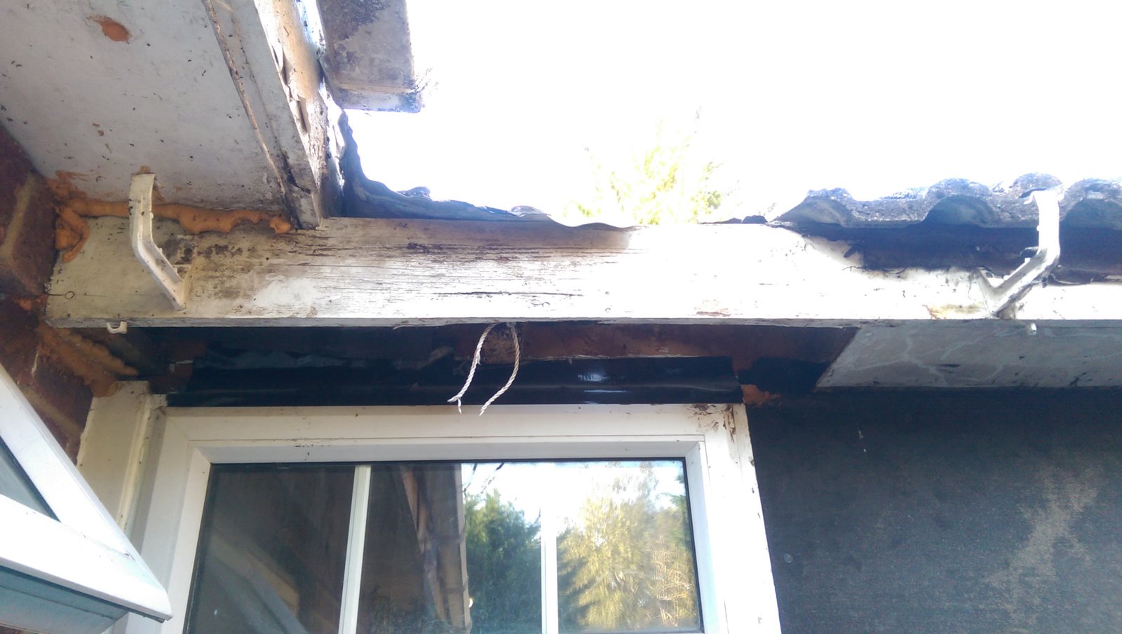

Here is a view of it from underneath with the soffit removed.

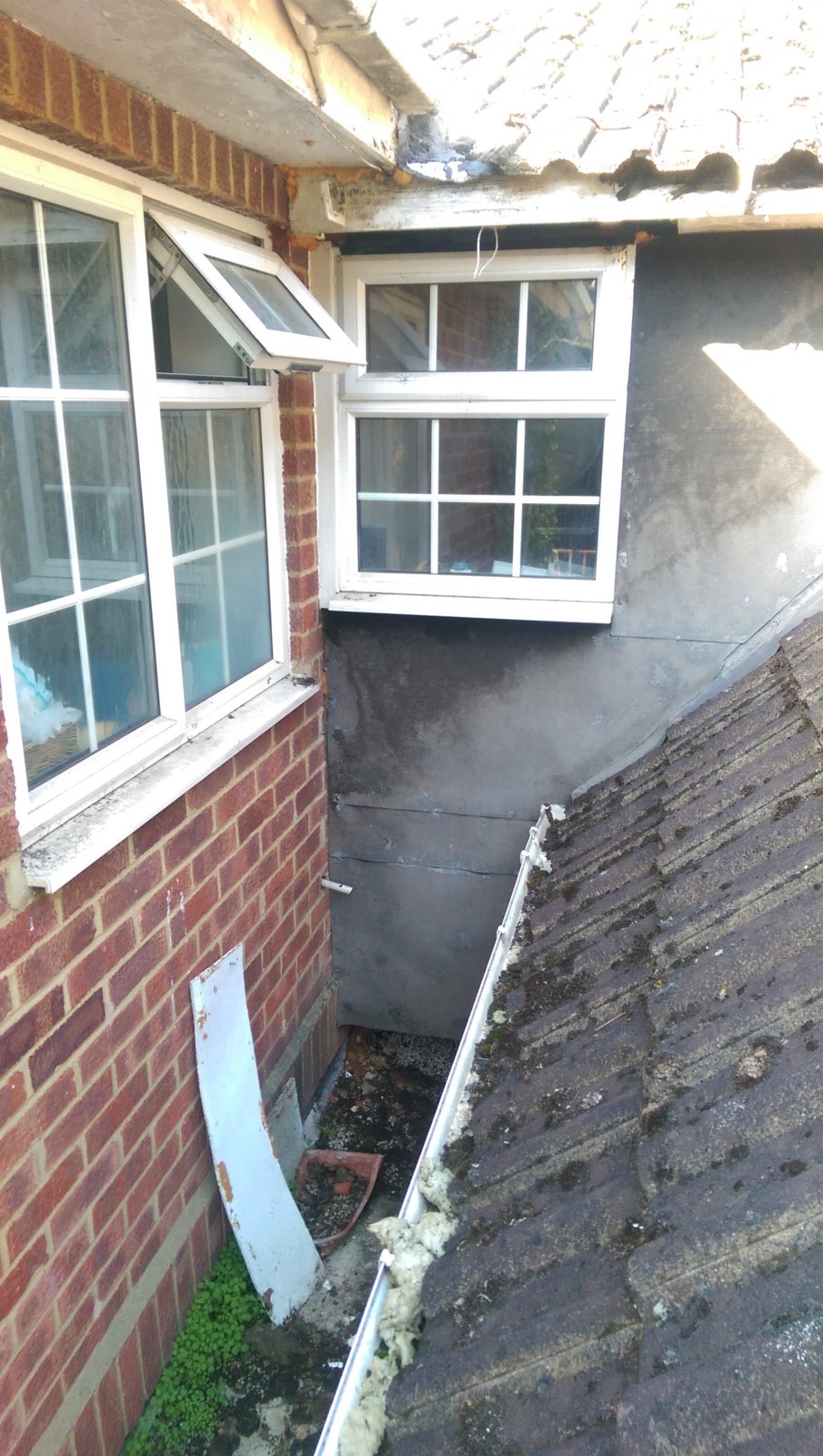

This one is from above. You can see the end of the gutter on the left and the facia on the right where there is normally also a gutter.
Finally here is another view with a tape measure.

The third of the recent photos posted indicates that, if you obtain a length of GRP Valley Trough of an appropriate profile, remove the existing badly cut end piece of Valley Trough and install the new piece under the main existing Valley Trough , this new Valley Trough will (just) “miss” the upper guttering on the left and project into or past the lower guttering – which is not currently in place.
This may be all that is necessary but, without some additional lead sheeting to act as what I might call an “apron” , the water may overshoot on the right and there may be insufficient covering to prevent some leakage, in line with the upper guttering, on the left.
Also, having the stiff valley protect into the guttering is not good practice, as it makes the guttering difficult to clean. Hence the possible need to cut the valley above the guttering and use a lead "apron" underneath it to direct the water.
(As you can tell, I am not familiar with the appropriate plumbing terms.)
(If you don't know the profile required, could you not remove that end piece of existing Valley, install a sheet of heavy plastic as a temporary "valley", down to the guttering and take that end piece to a suppler to determine what profile you required?)
Apart from the end of the existing valley being cut “short” on the left, a part of the problem with the original installation was that there was an attempt to make the water turn at an angle of about 45 degrees. Under these circumstances, the rapidly flowing water will tend to overshoot, unless there is a high enough “lip” installed to stop it.
I suggest that you also check the under roof timbers to see if they need treatment for rot as a result of the leaks.

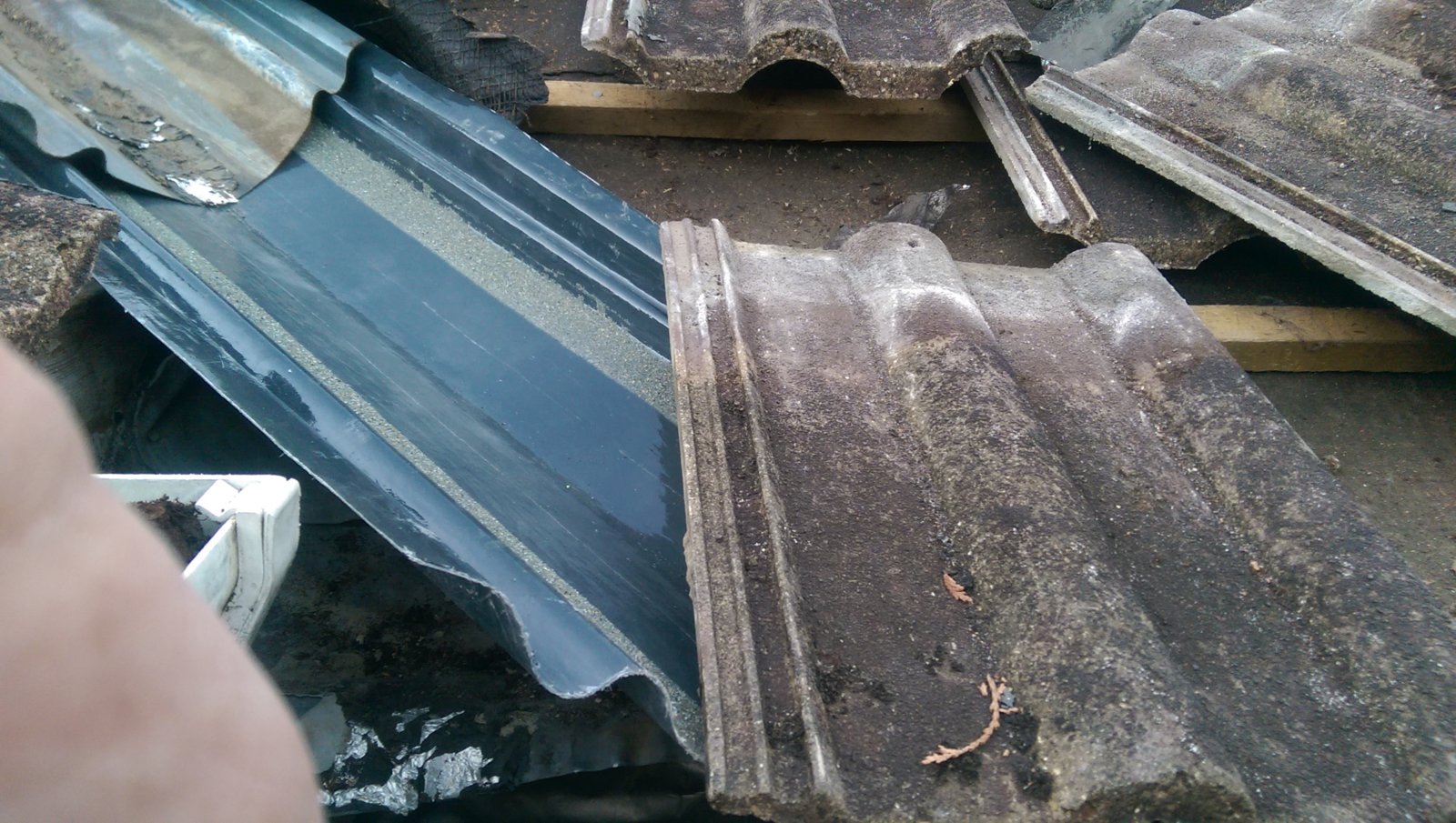

So I've at long last started work on it. I think I now undertstand why that lead saddle at the bottom is needed. I have a new grp valley and have replaced the existing bottom section. However, when I do that the bottom tile doesn't fit over it. I'm still not 100% sure why it doesn't fit but it definitely pushes the bottom tile up too much. It might be because I haven't notched the facia on the left yet - you can see I'm lightning quick.
In @datarebal diagram earlier in the thread he shows that final tile almost butting (definitely not overlapping the grp) and the grp itself cut well short of the gutter. I presume the reason for that is that he knows the tile wouldn't fit over the top otherwise. So since the grp is short of the gutter a large apron is needed (and to keep the hard plastic out of the gutter as previously mentioned) - I'm gonna try and get one quickly now I know what sort of size I need.
With many dry days forecast, I plan to have a further "play" around tomorrow.
Do you mean like this so it runs parallel to the lower gutter? (sorry the old off piece of grp is resting on top in this pic - I put it there so I could see how far down it went).
As far as I can see (well without the notch taken out yet) it doesn't look like the tile will fit over the valley without crushing it.
first tile on right goes under not over. new lead then dressed in place over tile and under valley.

If I remember correctly, I did at one point have that first tile on the right (shown in second pic above) going under the valley. BUT I think the tile above that one would then also hit the valley.
Should I cut the valley more like in your (kindly drawn) first pic which means it is cut much further up or is there some way to do it with the valley cut almost flush with the first row of tiles as shown?
Edit: Maybe the valley rest on top of both tiles (with the lead going inbetween) ?
If you copy my rough drawing , first tile under , second tile over lead in-between
That's all there is to it
