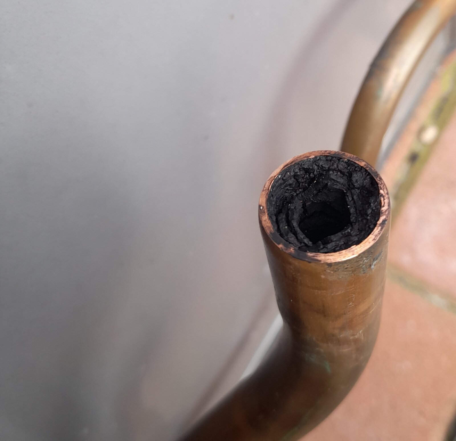

The water in the F/E tank doesn't circulate through the system, I doubt whether corrosion is any different from using an expansion vessel.
The surface area is open to air so will be subjected to ingress of air which EV is not
Rise and fall of water in F&E will also let air into the system water
This is one of the reasons why the feed pipe often blocks up with rusty plug of sediment.
A combi communicating pipe to EV will block up if flexible pipe used with black sediment
In 30 years not seen copper pipe blocked up similarly
But very little of it gets into the circulating water. F/E tank isn't subject to expansion vessel problems, which come up regularly on this forum.
That was the case with open vent on the flow, cold feed on boiler return, but that went out 50 years ago. When it's plumbed boiler - open vent - cold feed pump level change is minuscule (or even combined cold feed and vent, which I'm not keen on, but some go for it).
Do you mean the pipe from the F/E tank to the system? Good reason to keep the inhibitor concentration up to scratch!
See pic open vented on a H section did one last week even worse but that had a airjec fitted .
