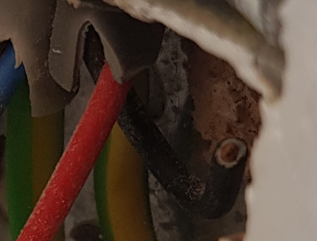

On another forum, you posted this picture...(but not here?)
The cut too short black wire is the problem. ( = zoomed in version of the above)
It is supposed to be in with the blue wire. Disconnect all the black wires from the rose, sort out this black wire first.
Then start again with the advise already given by others about using the multimeter to determine which is the switched live at the rose.

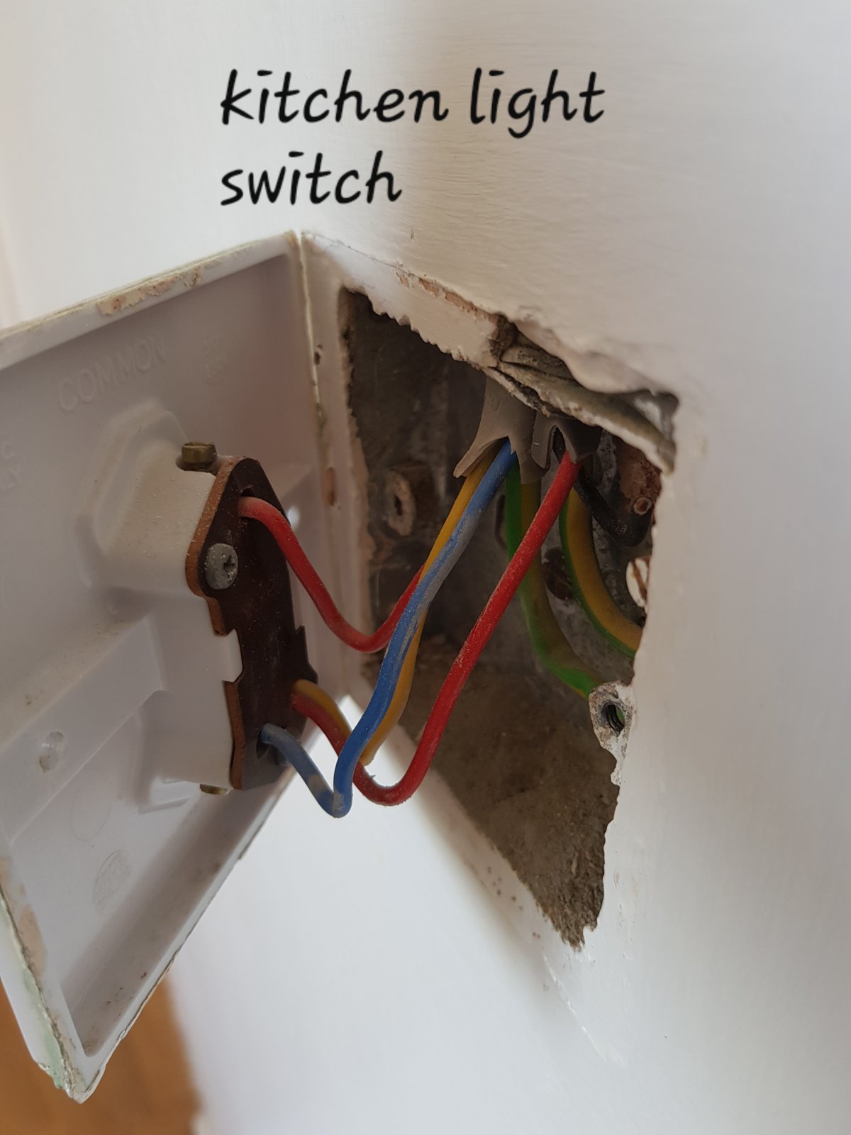

20190531_175820-jpg.49703

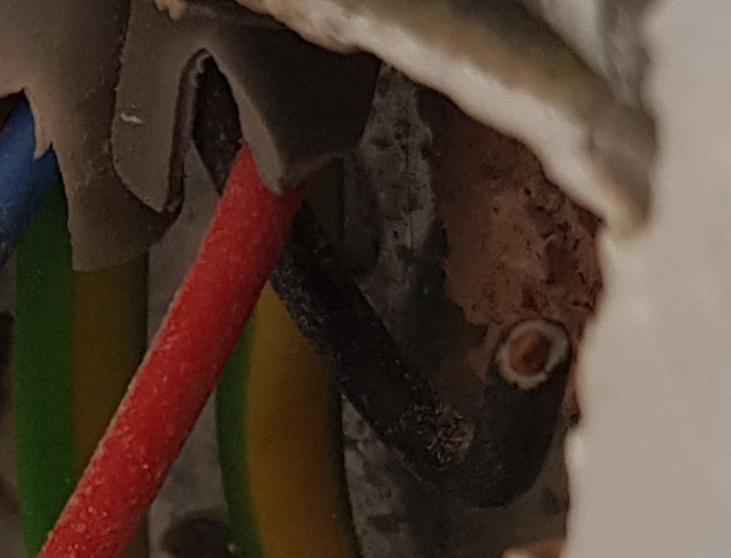

No need to apologise Lee ,but the pic from other thread that RSGAZ posted ,appears to show a switch. If you don't give clear info ,and answer the questions raised ,then you are not likely to get the right response. Regards Terry.
Lee, @terryplumb is totally correct, there's no need to apologise, the point I was making is that we need ALL the information in order to help.
I don't think the picture came out for everyone did it, only the zoomed in one that I made? I've edited that post now, the first picture should work.
