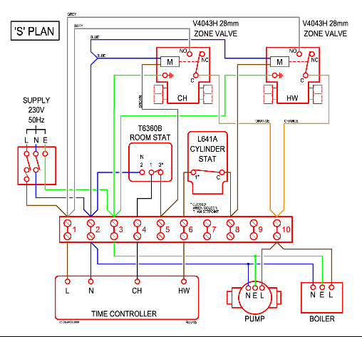

Hi,
not sure if this is the best forum or gas.
had an electrician in to rewire a kitchen. He removed a lot of ‘old’ wiring including that of the old thermostat as we have hive. However , now the pump does not come on for the CH but does for the hot water.
anyone any idea of what might of happened please?

Normally the pump is connected to the same wires as the boiler or wired from the boiler, so I am at a loss.
Someone else may know.

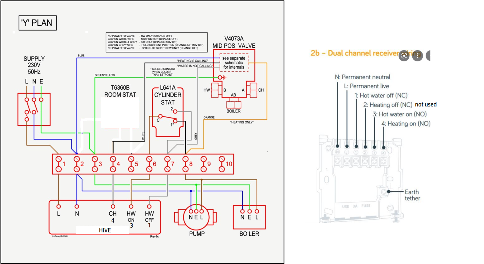

Assuming you have a three-port valve, then this is the wiring - with the proviso that the pump wires might come from the boiler.
I have two valves. I can here the valve changing when it calls for CH but no pump power. Very strange.
Room stat is wireless give though. I can’t work it out why it wouldn’t work after removing cables.

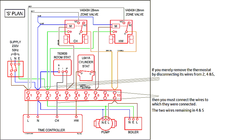

Yes I removed the thermostat on the first (wrong) diagram - just do the same.
The problem is, if the valve works and switches on the boiler it should also switch on the pump.
If there are separate wires from the valve to pump, presumably the CH one is the fault, BUT
if the pump is wired from the boiler, then it could be a boiler fault - coincidences do happen.

I suspect that the 'electrician' has removed the thermostat cable and not changed the wiring to connect the CH on (Hive 4) to the valve.
Do you have a wiring centre somewhere?
If so, post a picture of the connections. It might be possible to tell.
Switch off the power before removing the lid. Just copy and paste pictures.

It depends where the wiring is.
If you have a wiring centre where all the wiring from the various parts come together for connection, it will likely be there.
Like the row of connectors in the diagrams.
Of course the numbers might not be the same in yours.
Of course, that might not be the problem.
