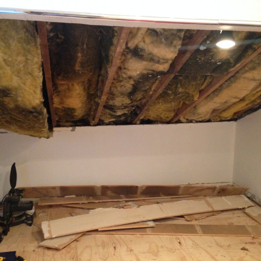

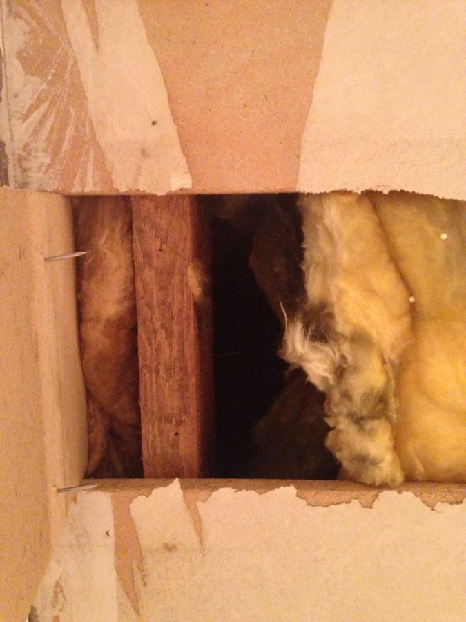

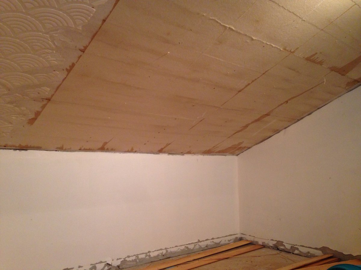

Hi everyone I have ripped out some large fitted wardrobes from kids room as the cupboard was as large as the room and you couldn't even for his bed in the room without it blocking cupboards or the door, it's on the only part of the house with roof that slopes from the peak of roof down to the 1st floor, there is a large price of wood across middle of room I take it holding the roof up but I have a few questions , I am on mobile and I have uploaded pics of the room from the door and I can see the tounge and groove wood across the sloped roof I have removed that and uploaded images of the mdf or chipboard that is covering roof, I removed that and you can see rafters woth a small amount of insulation in there it's a very cold room and what you think is best option buy the insulation that can be cut and pushed into rafters then do I need the silver sheeting then plasterboard ? Or leave what is already on and fit the plasterboard that has insulation on already then pay someone to plaster the roof ?
Any opinions welcome or help appreciated , I want to build a false wall with some cupboards in after insulation sorted

Thanks for the reply, would you just leave the mdf and everything on the celing then just add the plasterboard/insulation straight onto that ? Thats the cheapest price i have seen that i was looking at b and q etc , is that site often the cheapest ? Actually just looked and deliver is fortune
so you think that is better option than removing all the wood amd totally repacking the rafters ? Not sure if would have been cheaper etc what you think ? Also wasnt sure if to remove the roof on other half of room but already plastered and painted etc so would make a huge mess so might just do the lower half of celing as planned

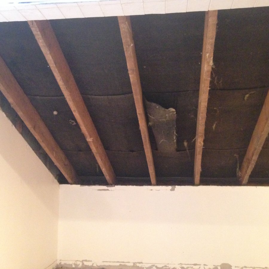

Hi everyone sorry to open an old thread back up just have a few questions, I have took up all the floor and fitted sheets of plywood I am now going to tackle the room, I am going to remove the mdf Off the sloping roof but have a couple of questions, after I remove the mdf and the insulation from the rafters i can see the felt stuff when I get to this stage
1. What is the best thickness solid insulation to fit into the roof ?
2. Is there a specific gap I need to leave from the felt to insulation and from insulation to plasterboard?
3. Lastly I was going to put plasterboard with the silver sheeting on the bottom is this correct ? So felt on the roof then the solid insulation then silver sheet with plasterboard ?

As thick as you have room for, 100mm would be good then foil tape the joins and add insulated plasterboard for a an effective job.
Thanks for that mat that's very helpful ,do I push the solid insulation into the rafter gaps ? If so I won't need the foil tape as there will be insulation in the rafters then rafter then insulation in next one and so on, I was going to the plaster board (using the plasterboard with a silver sheet on the back onto the wood rafters ?
Do I need to leave gap from the felt under the roof tiles ,think must be the membrane above the current insulation ? And do I need to add tape in beetween the plaster boards ?
Also when I make my stud wall on the sloping roof would you put insulation I beetween the wood then plasterboard over the top ?

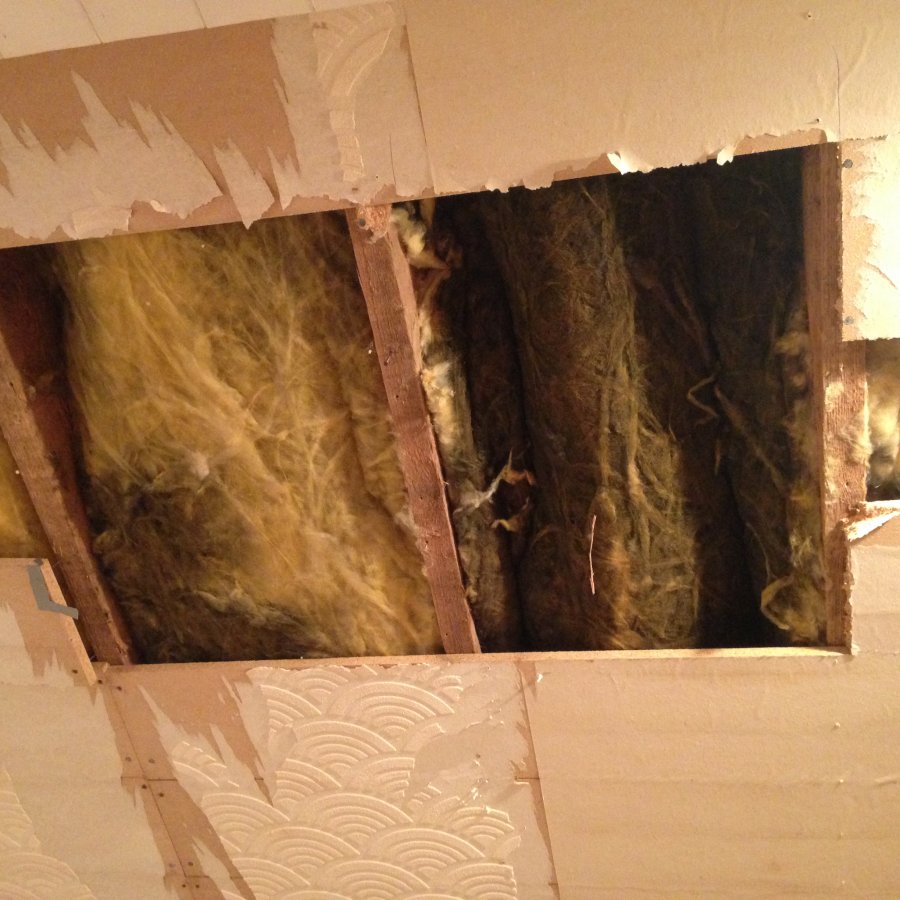

Hi here is a pic to help out
I am removing the mdf some one out there on the sloping ceiling and found not much insulation behind it, when I take that insulation out and put solid insulation in pf 100mm thick, (the rafters from bottom to top are 15cm) do I just cut to size then push up into the rafter right to the top or stop before hits the very top ? And then do I just put plasterboard with the silver sheeting across the rafters to seal in?
Really need help as want to get this finished so any help greatly appreciated
Thanks Dean
Leave the insulation flush with rafters.
Thanks for that so remove the existing insulation and push solid insulation in till its flush so that would leave 5cm or so at the top for air to flow?
And as for plaster board would would you then just plasterboard directly onto the rafters with the plasterboard with the silver sheeting on one side ?
Do you just use wood screws and will I need to tape the joints ?
Thanks again as you have been great help
Dean
Use plasterboard screws and tape all joints.

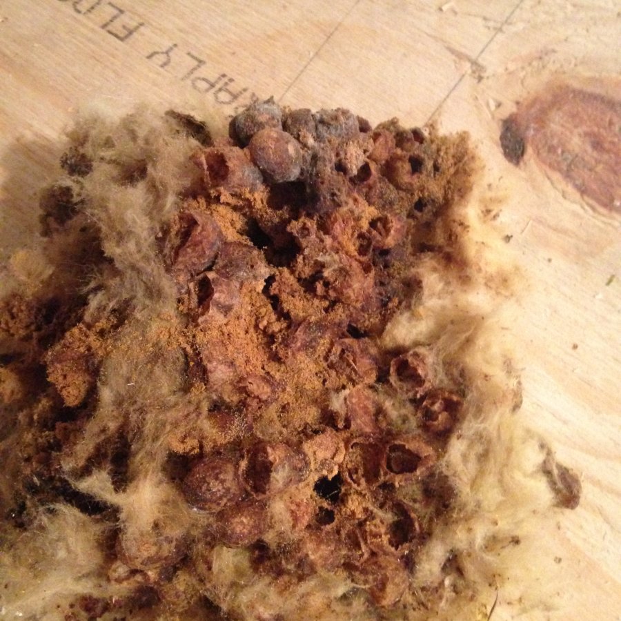

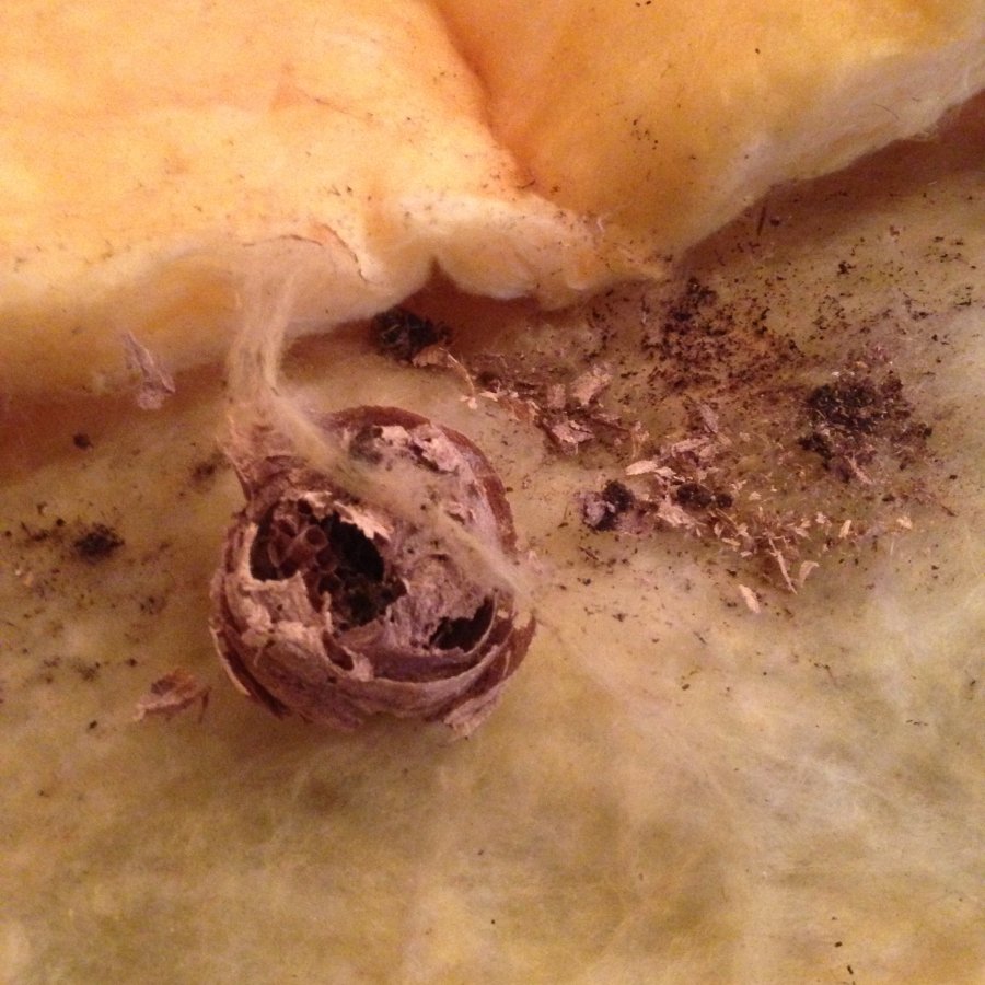

Removed insulation this morning, dirty job
Found a few little neat things but nothing alive and moving so hopefully be fine you think they are nothing ?
And would you do what I said with plasterboard
