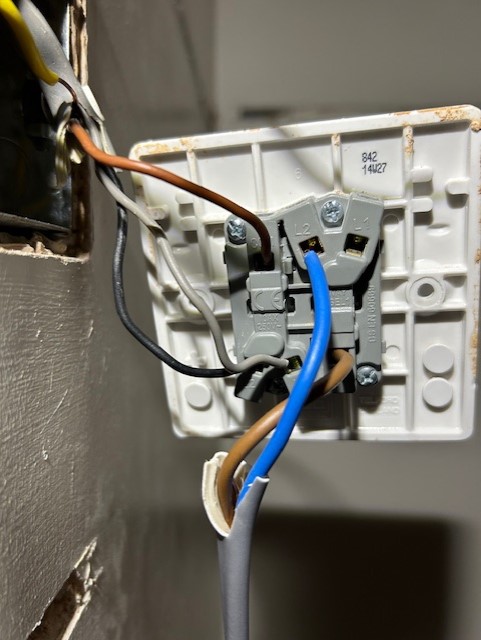

Sorry missed this one - there is another cable, its a 3 core (black/grey/brown) which I *think* is connected to a secondary switch in the hallway. I took detailed notes and pictures of both switches before touching them so I've put everything back exactly as it was. The complete layout of the porch switch as I found it was:
Com (top): Fat brown + brown from thin T&E
L2 (top): Fat blue + blue from thin T&E
L1 (top): Empty
L2 (bottom): Black from 3 core
L1 (bottom): Grey from 3 core
Com (bottom): Brown from 3 core
what happens to the 3 core if you alter the position of the switch in the hallway?
Can you post those photos of all switches wiring, including the hallway.? Simply copy and past them into a reply.
I'm throwing out thoughts here and making a guess we are here:
Bottom left being the porch light.
There is a small possibility the black wire is the neutral and not part of strappers.

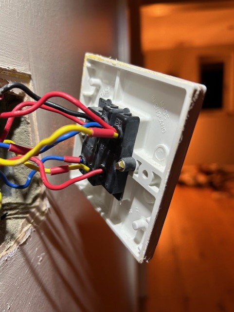

I've attached pictures of both here - the brighter one is the porch switch in question, the other one with more wires is the one inside the hallway of the house which also controls some wall lights in the hallway via the second switch.
Flicking the left switch in the hallway does the following (The wiring closest to the camera on the hallway switch is the one in question.)
1. Turns off the inside light inside the porch
2. At the porch switch the 3 core behaves in the following way:
- Brown loses voltage
- Black remains with no voltage
- Grey remains live
In the picture of the porch switch, the thicker T&E represents both the thick and thin ones, I just have them combined with a wago downstream to avoid constantly jamming them into the switch whilst figuring this out.
- Grey remains live
There is obviously another accessory or junction box somewhere. Did you notice if the colour circled wires are in the same cable?
If not can you list by numbers which form cables?
Are 1 black and 7 blue in the same terminal (looks like B1)
Does the position of switch with brown, black, grey cable make any difference to the porch light? there are 4 combinations of the 2 switch positions: up up, up down, down down, down up.
View attachment 325593If not can you list by numbers which form cables?
Yep 1 Black and 7 Blue go to the same terminal (B1). Coming into this hallway switch box are 3 cables which have all been labelled:
'H2 Wall' - which I assume to be the wall lights in the hallway, the 3 wires from H2 Wall are on the right side of the switch in 'A Com', 'A1', and 'A2'.
'P' - Black with red sleeve to B1, and Red to B2
'P2W' - Red to 'B Com', Blue with red sleeve to 'B1', yellow with red sleeve to 'B2'
In the porch, the right hand switch (with the black/grey/brown) turns the porch light on and off

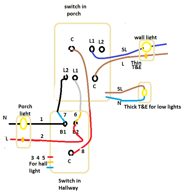

Ah so presumably the hallway and porch switches are working correctly as 2 way.
This is what I think you have:
Somewhere there is a junction box or another accessory where the red,yello,blue join the brown,black,grey.
Next, how many lighting circuits do you have in the consumer unit (fuse box) and are the porch light and the outside wall light on the same breaker/fuse? If they are I may ask you to have a look in some lights. But in reality I think you will be looking at getting another cable to the porch switch or moving the thicker T&E.
