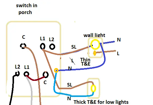

All the lights in question here - outside, low level, porch, hallway are on the same circuit on the consumer unit. Interestingly, I just tested connecting the thick T&E blue to a neutral for an existing light inside, and the brown to the switched live and the outside lights work fine. It sounds like I might just be looking to get a switched live and neutral to that thick connection then?

Success on that front - Known good neutral to thick blue + grey to thick brown results in the low level lighting being on. Tried a variety of switches and none seem to change that. The big thing is that the wall lantern could be switched on/off by the switch in the porch independently!
So it sounds like we have a constant live from that grey, but somehow need to make it switched and find a neutral near the switch to pair it with?

Now can you check the wiring in the wall light?
Does it bear any resemblance to this with Lin & Lout joined and N in & SL from switch to light?
or
This is the alteration I'd be looking at with a neutral join in the switch backbox and a wire link between the switches, (If it's too messy to make sense I'll redraw).
A little unconvential but a means to an end without major work.
