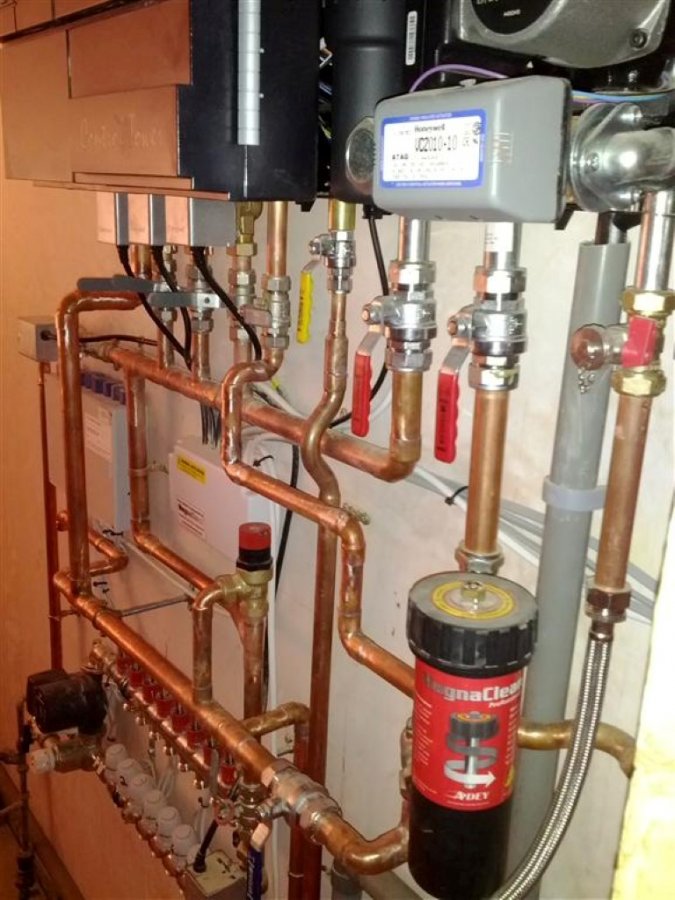

Yes BEFORE applying heat. Solder goes wherever there is flux. One of the old codgers here once suggested he draw a line with a pencil around the shoulder of the fitting and that stopped the solder adhering further down/up. Can't say I 've tried it though.
I believe Dan said he uses electrical solder for his joints - forgive me if I'm wrong.
The man is poetry in pipework.
