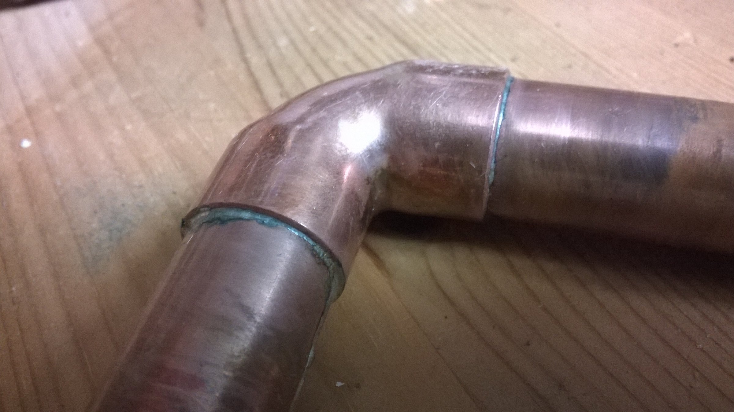

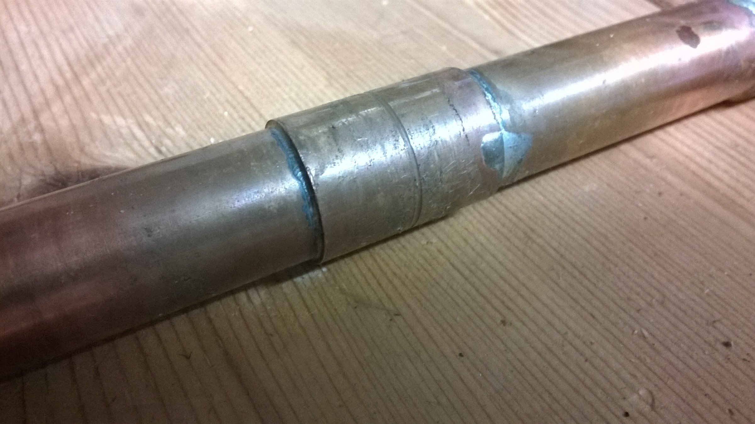

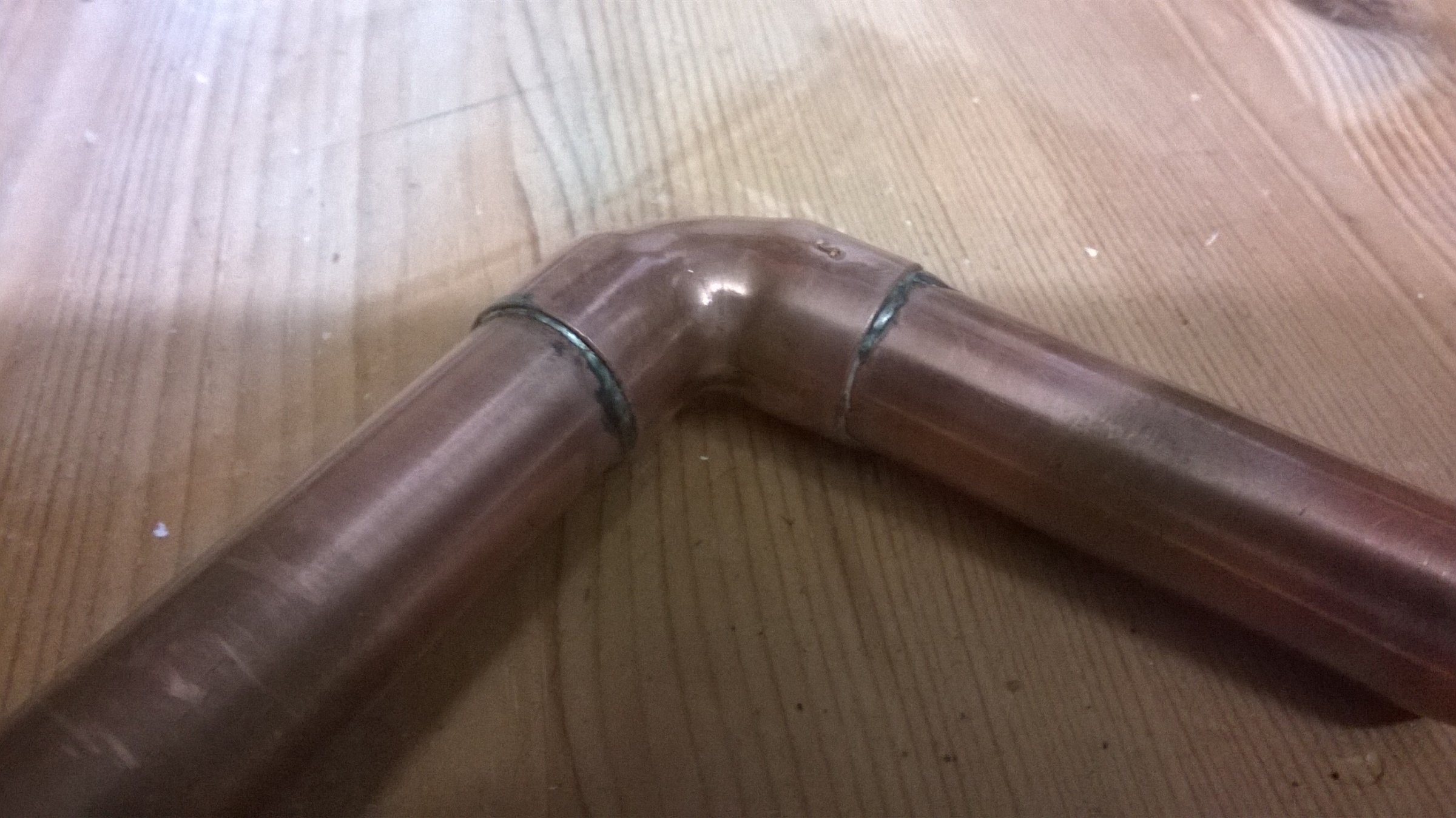

So I took back the crappy torch and invested in a Rotherberger SuperFire 2. All I can say is WOW! It was pricey but you definitely get what you pay for. Soldering is now effortless and a lot neater! Thanks for all your advice guys, I'm feeling a bit more confident now I have the right tools and had a little more practice :)
Joints look good, but even the best looking joints can leak ( everybody gets leaks) the only way to know if a joint is good is to test it, if it looks good and doesn't leak, all gravy
