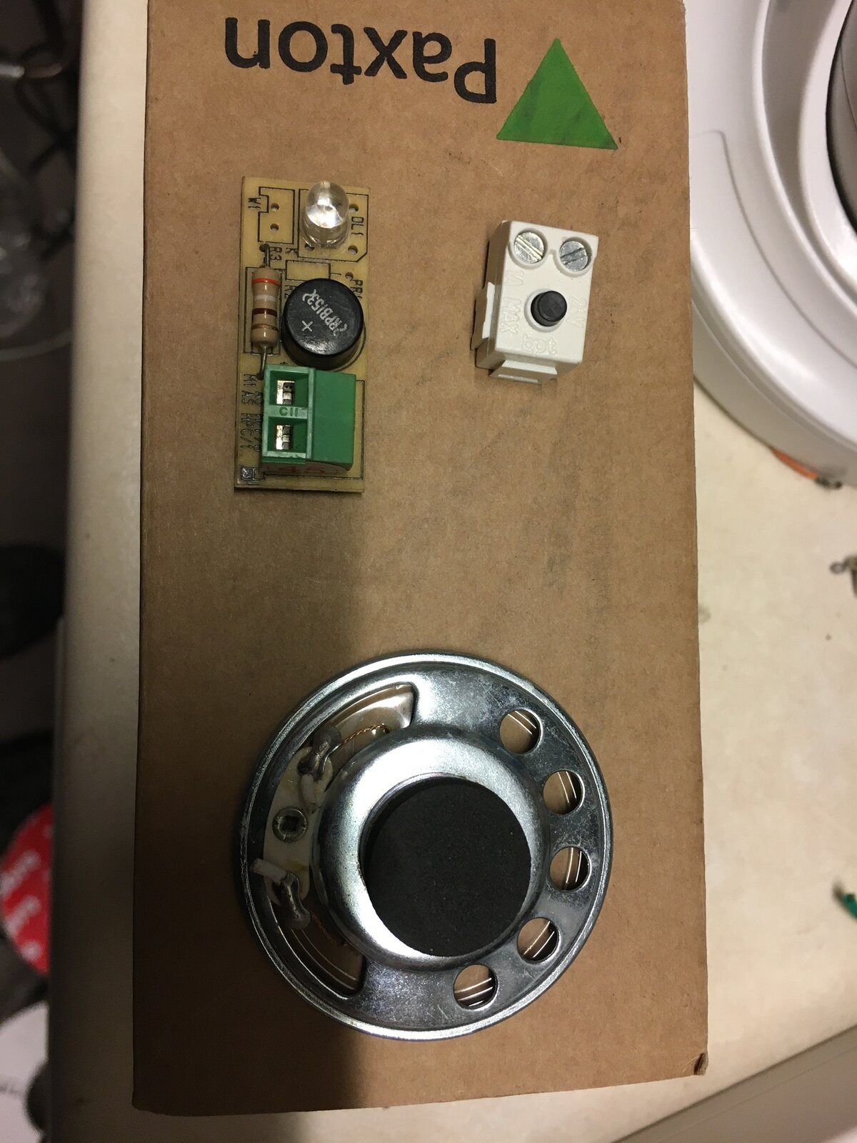

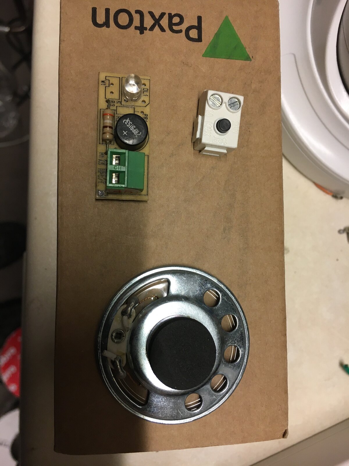

Help with Targha BPT Video entry, buzzer not working
9FBEC902-EACA-48B2-98C9-7207CBF41351.jpeg I would open up the unit and desolder one of the wires to the speaker then check the speaker with a multimeter first ....I think they are 50 ohm..
