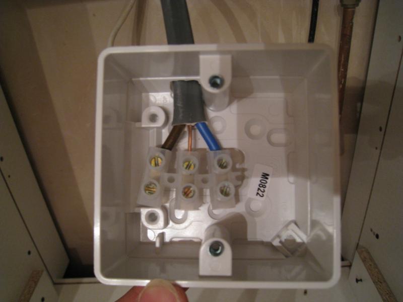

So, I couldn't find a cooker plate. But I did find a junction box. So I've wired some 6mm cable into the hob as you told me and used the jumper to connect the two lives. Sorry I don't have a picture.
I've wired the other end into the junction box here:

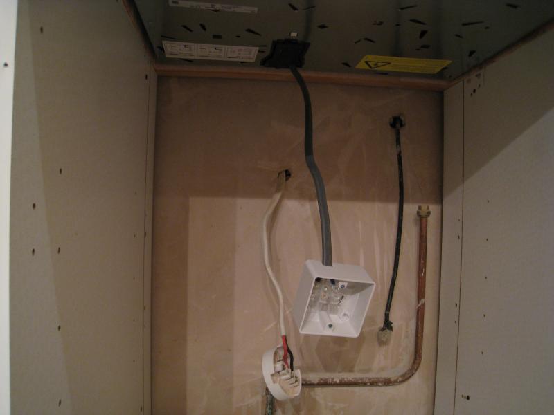

I'm assuming all I now need to do is remove the mains cable from the small round white junction box and wire it into my new square junction box. Then wire the cooker cable (which came with the cooker) into the same 'out' bits as the hob in the junction box? The cable from the cooker is small enough to share the junction box connector with the hob:

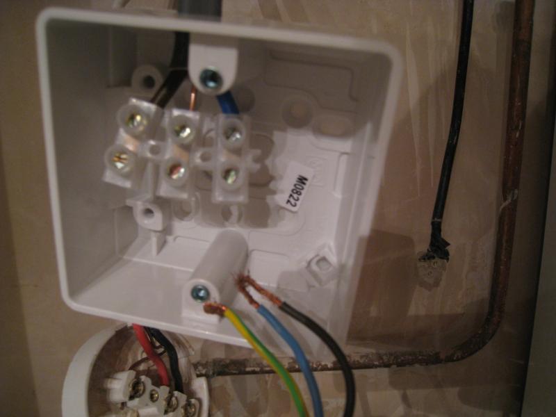

that black cable seems to be missing an earth core, and may not be man enough to feed your oven ( looks like it was a feed to an electric igniter for the gas hob? )
You mean that black cable dangling in the background? I'm not certain but I'm sure that was the ignitor for the old gas hob. The connector block I'm using is 30amp.
So why do I need sleeving for the earth...if I did, wouldn't it already come with sleeving? I'm confused why the live and neutral are sleeved but not the earth.

You might be, but you have been advised in no uncertain terms what to use to connect it all up. You have also been advised to get earthing sleeve, which you don't appear to have bothered with. What are you covering the pattress front opening with?
You have also failed to inform anyone of the rating for the oven.
Why do you bother to ask for advice from professionals on here if you have no intention of following it?
Do what you will, but make sure your smoke detectors are functioning and that the emergency services have been told to remain on alert.
you need to screw that box to the back wall if you insist on using it ( and it should idealy be mounted with the screws horizontal, not vertical. )
the connector block would be ok as a temporary solution if you're desperate to use your new hob tonight, but a cooker outlet plate is the best way to go..
the earth is not insulated in T+E to save money.. you need to sleeve it where you strip the outer back to connect it.. ( especially in the hob, with all those screws so easy to accidentally come into contact with... )
I don't know what the oven rating is. There is nothing on the unit at all that mentions KW or Wattage or anything. So I wont wire the oven in for now. What rating will I be ok with and what rating would be a problem?
Returning to the hob. It helps if I know why I need sleeve for the earth as it helps me to understand what I'm doing. So thanks for telling me why I need earthing sleeve. I'll get some tomorrow.

And why are you taking no notice of the manufacturer's instructions?
I can't be 100% sure, as it's not a good enough photo, but I'm pretty sure that on the flex representations it tells you what specification you need.
Or if not there, then it will tell you in the installation manual/instructions.
Your reason for ignoring what they told you and using 0.5mm² flex was what, exactly?
