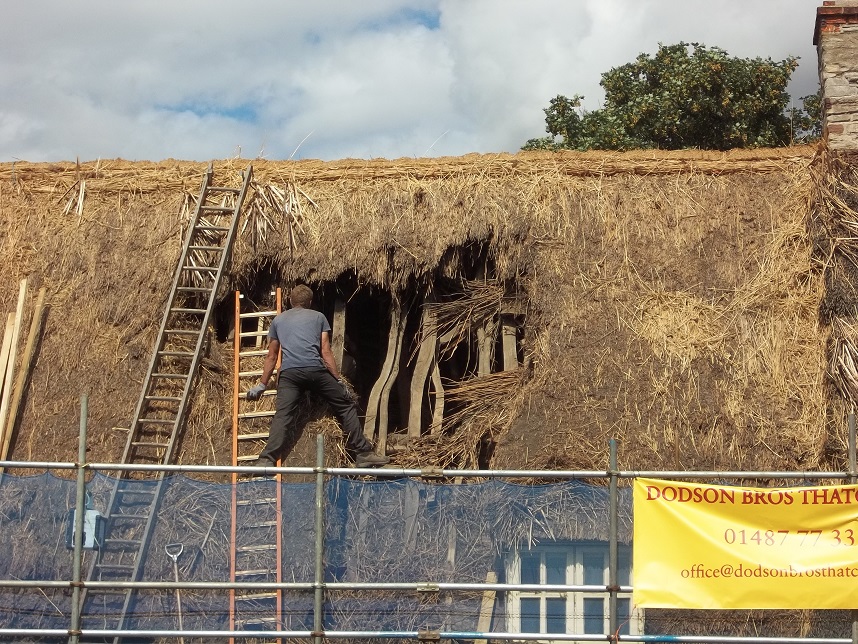

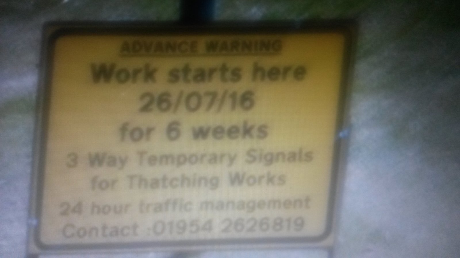

Some people even have roads closed to re thatch their 500 year old cottage.Was that you Bernie ? fess up :mrgreen:.
Not closed. Single track working under three way traffic light control. Planned over a year in advance and during the school summer holidays.
Slowest single track working ever seen :sleep:
Were the thatchers on day work ?
