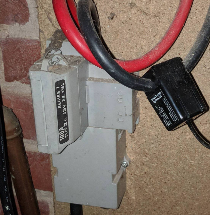

High Impedance Earth, advice
yep that's all I can see
Oh dear. It's a very long time since it was permissible to use a water supply pipe as an earth (if that's what you have) - for the main reason that one day the supply pipe will become plastic and you'll have no earth at all.

From the latter photo it looks like there is already a blue water supply pipe. That doesn't look like a water supply pipe with the clamp (maybe it used to be!)
What's the difference between an earth rod and a redundant water supply again?:LOL:
Yes, maybe - but there's no telling where that bit of pipe comes from. You're certainly right that the water supply pipe appears to be plastic - I hadn't noticed that.
Well, the main difference is that one would hope that an earth rod would have a lower resistance than 2.7kΩ :)
But, seriously, as above, one just doesn't know what that bit of pipe is, how long it is, or whether it actually goes 'into the earth' at all.
If it were a redundant water pipe that had been shown to be adequate as an earth electrode, it would be essential that it had one of those metal warning thingies attached to it - since, otherwise, someone could remove the pipe, thinking that the attached G/Y was just an old ('redundant') bonding conductor.

Just an update for you guys,
The DNO came out and had one look and said it was pme and took a reading from source of 0.33 ohms.
they were quite annoyed that the guy installing it hadn't taken a reading from the consumer unit and also that he'd told me to ring them.
the earthing to the pipe they said was just to bond the central heating.
they fitted an earthing block with an earth wire going into the cutout for the installer to come back and wire into.

That would have made no difference - you may well have a PME supply provided, but you are not using the earth from it. There is no earth conductor from here to your installation:
Well, it would be doing that if there was an earth to bond the pipes to.
But there isn't, what that conductor is doing is providing the only, and woefully inadequate, earth you have.
They would have had to come out and do that anyway. There's no indication anywhere to tell someone that it's a PME supply, so an electrician can't just decide to connect the installation earth to the incoming neutral.
And if they didn't connect that block to the earth bar in the CU then you still have no earth, and you must get that resolved as soon as you can, if not sooner.
