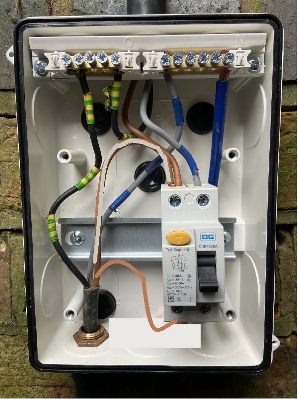

Hot tub tripping, but also working… crossed Neutral?
Looks like now just need to swap black (Earth) and grey (Neutral) and then move Brown (live) to LINE 2 instead of LINE 1
If the RCD does not trip (assuming it is functioning correctly) now that you have connected it properly, the neutral and earth cannot be the wrong way round so some investigation is required to determine which is actually which and not just relying on the colours.
Would anyone actually want to get into this tub when it is full of water without having it properly tested for electrical safety?
Have connected up RCD and wired in how the wires are supposed to be and it is indeed tripping, so I’m guessing a fault somewhere in the tub circuitry, which is odd as it appears to be functioning perfectly. I’ll get a sparks round to investigate, seems very odd as it’s working perfectly and apparently has been wired up this way for some years, thanks all

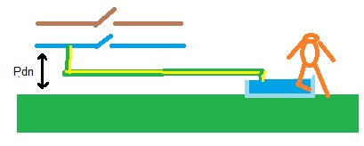

Exporting the CPC ( Earth ) from the house to a pool of water outside the house can create a hazardous situation as the CPC may be at a different potential to the Ground, it often is a few volts different, not enough to be a hazard to a person in contact with both Ground and the water, Worst case it could be a difference high enough to give a fatal shock. In this case the RCD will NOT operate as the fault current is flowing in the CPC cable and therefore does not affect the RCD, also it cannot be switched off as there are no switches in the CPC wiring,
If Pdn ( potential between network Neutral and true Ground ) is high then the man gets a shock. Anyone lifting him out of the water would also get a shock.

The sketch is basic, perhaps I should have added finer details
The CPC form the house is almost certainly connected to the metal parts of the tub. One or more of those metal parts are likely to be pipes \ pumps \ heater in contact with the water.
It is a bit like garden tools not being connected to the CPC in case the potential on the TN-C-S CPC becomes hazardous.
