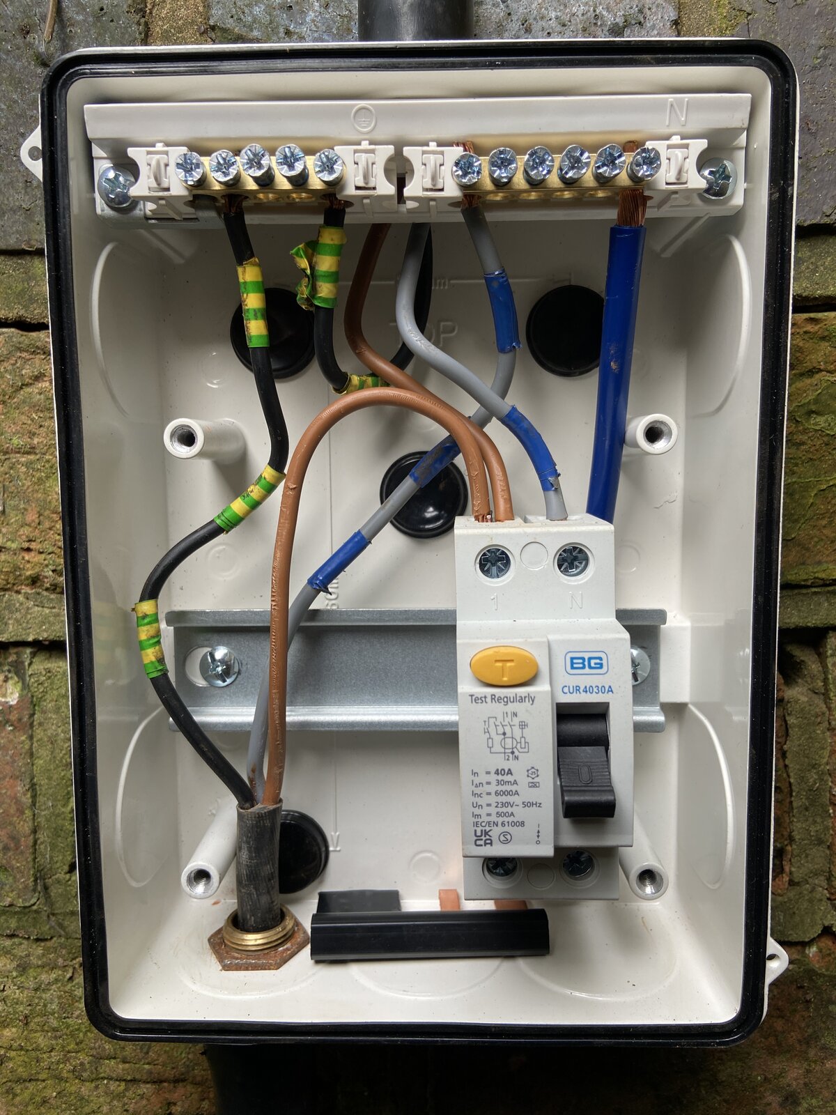

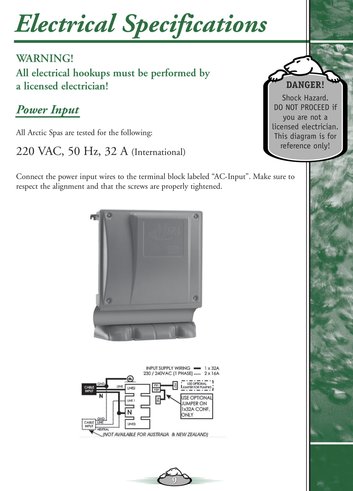

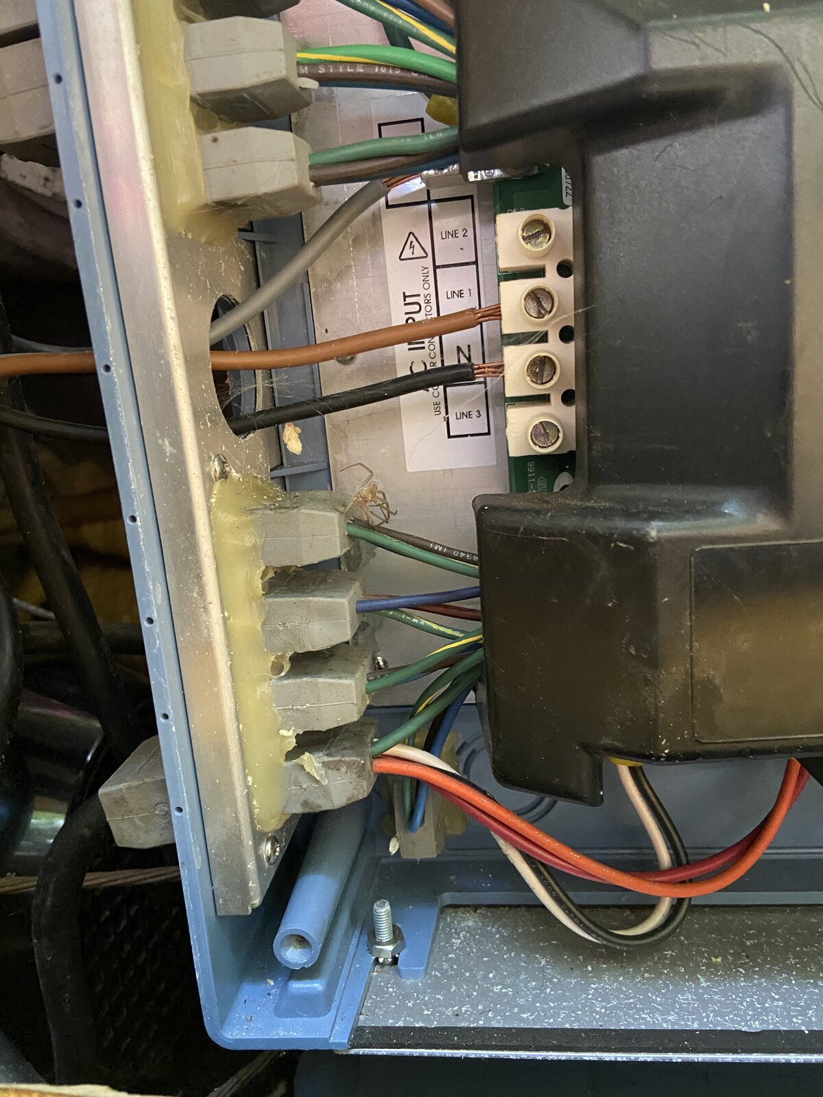

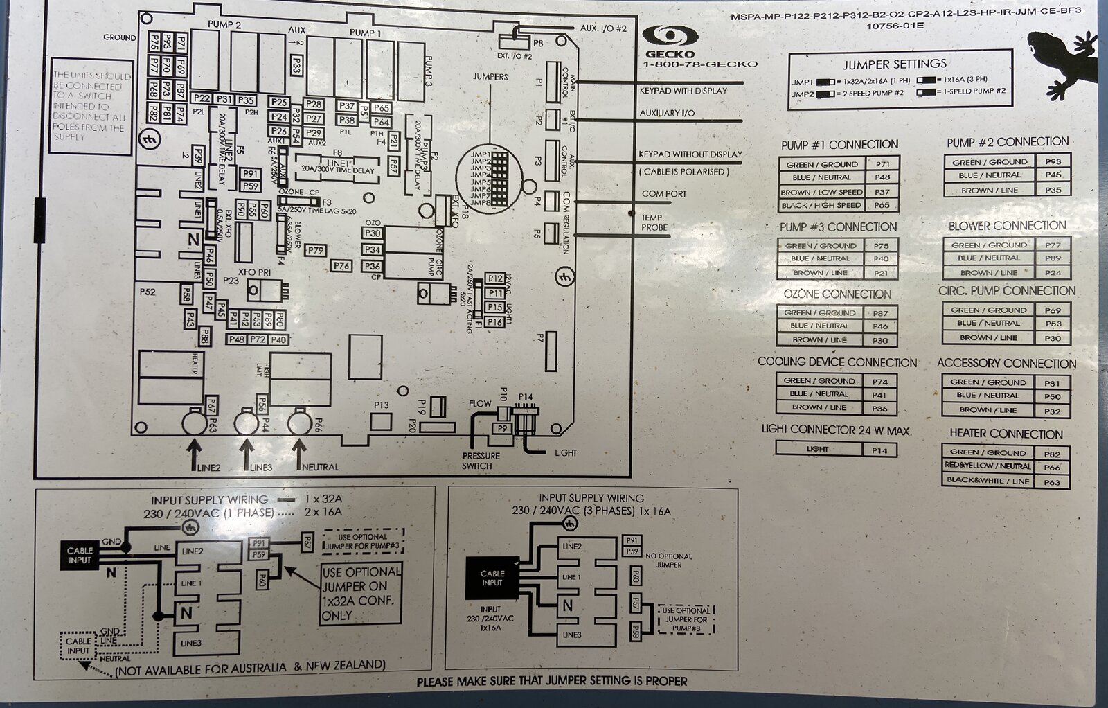

Nope I mean the 40Amp. (which is adjacent to tub)
when connected up as in Theory it ‘should‘ be (ie live through the 40A RCD and Neutral to N, Live to LINE 2 and Earth to earth it trips….
if I connect it back up to how it was when I found it (ie bypassing the local 40Amp, but still on the B32 Amp RCD in outbuilding away from tub and the Live to Live and Neutral and earth swapped, everything works fine.
so frankly it’s all bloody weird. Surely if N and E were swapped it just shouldn’t work….but it does.
I even tried connecting tub up as it ‘should’ be and bypassing local 40A RCD and this too caused a trip on RVd in outbuilding . I wonder if the fact the tub CAN operate in 3 phase may have something to do with it (see attached circuitry diagram, bottom left where it appears Line 1 and Line 2 appear to be connected

Are Neutral and earth crossed or does it change over mid way? On the RCD black is earth and grey is Neutral. In the hot tub Grey is earth and Black Neutral?
