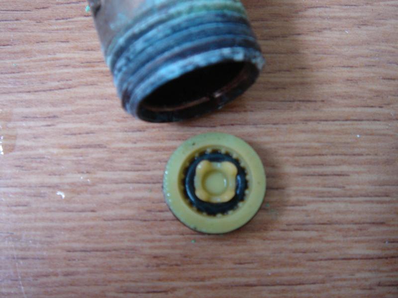

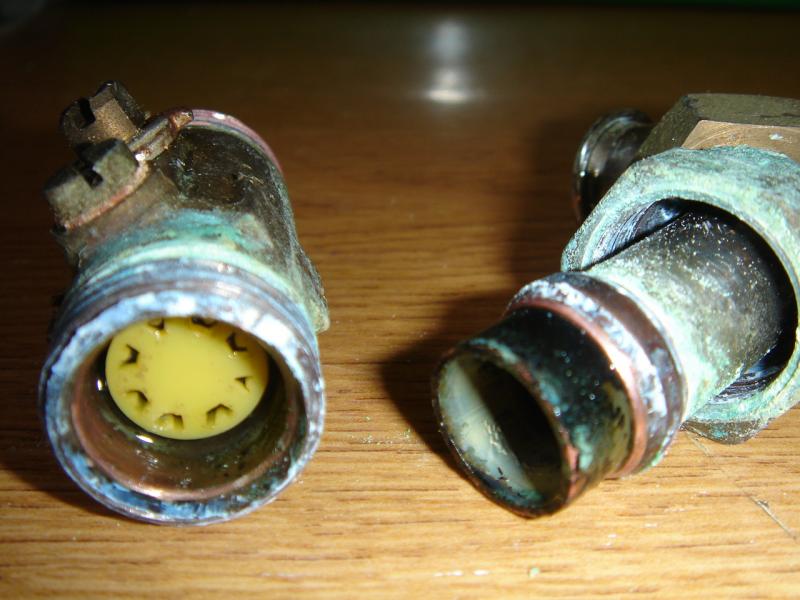

So I am going to ask him to check the following tomorrow:
Blocked Filter on water inlet
Jammed hot start device
Cold inlet isolating valve - Check / remove the flow isolater pressed in the end as can block
Water saving valve
DHW Thermostat / Flow limiter not opening - MOST LIKELY
Now the only thing I know for certain they have done is changed a thermostat. I don't know which one, is it possible that this could be any of the above items - they changed both the hot water and the ch ones, they were very small as he had them in his pocket trouser pocket.
Is there anything I have missed. Once again thanks for all the help on here. it really is appreciated.
For a start take out the cold inlet isolating valve and pressed inside you may find a flow LIMITER.
Either remove the entire flow limiter or just take out the small O ring inside..they often swell up or the small waterways clog with debris.
Thanks Gasguru can this then just be put back in without the limiter in place or should it be replaced?

You can leave it out and moderate the flow at the tap, whoever comes give 'em plenty of space, you get some right PITA customers that hover over you like flies on a turd :)
