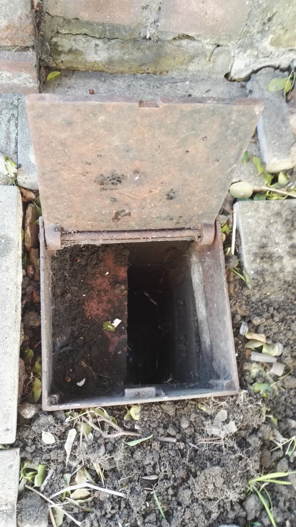

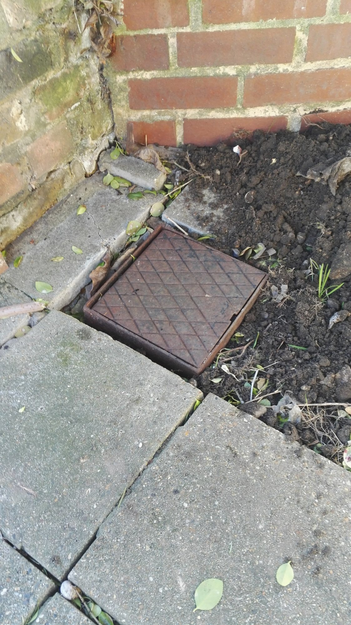

So I've just had a quote from a plumber to replace the stopcock. He's telling me £500 (per man) for labour and £150-250 for parts. He is saying it is a big job because he would have to dig around the hole to create space to work and then replace the stopcock with a commercial valve. I'm not quite sure why he believes he needs to do those 2 things but, as you can tell, I'm no expert.
He has not actually visited yet, but gave the quote on the basis of some photos I sent him (see attached). Unfortunately, you cannot actually see the stopcock tap in the photos because it's under water.
I was shocked at this quote but maybe it is not unreasonable. What are your thoughts?

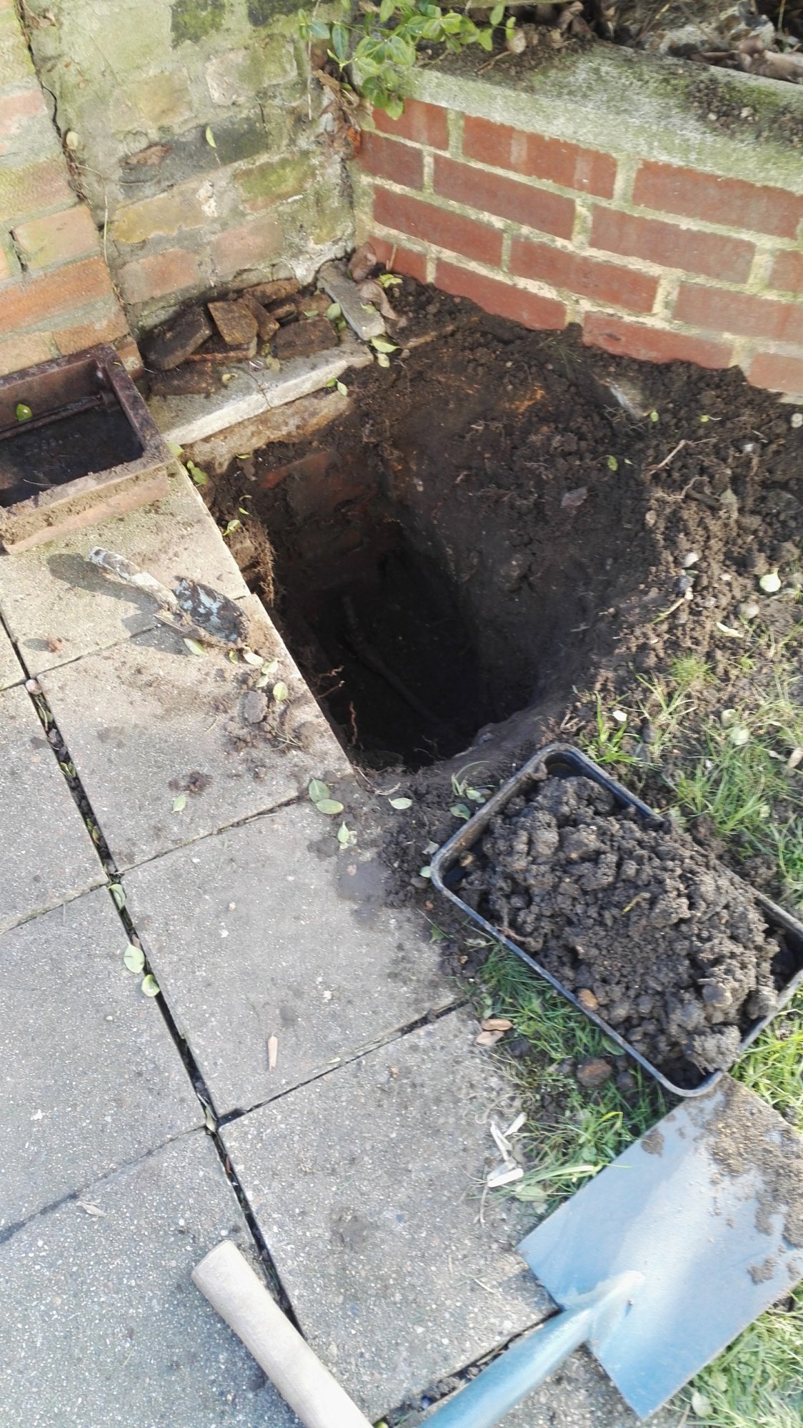

Saw a plumber yesterday and agreed with him that I would dig out around the stopcock before he gives me a proper quote. Wish me luck!

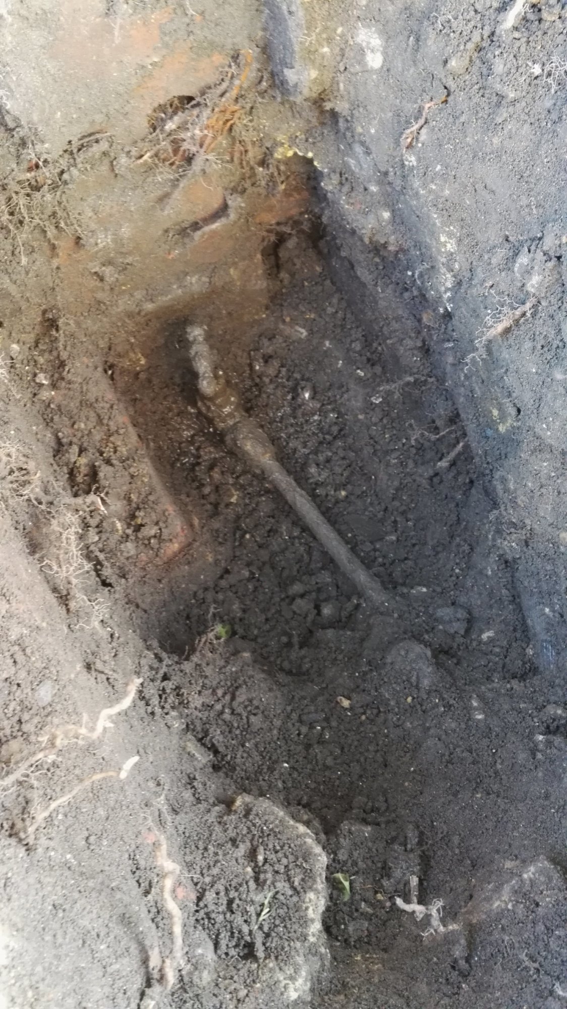

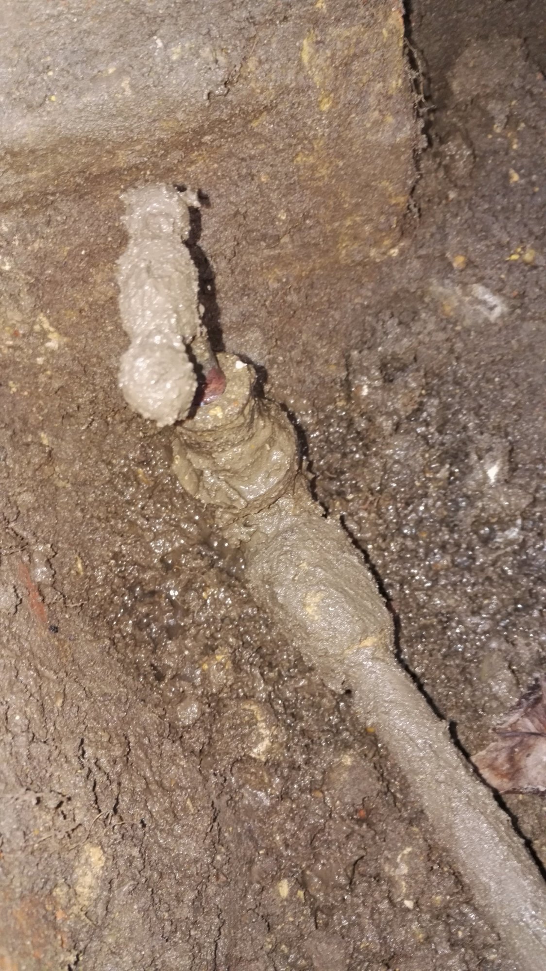

OK, so I have dug out around the stopcock. Below are some pics and a video of the leaking tap.
I sent these pics to a plumber who quoted £250 (incl. parts) to replace the stopcock (I would do the backfilling). Maybe I'm being unreasonable, but does that still sound expensive?
I assumed this was a quick job and I would have a go a doing it myself, but I'd be worried about causing a bigger leak, especially if that is a lead pipe.
so it's leaking (quite badly) round the spindle. I'm not a plumber and have not done many of these. The pipe looks straight and rigid, lead is often a bit floppy, it might be you have a steel pipe.
Sometimes you can tighten the gland nut a little to seal the spindle, I can't make out how yours is made. Stopcock designs are slow to change, and if you can get an identical one, you will find (practice on the kitchen table) that the "headworks" (the moving parts) can be unscrewed from the body and swapped with a new one. Or you can take the head apart (slower) and reseal the spindle with PTFE or greasy rope, depending on your age. You would find it easier if you had more room to work. A wrinkly old plumber will have done lots of these.

Good work there, well done.
Yes that looks like lead, you are right to be wary of it.
Now the bad news- as i said earlier, fixing the tap may not solve the problem if the supply pipe is lead.

EDIT clean the pipe as well as possible then scratch it with a nail or screw. Lead is soft & will show a shiny grey scratch. Steel is much harder. The bulge at the tap makes me think lead but i may be wrong- if its steel the the risk of damaging the pipe is much lower (as is the scrap value)

Sadly that's not the kitchen on the other side of that wall - that's the pavement/road. So the mains stoptap is only about 3-4 feet away.
The kitchen is in the other direction - behind me as I'm holding the camera. That pipe almost certainly runs under my front garden (about 10'), under my hallway/front room (about 20-30'), then under my tiled kitchen floor (about 20') before it reaches the kitchen tap. So replacing the pipe would, I guess, cost me thousands. I'm going to have to save that for a very rainy day.

the flow will be restricted because I think you have a half-inch steel supply pipe. I think that's a screwed steel collar, it's not a wiped lead joint.
