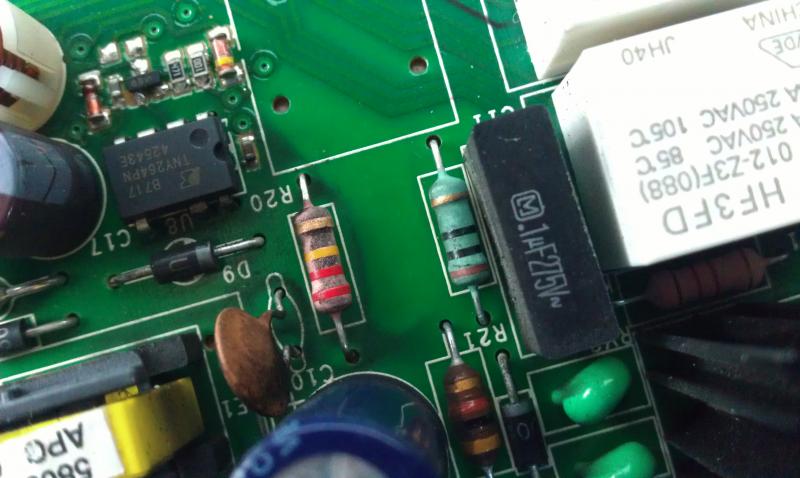

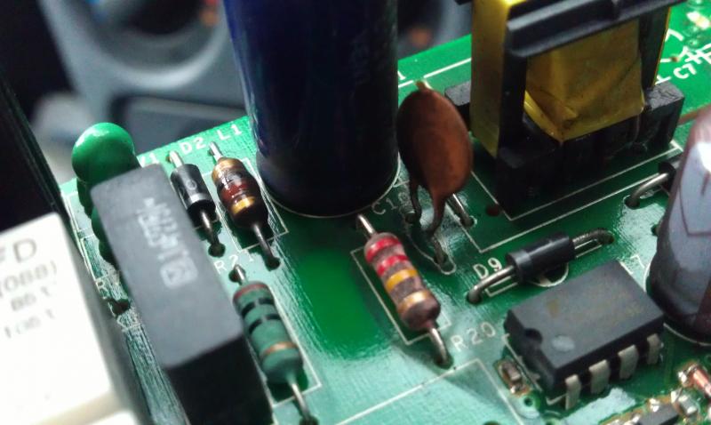

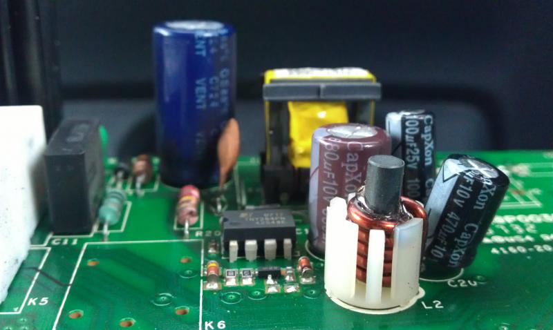

I have a WT741 that at some point, I think just before the final spin it stops and shows Err01. Probably a main PCB board fault so I checked connections, all seems ok. I've taken the board out C17 cap seems ok. I noticed there was a lot of black dust/smoke around a couple of resisters R20 & D2, maybe there is some issue here.
I have attached pics.
Thanks in advance
Darren
Check motor brushes poss worn if they are ok then pcb is history . Emw do recon pcbs for £45.00.

Just to let you know, my washer is fixed, thanks a lot, you've saved me a lot of cash. I cleaned up all the connectors on the main board, checked all was secure in the connector blocks and roughed up the brushes, the misses is very happy :)
Thank you so much to everyone for this. I have the WD440 and got the dreaded flashing lights (all of them). I replaced the C17 capacitor and hey presto all gone.

Brilliant fix from greggy- as a complete novice who hadn't soldered for 20 years since being at school I achieved a fix.Capacitor 39p from maplins and they had a soldering kit with iron,stand, solder and desoldering pump for £9.99.Cost a tad over a tender versus the £100ish a callout and fix would have cost.Thanks very much.
I cannot thank you enough Harry and everyone for this post! I replaced C17 as recommended (with a higher rating cap.) and the machine works perfectly.
