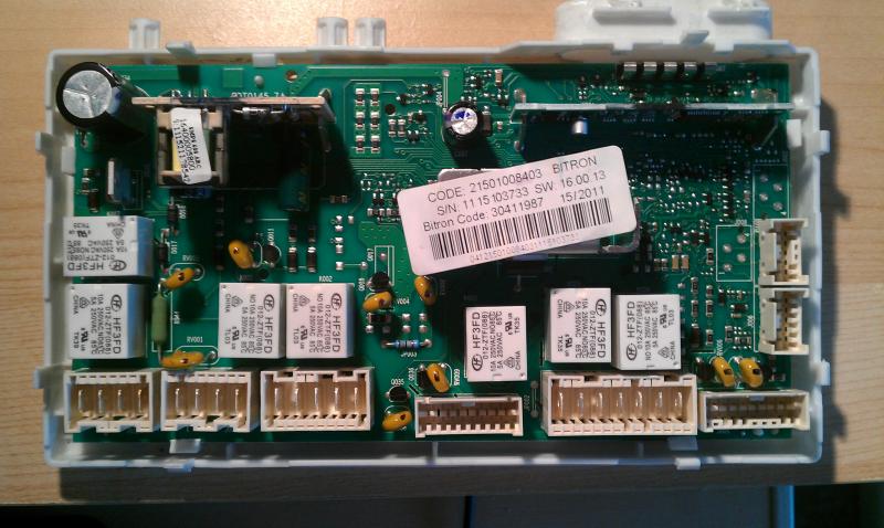

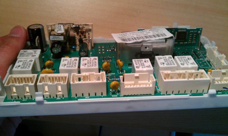

I've got a Hotpoint WDL540 which has the xmas lights problem. When one first starts the washing machine, it goes through the commotion of attempting to wash, then few minutes later it stops rinse mode with the issue.
Have taken out the PCB as per the advice, but cannot see a C17 capacitor. PCB looks different to what everyone else has uploaded, though everyone has different models of washing machine. Have had a look around and all capacitors look fine, i.e. no burn marks or bulges.
Anyone have any other suggestions? Thanks in advanced. Photos are below.
30 month old. Fault - worked fine sometimes, all lights flashing sometimes, sometimes failing in mid program. Several sites suggested it was the main PCB at fault.
I decided to take a good look at the PCB first, rather than chase a replacement. Round the back of the machine, you remove a small oval plastic cover, remove the self tapper below it which retains the PCB's casing, then take off the much larger belt/motor access panel too wiggle out the PCB in its white case. Take careful note of what connections go where as the unit is unplugged.
C17, a 680uF 10v electrolytic cap had some mild signs of swelling on top, so I replaced it with new 1000uf 10v from my stock. Which has completely fixed the problem.
Obviously I'm not sure whether this was a one off faulty capacitor on our machine, or whether it might be more widespread. If a design error it might be better to replace the 10v electrolytic with a 16v version.

I have a hotpoint WDL520, and from the electrical website I went to it seems to be a Mark 8 board.
It will fill the water as per usual, and then it waits a moment... It fills up water another three times in short bursts, and then all the lights start flashing.
I can switch it off and on and pump the water out, but the lights will come on as soon as I do a wash. We have been using the washing machine solid for 2 years, and probably only used the dryer once. On the board there was some black dust on a few bits on the board. I will see if I can put some pics on later.

You got error f01. Motor Triac fault on pcb. Check the motor brushes for wear. Otherwise pcb is shot.
I checked the motor, cleaned it up and still nothing.
Ordered a new PCB and all was well again!
