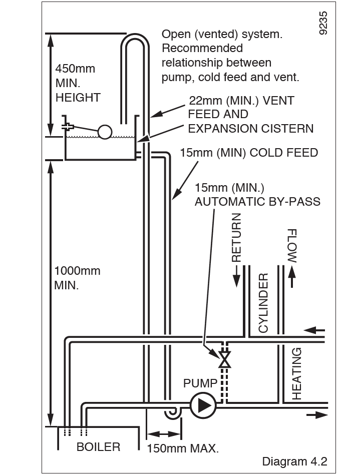

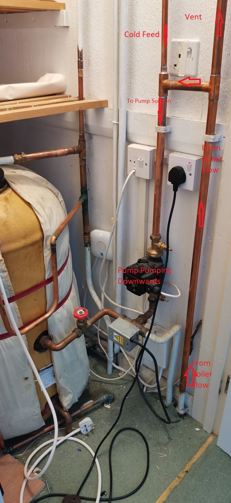

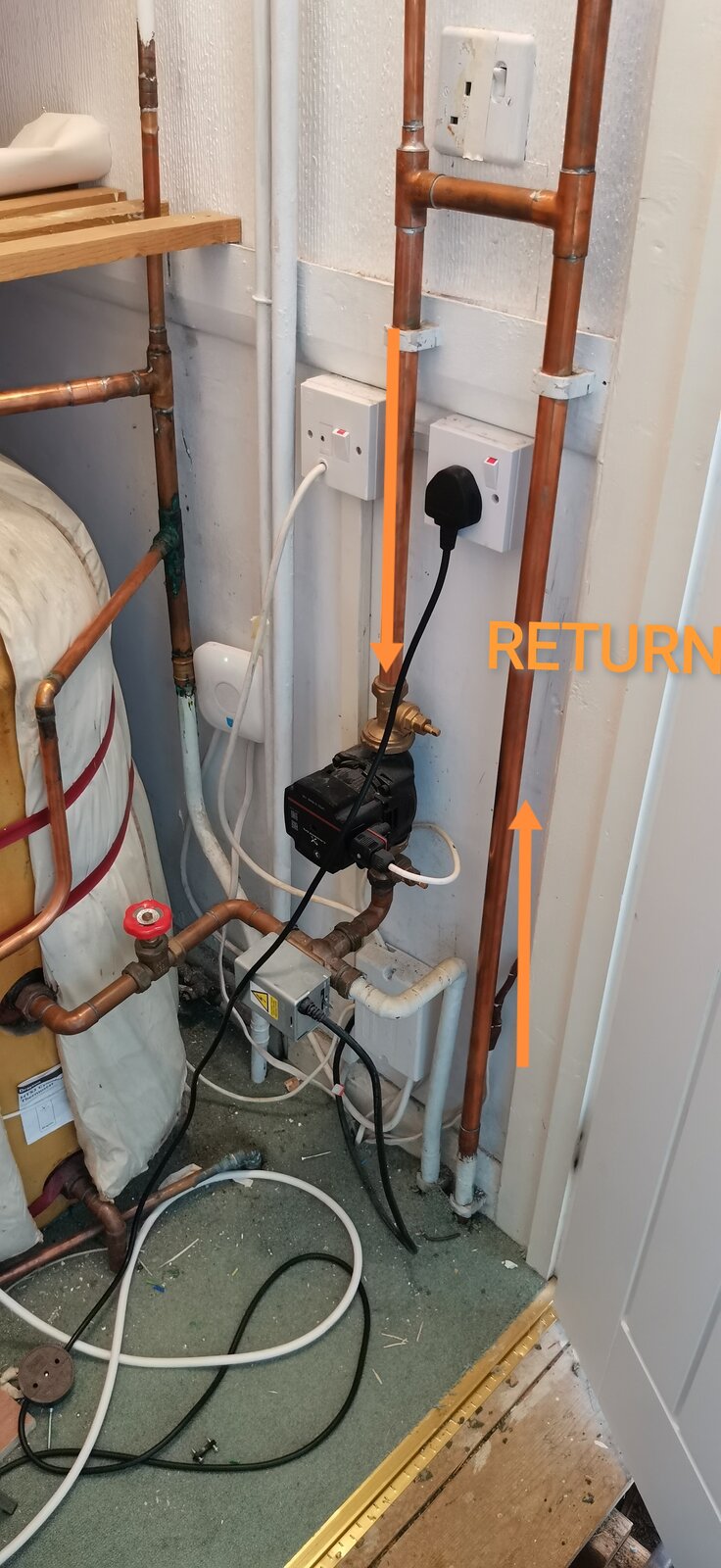

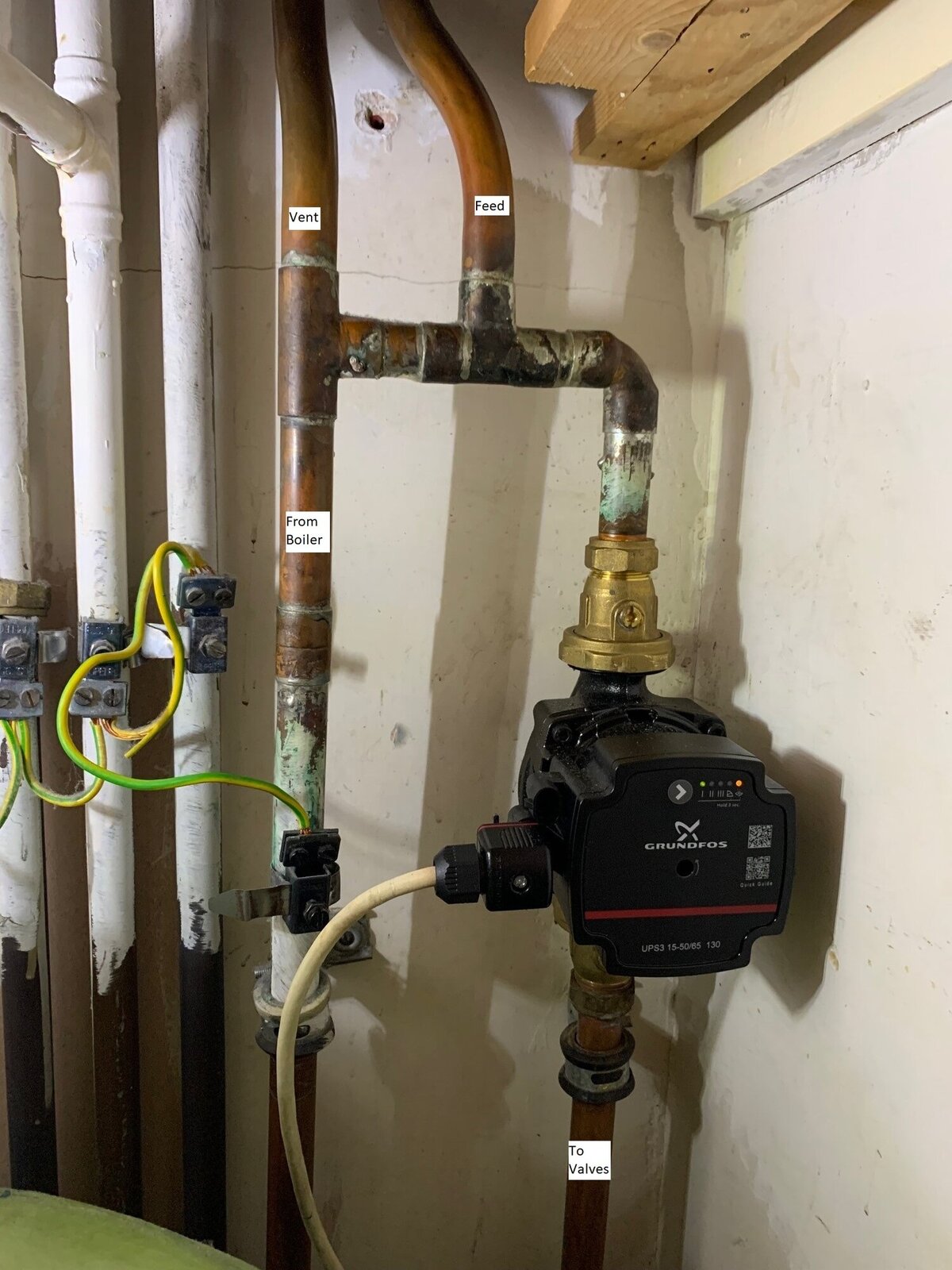

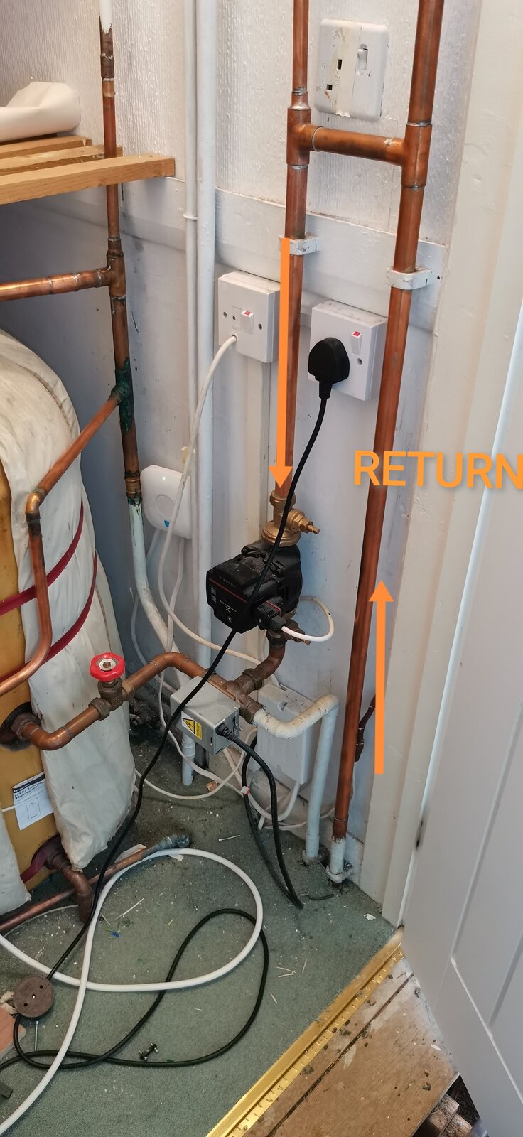

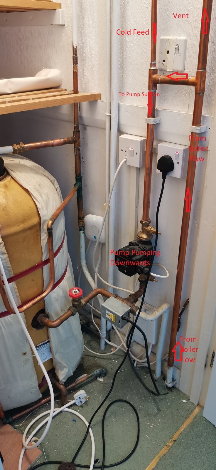

Simplified schematic of your type of system and photo of a system showing pump pumping downwards.

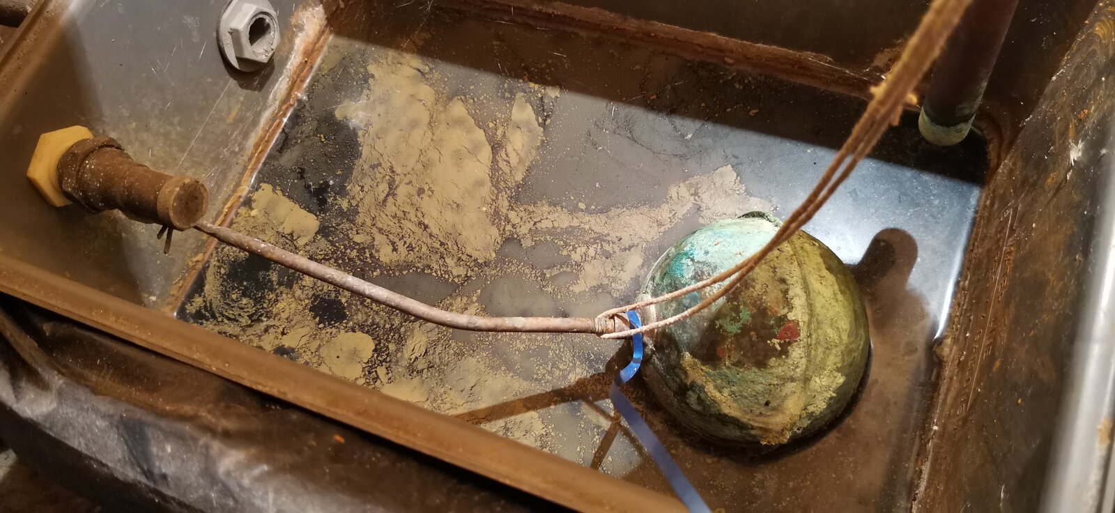

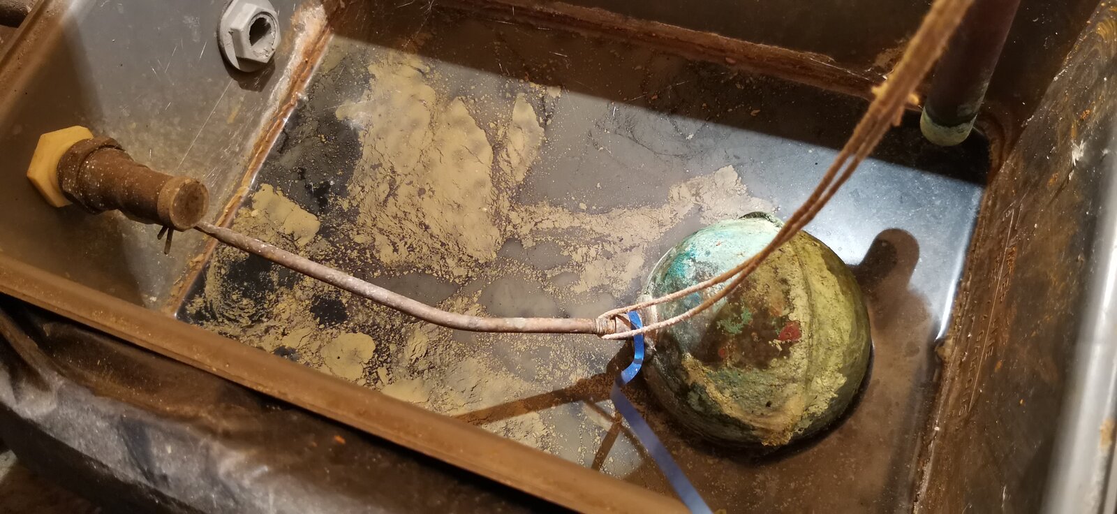

Had the plumber over who moved some pipes in the garage to check his work and says the flow and return are connected as before this is not to say the system was possibly fitted wrong in the first place, He thinks that the flow side has a blockage that is causing the return side to heat up first and because the pipe run is shorter now the boiler is over heating faster and shutting down and is recommending a power flush, whats the going rate for a power flush these days ?? ... Re the F&E tank, that was emptied about a year ago and cleaned out and now looks messy.
And yes on heating or water we get water via the vent pipe as in the video. Do you think a power flush is the correct thing to do ?

Can't second guess the plumber if he says flow&return are connected correctly but quite surprised that the return heats first, if so.
If only you could get someone to trace the pipe where it says "From Boiler Flow" down through the floor and verify that its from the boiler flow.
If you run on HW only, does the cylinder coil feel hotter where it comes out of the cylinder bottom than it does at the coil top entry (after mid position valve) ??.

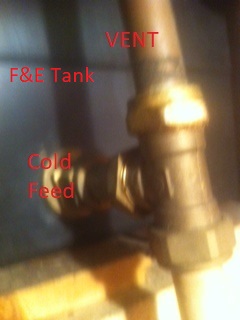

There is only one almost 100% guaranteed way to stop the vent carry over (short of going fully sealed) and that is to combine the vent with the cold feed like my 50 year old system, the cold feed should be in 22mm as well and the cold feed should be blanked off at the connection, at top, left side of the "H" above your pump.

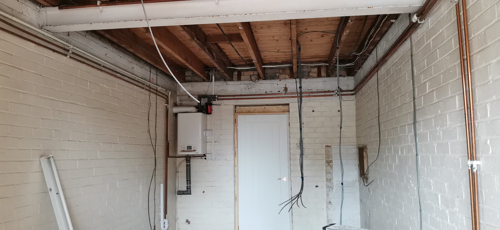

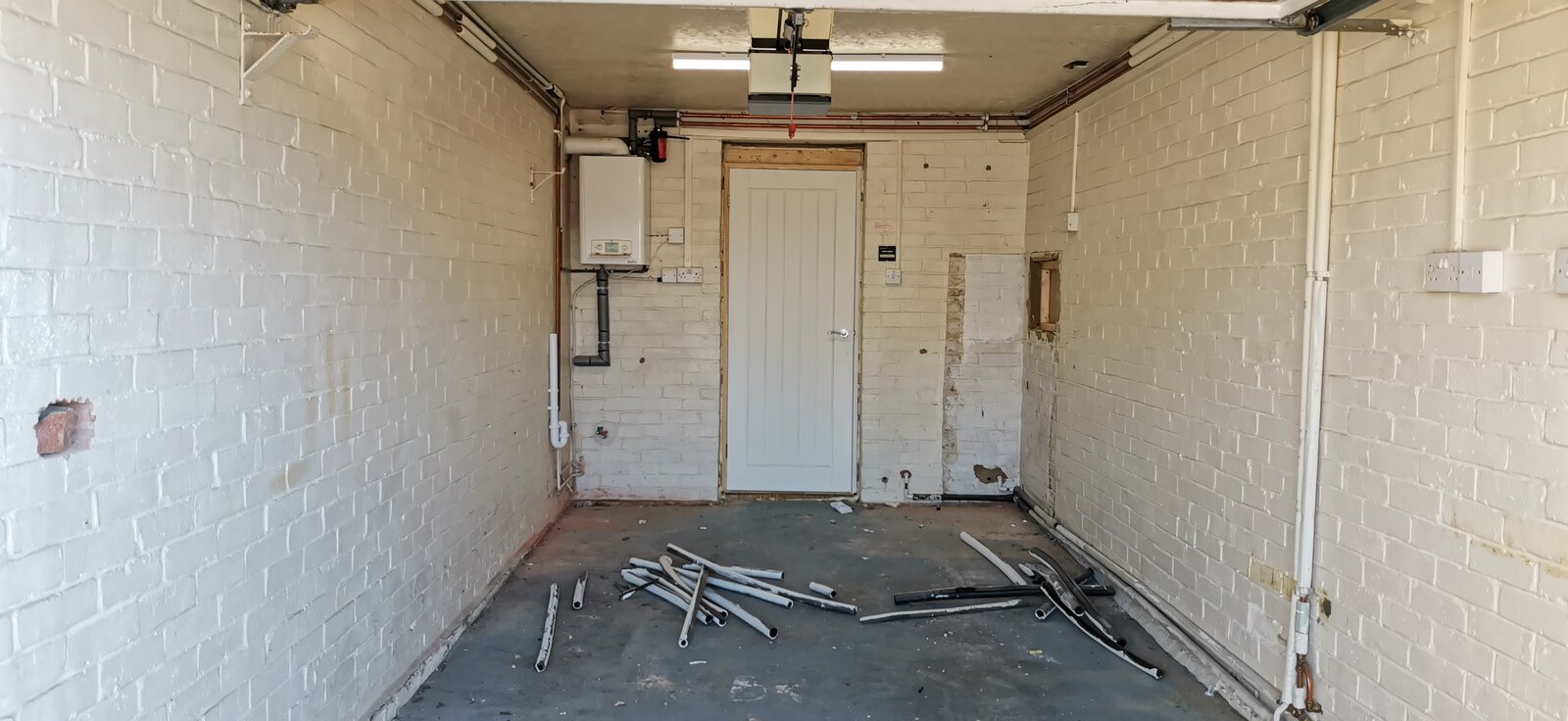

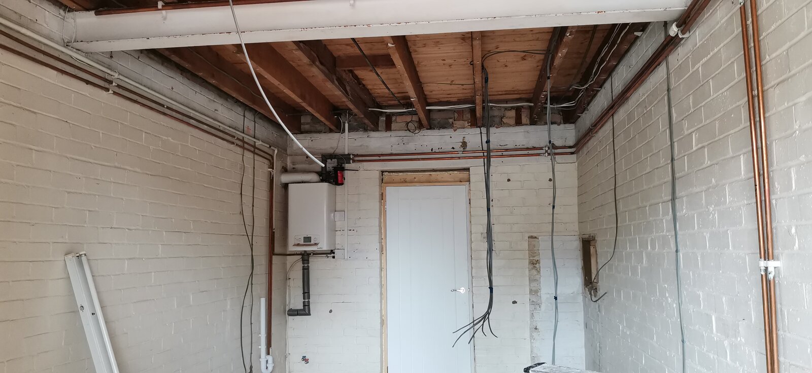

Im in the middle of having a garaghe conversion and some of the original pipe work had to be moved this seems to have caused an issue that the boiler now cuts out after 10 minutes with F22 and F25 codes and im not getting any air from the rads, boiler is silet when it runs but will stop and start.

Yes,
F22 which is derived from the developed pump head (power) and F25, too rapid temperature rise are both indicative of poor circulation.
I would, once again?, feel the two pipes above the garage door (not at the boiler) and see which one is the hottest after say 5 minute continuous boiler/burner operation.

Plan to try and lift some floorboards today and track the route of the pipework.

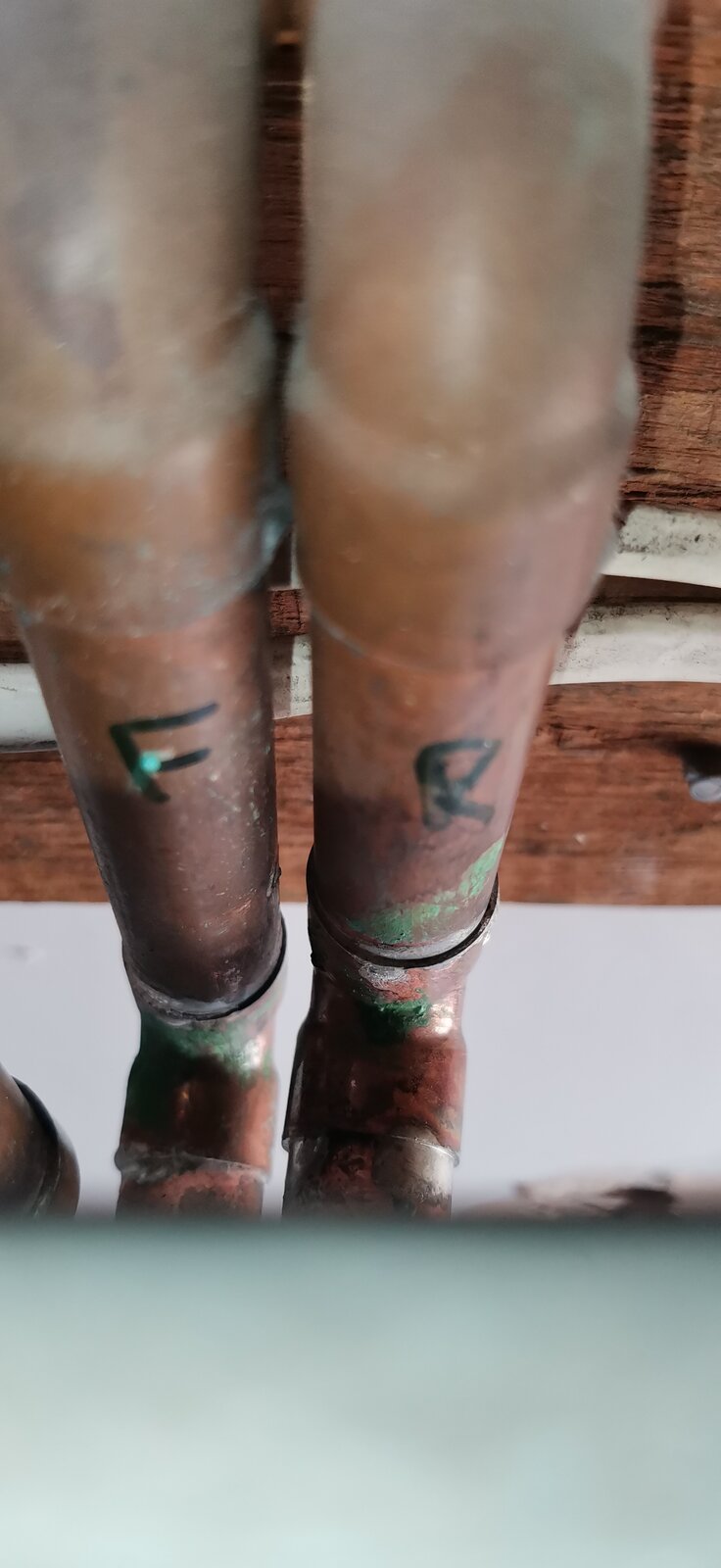

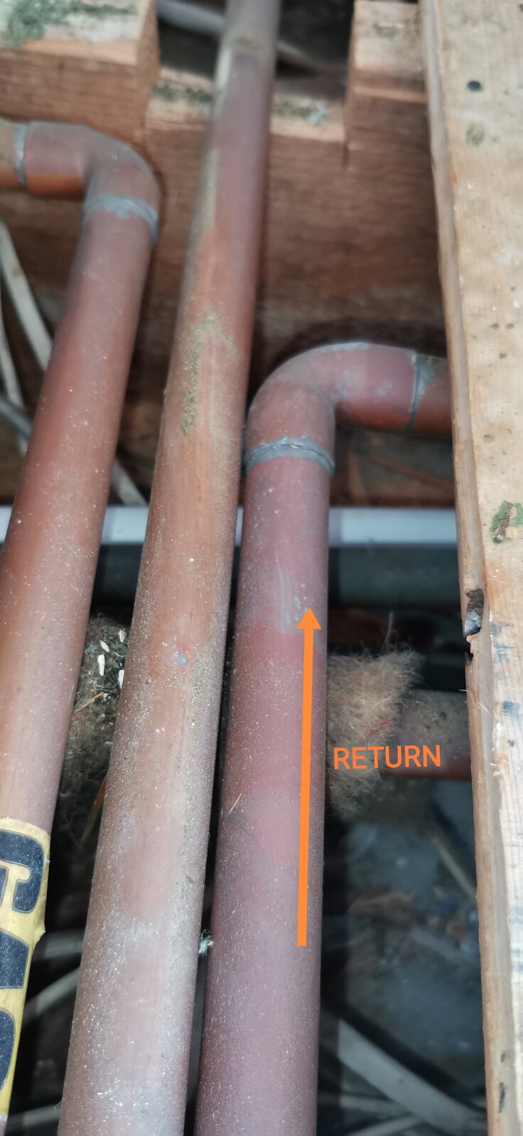

The plumber says the F&R on the pipework is from the original installation.

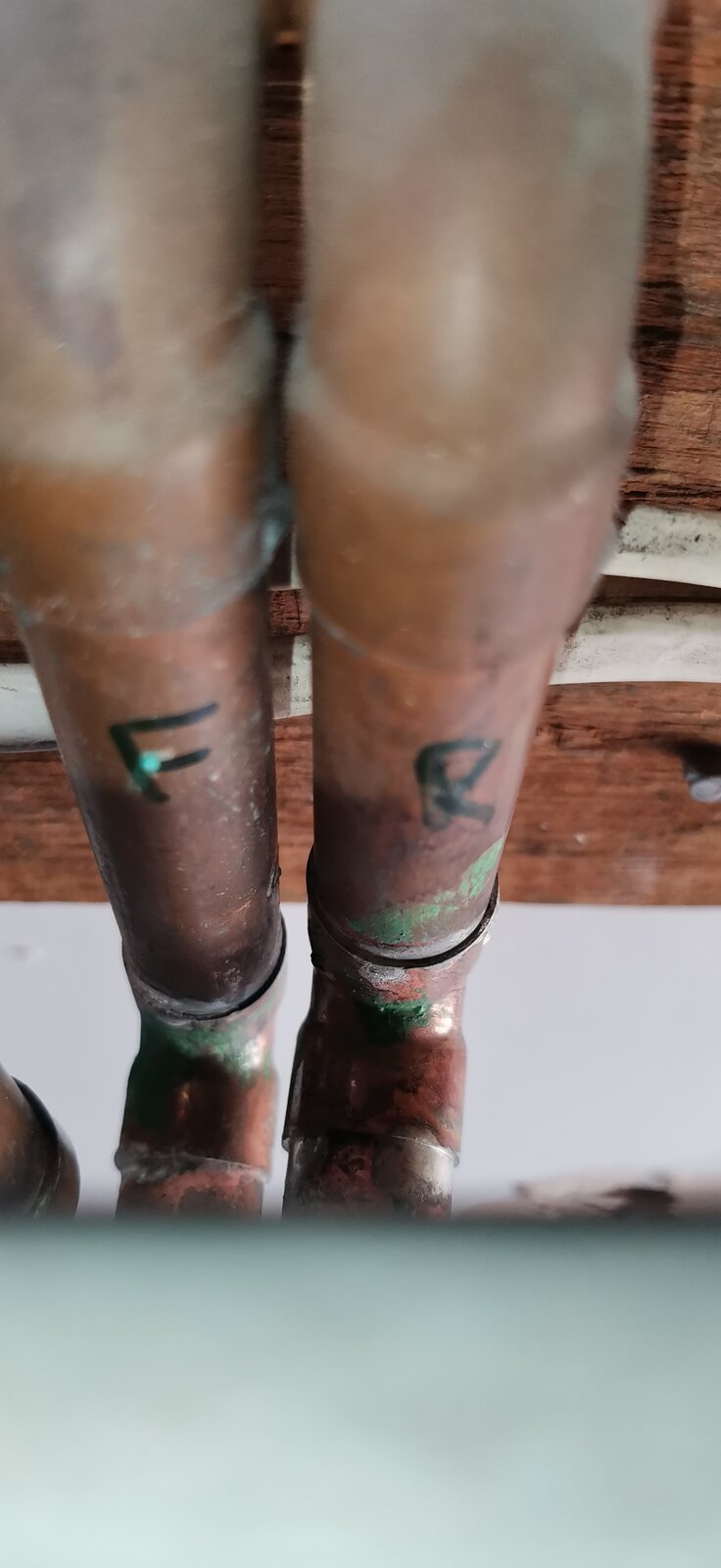

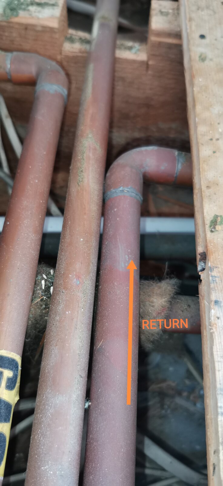

Got to be very careful with description here.... in the bottom photo, above, is that pipe connected to the boiler return, ie the one marked R on the boiler casing???
d R U
Yes the pipe marked R is connected to the return on the boiler but the pump Flow is in the opposite direction so I would think the flow and return pipes need swapping round.
This could be your eureka moment but just to persevere a bit more, this pipe which you say is returning to the boiler "R" must be doing so via the magnetic filter?
If so then remove this pipe from the lower filter connection and connect it directly into the boiler flow (F), connect the other vertical (NOW return) into the filter bottom and connect another bit of pipe from the filter top and connect into the boiler return (R).

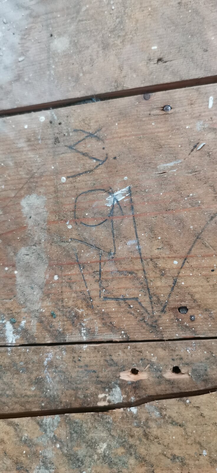

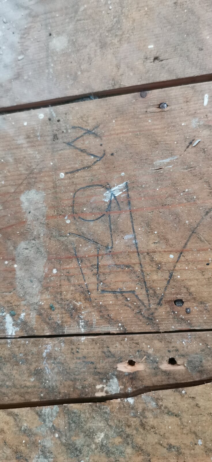

Yes the return pipe is going via the filter, also marked on the floorboards next to the return pipe I found this.
The plumber is on holiday next week but fingers crossed this will sort the issue and come winter the boiler will heat up faster.
