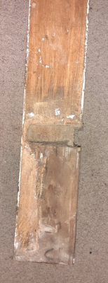

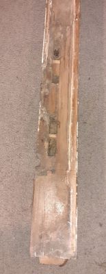

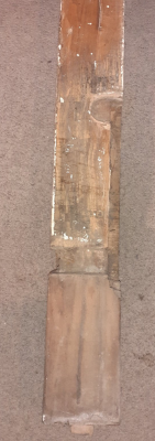

The original would have been mortised and tenon jointed onto the ends of the ends of trimmers and housed and scribed onto the bottom step. The angled haunched double tenon is cut at the bottom end of the stringer, the newel post is angle mortised to accept the tenon and the joint is draw bored and pinned. The side and the front are housed and scribed to accommodate the tread(s) and riser(s). Often the bottom end of the newel has a steel peg inserted into it and also into the concrete, but some don't and depend on the stringers (inside, at the rear) being angle bracketed to the floor out of sight
Then original 1930s Art Deco newel post illustrated below on (L to R) the upper face, inside face and lower face. This one had a square wooden tenon at the bottom to locate into a square tenon in the (wooden) floor

Sorry about the poor quality pics. I'll try to do some better ones later on
The example above was retro-fitted into a Victorian building in 1937. The floor where is was fitted was timber, hence the tenon at the bottom of the newel post to fit into a mortise in the floor.
When doing a retrofit it may be almost impossible to peg to bottom of the newel post, given that you need to line-up both the mortises to the tenons at the ends of the stringers and get the housings in the right place, too. You might want to think about getting the mortises right (possibly converting to a loose tenon arrangement which will be easier to fit), and also the housings, but then fit a pre-drilled flat steel plate to the underside of the newel post which gets slightly recessed into the concrete floor (SDS, rotation stop, chisel) and fixed down after you've gotten the newel post glued up and set. The resulting recess can then be filled with a bit of cement screed. I'd advise against trying to sink the newel post dee[ into the screed - screed really doesn't have that much strength, but I also think you'll possibly encounter problems getting the rise on the first step correct
As you can see from the photos, doing the housings around a newel post isn't a 5-minute job and takes a goodly amount of accuracy and attention to detail

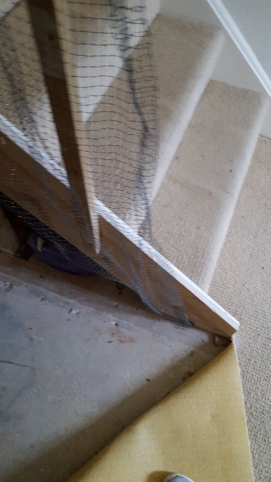

Thanks for that information. I hadn't realised that newel posts are not normally sunk into the ground, they always seem far to solid to rely on the bottom step and stringer for their rigidity; a leverage of around 120cm to about 15cm doesn't seem very good to me.
I've added a photo of the bottom of my stairs, you can see were the wall was and the cement floor. It will need strengthening since it was relying on the wall for added strength, but even with the wall it was still very creaky.
I think these stairs will be far to weak to hold the newel ridgid, it looks likely I'll have to make it up as I go along.

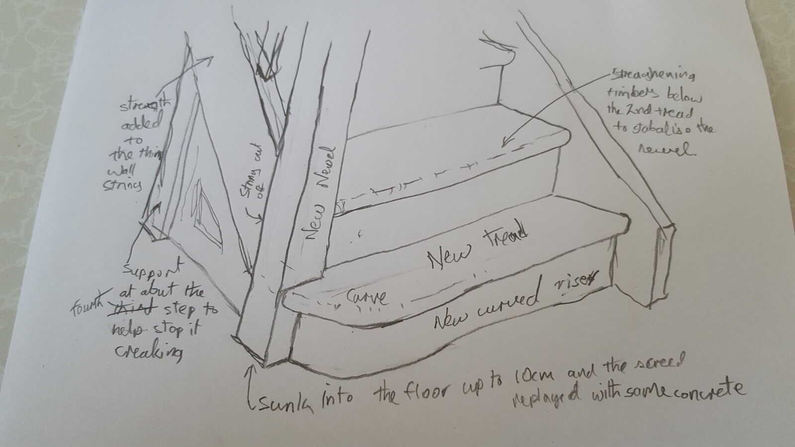

I had a think about it and have come up with a plan, though I'd run it by you if that's OK; I'm no expert.
I thought I'd put the newel back and through to the second tread for more stability and replace the bottom tread and riser with a curved one for apperace.
With and added timber fixed to the wall string, support for the stair at about the fourth tread and timber support below the second tread I thought I will be able to fix the new newel firmly from two sides into the stair. If I then sink the newel into to floor less than 10cm and concete around it I can key the bottom of the newel into the concrete floor by say fixing a few screws into the botton of the newel. It should be then very firm and stable.
It all sound a bit complicated so I've done a quick thumbnail to help. Let me know what you think.
Well, there is the pinned tenon, maybe 250mm tall, together with a snug housings to accommodate the bottom step and the extra strength you'll get from where the handrail joins the newel (traditionally a bolt and castle nut affair). Without the handrail joint the newel post is a lot weaker. And all of this gets glued and cramped together as well so it really can't go too far wrong if your joints are accurate
The fixing plate, if it exists, could well be 250mm x 100mm x 4mm steel but there might just be three big screws (6 x 130mm) going diagonally into the floor through the sides of the newel post, with the holes plugged and planed in so they don't show.
As you may have gathered, there is somewhat of an element of make it up as you go along in all of this
Thanks JobAndKnock
Cutting tenons seems a bit to much work to me, I'm more your screw and glue type of person.
I like your idea of screwing diagonally into the floor though, it would save a bit of work digging up and relaying; got plenty of large torx fixings.
The hand rail will certainly add a lot of strength back to front, but it still seems a bit of a weak design from side to side.
I wasn't aware of the bolt and castle nut usual method, not sure how this works, I'll have to look into it.
Currently the stairs is not connected to the floor at all, (i.e. no fixing plate).
I won't be starting this any time soon because of a few higher priorities, but when I do I'll feel a lot more confident of it.
