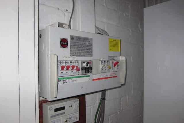

This is the CU (I think that's what it's called):
It seems to be a Wylex WSES 80/2 - some other forums I've read suggests this is quite old.

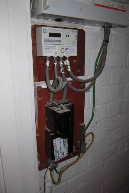

Here's how it's wired into the meter:

b) looks okay but still have a report done.
It does state 16th ed installation, nothing wrong with that but you may find some chancer trying to convince you that a new board is required.
I would check the manufacturers dates of the wylex breaker as there was a recall on them. But likely your board predates that.

Cheers for that :) So I'm guessing the 16th Ed puts that CU at 1991 or later.
There's a couple of NSB06s in there for the lights, so I'd better double-check those!

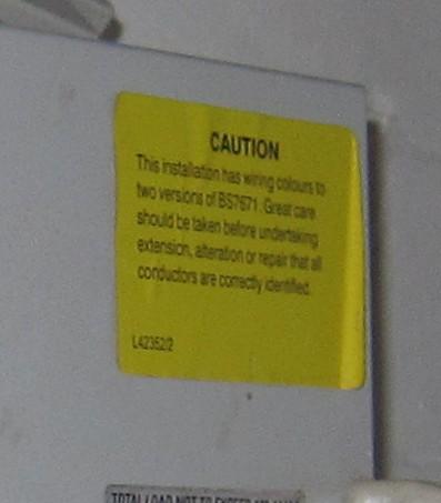

Looks like there has been some additions or replacements, since the board install, as you quite rightly say brown/blue on shower iso, there looks to be a sticker on the board for two versions of BS7671 colours.
The installation of the board could have been done anytime between 1991 and 2008. So contradicting myself it is possible that both core colours did exist when board swap was made!
Justaddwater, I would be asking for a copy of any documentation that exist concerning the electrics, the vendor will have to truthfully state whether any electrical work has been carried out post 2005 and there is evidence that there has been.

Thanks again - I will ask for some documents. You're right in identifying the sticker:

The board is from the early 90s, and the shower is a more recent addition, but it's hard to say for sure what's lurking beneath. This is where your electrician comes in :)

Current Wylex (NSX?) MCB's will still fit quite happily into that board, not too sure if I'd want to try fitting an RCBO in there tho!
