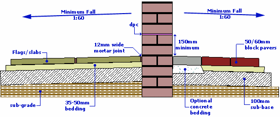

View media item 63070
For a start the paving slabs should be 150mm below the dpc level which is now allowing the rainwater hitting the ground & splashing back up over the dpc :cry:

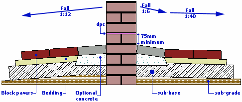

Example,
To get round it below,
Or this way
Or this
You dont need an experts report if you can demonstrate the work has not been carried out with reasonable care and skill (as per the Supply of Goods and Services Act 1982) - reasonable care and skill does not mean a perfect job but one which a competent person in that field would do - i.e a good or average job.
All you need to demonstrate is that he has done a poor job - one problem is that there is no legal standard for patios - so all you can do is rely on best practice. Some things are very easy to criticise - such as the lack of a solic base, the weird slope and the pattern.
Essentially you will need to balance the cost of the work he has done against the cost of having it put right to decide what to pay him.
As others have suggested - if the contract is definitley dead I would pull the slabs up now - ideally you should give the original tarder a chance to rectify but if this is not going to happen then I wouldn;t let the slabs set.
