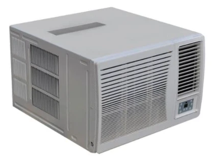

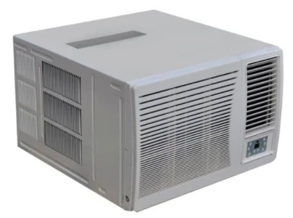

I know working abroad for many years the heat pump was the same, all AC's seemed to be a standard size and fitted in boxes in the wall upload_2021-9-28_4-4-53.png it seemed all a standard size and you could mix and match makes. Although some did reverse motor to heat, many used elements for heating, but main point is it was not central heating, but individual units for each room.
It does seem silly to have a cooling and heating system split when the heat transfer unit can work either way, so the first thing would seem all radiators need swapping for fan assisted, heat raises so heating units tend to be on floor, cooling units on the ceiling, but with fan assisted it does not matter.
Under floor cooling does not really work, so under floor heating is really out, as will only work in one direction.

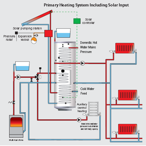

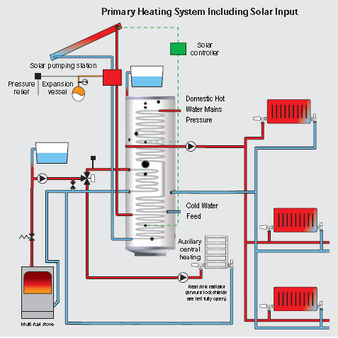

To heat water all we need is an immersion heater, and if we have a transfer tank, then we can have multi fuel Torrent pipe example.PNG to be frank my father-in-law had solar water heating in North Wales and it was a flop, daughter has it in Turkey and it works well, at what latitude solar heating stops working I don't know.
