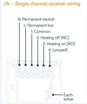

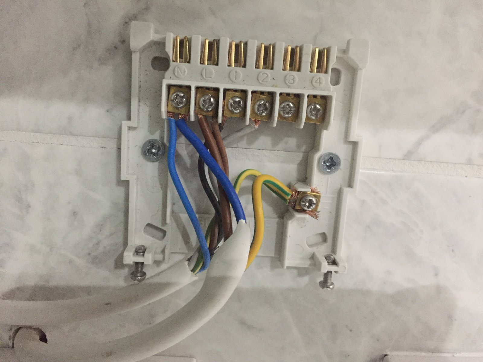

I have got hive1 and it has been wired wrong, my central heating won't turn on through the thermostat, spoke to the engineer and he said a wire needs swapping, can someone please help which wire I need to swap. Currently I turn on heating manually through the boiler itself. i have got Vaillant ecotech pro 30.
