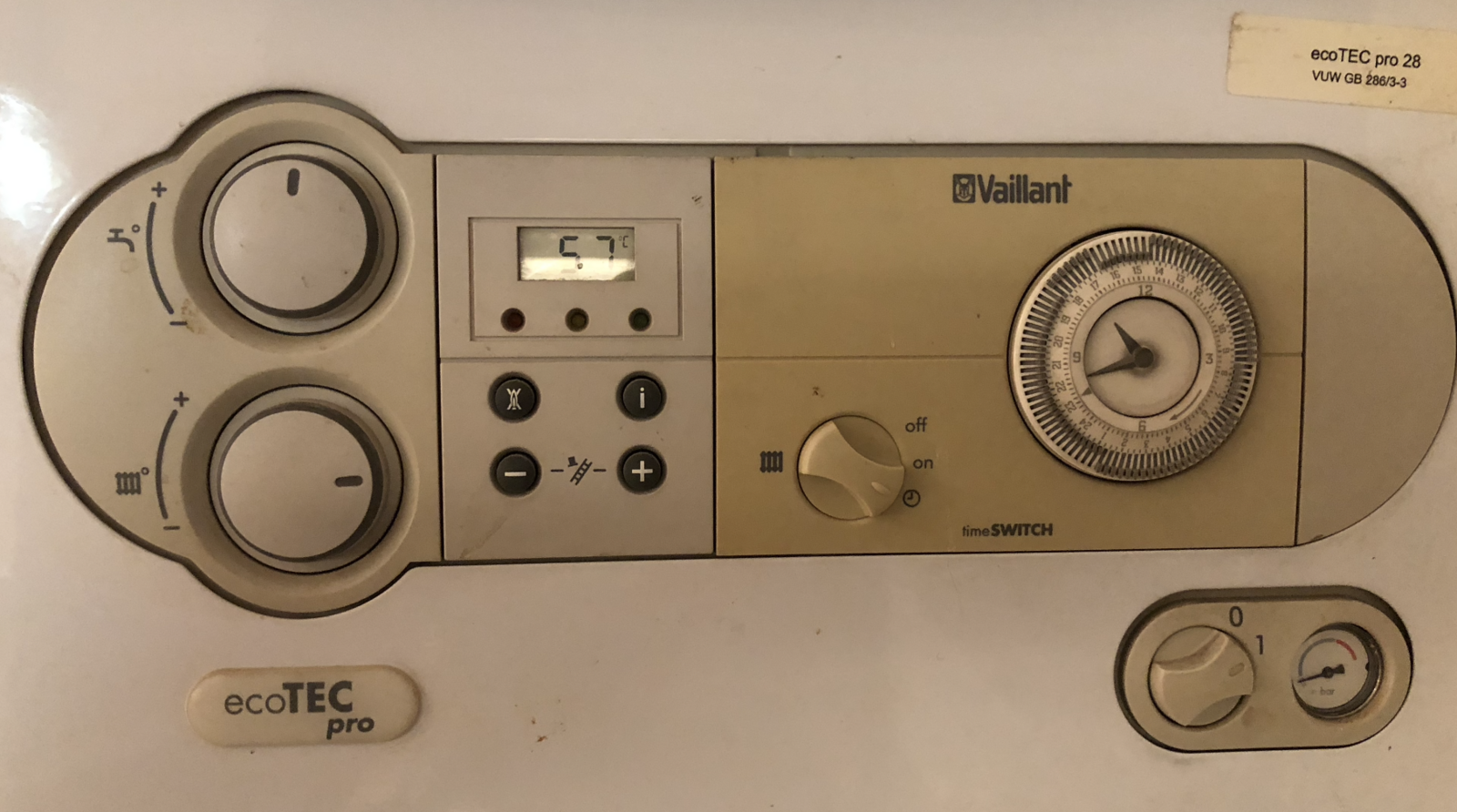

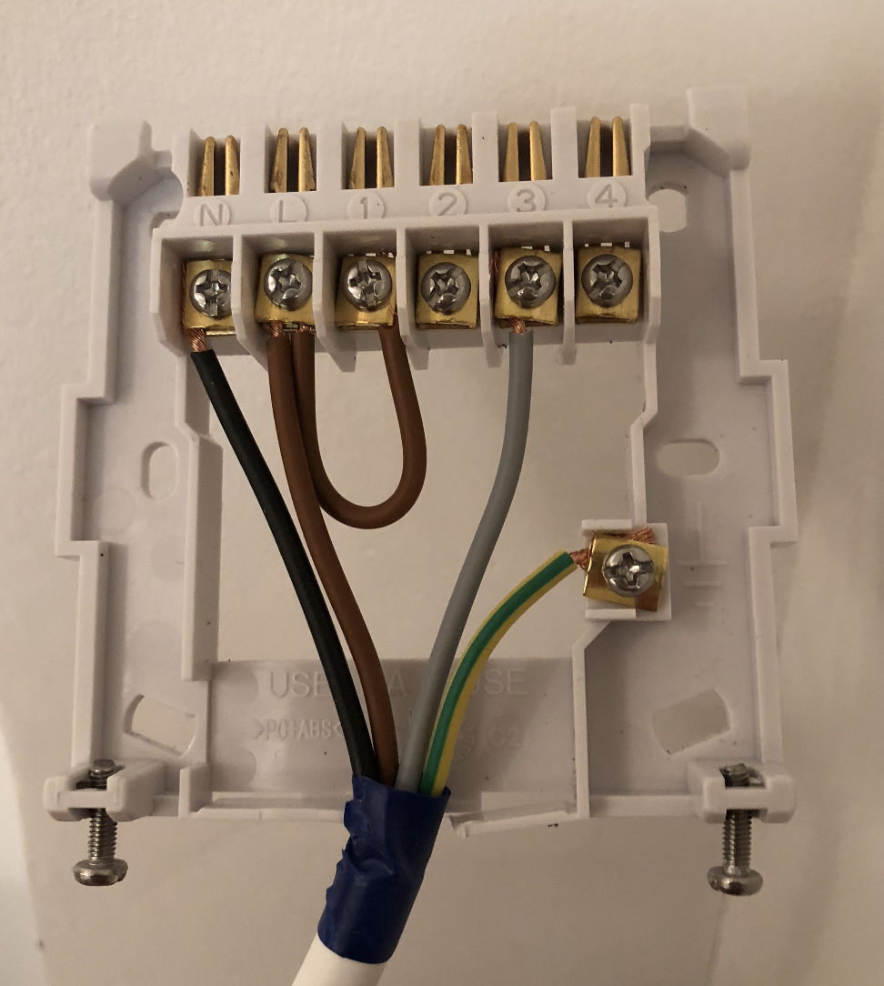

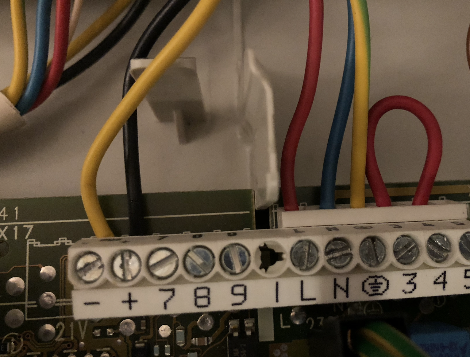

Hi All,
First post here, and one of many switching to wireless technology.
EcoTec pro 28, slightly older model (still mounts a - slow - analogic timeswitch 150) I intend to install Hive wireless.
See pictures below of receiver wiring as well current circuit board.
If I understand correctly, I can leave the receiver wired as it is, and on the boiler itself:
- remove ebus black and yellow wires (current wall thermostat VRT50)
- remove bridge on 3&4
- connect L, N, Earth as usual
- Connect grey cable in 3 (receiver) to 3 in circuit board
Is that correct?
Is the bridge on the receiver ok between L and 1 or shall I mirror the original diagram in this thread (from CNSam) and use five cables, have 1 (receiver) connected to 4 (PCB)?
Laslty, shall the heating dial be 'on' or on timed, when I switch the boiler back on?
Thank you so, so very much.

I believe swapping to Hive may cost more, as the Vaillant control will work better for that boiler. What you are proposing is fine, apart from 3 is live out on that boiler, so your heating on (grey) would go to terminal 4. If you plan to use the Hive’s timed programmes, then select time switch 130 (150 is the newer model) to permanently on. Also that boiler cover forms part of the combustion circuit and should be tested afterwards by a competent person.
Many thansk Chris, much appreciated.
When you say 'apart from 3 is live out on that boiler, so your heating on (grey) would go to terminal 4' you are suggesting to leave the connections on the receiver as they are except the grey cable, to be moved from 3 to 4. Correct?
Thanks!
