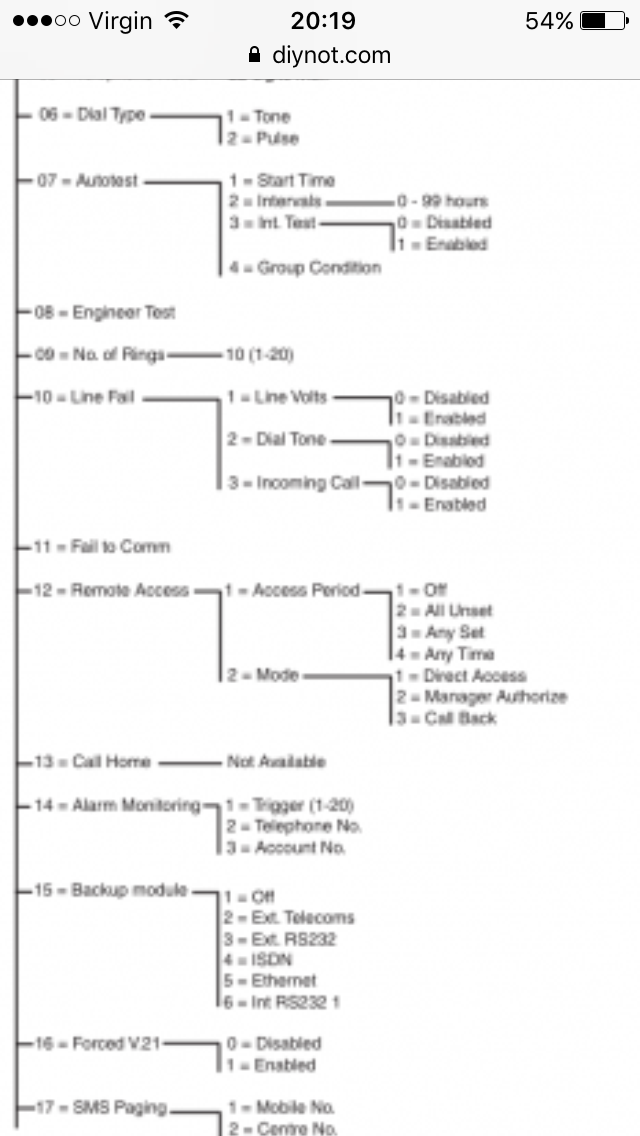

Hi guys, anyone know what STU line failure is?? settings keep aborting
Put in 1234 ent
Ent again then option 48ent
0 is doable
1 is enable
Press 1 ent
Then engineers code
Then option 56 comms
Ye that's right press A should say enable press ent then escape then put in engineer code
U need to turn off coms
