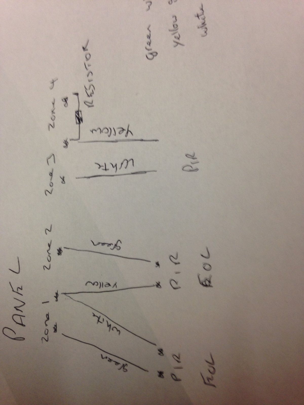

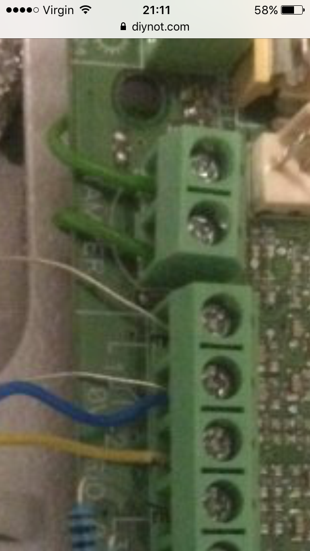

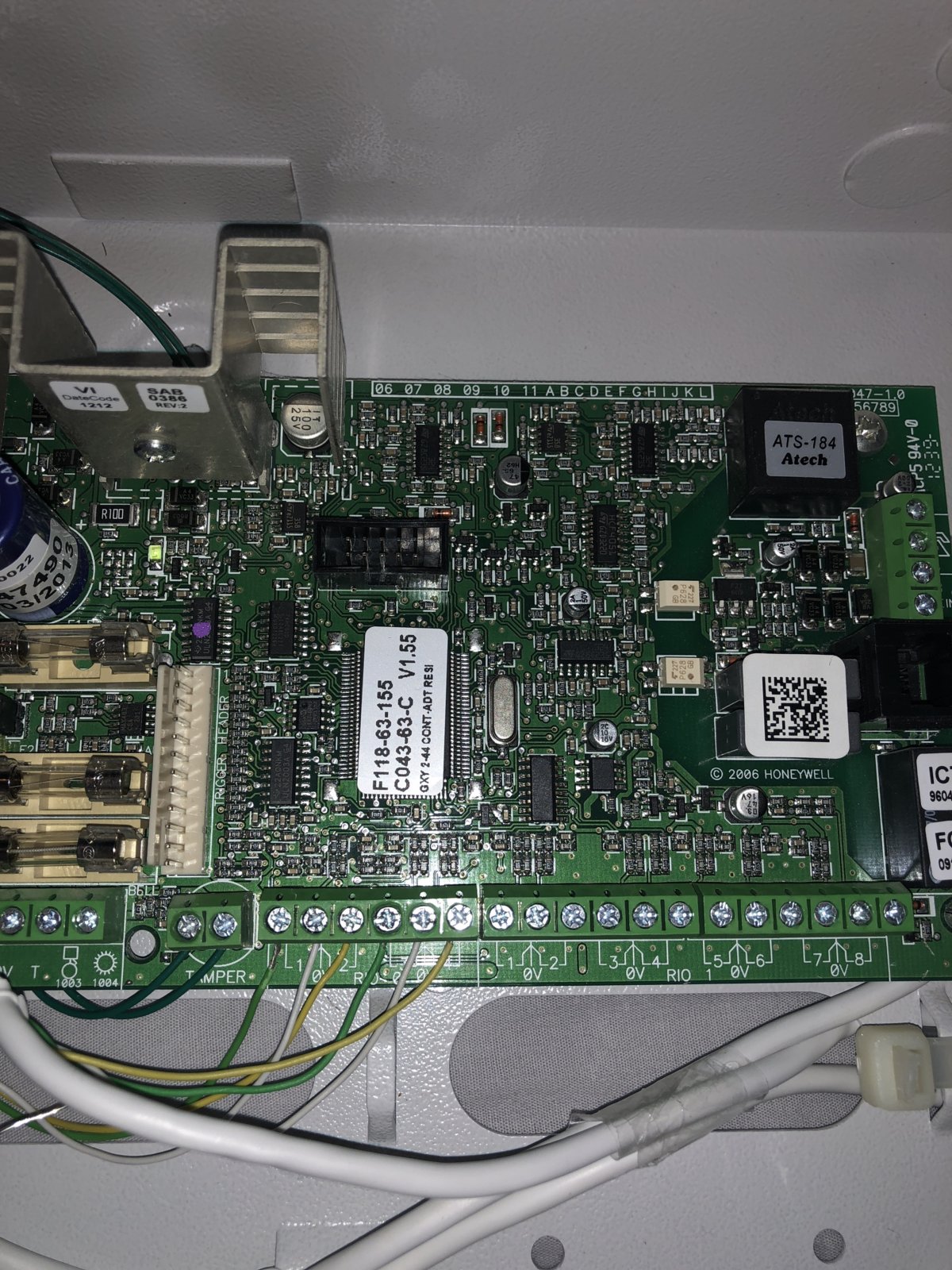

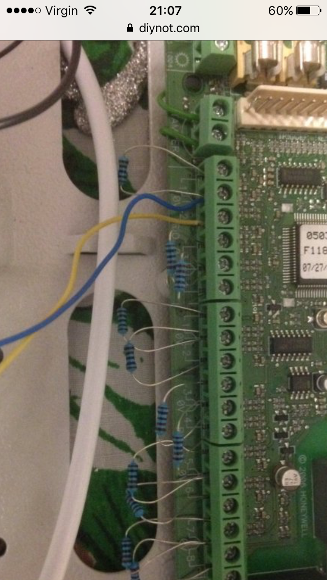

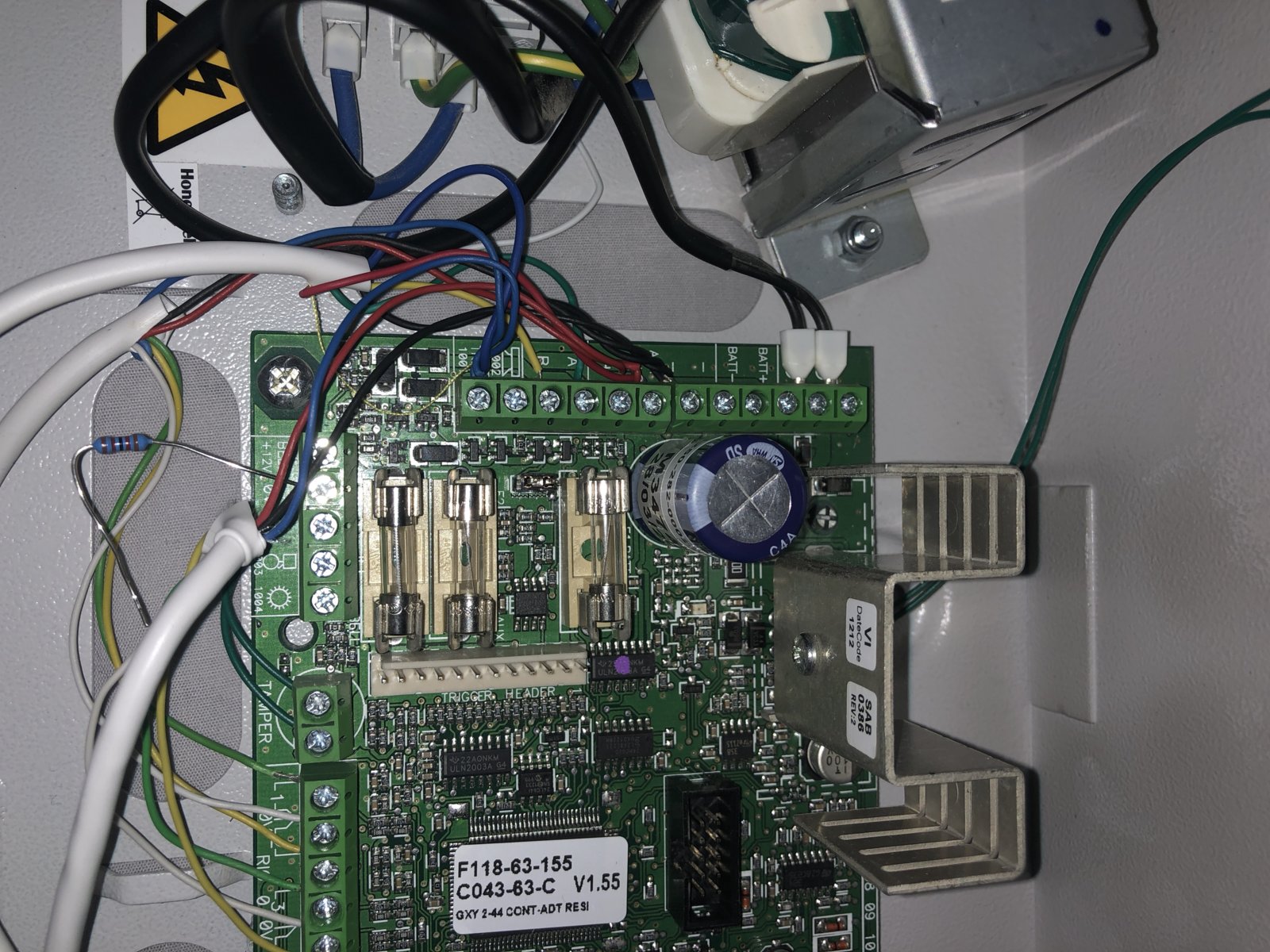

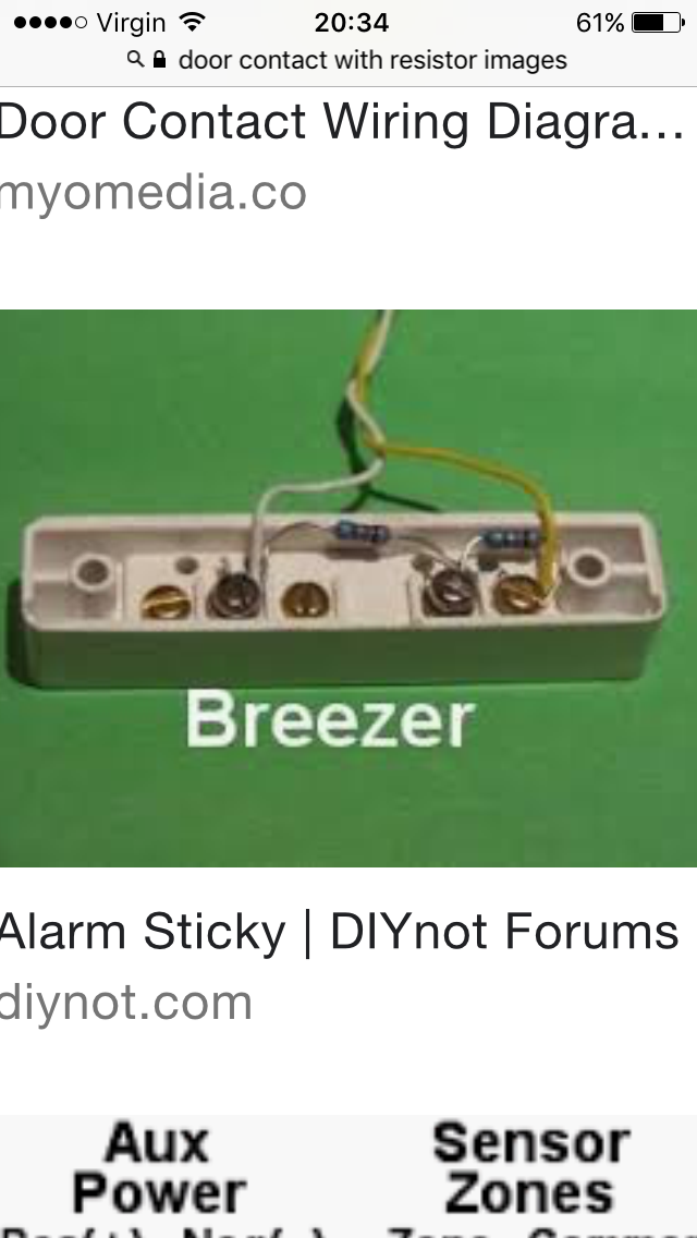

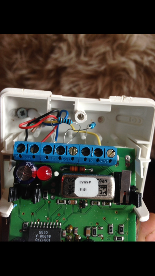

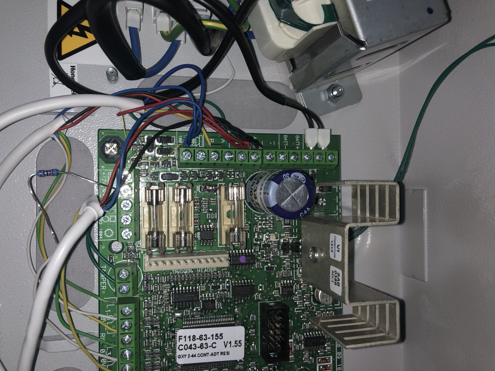

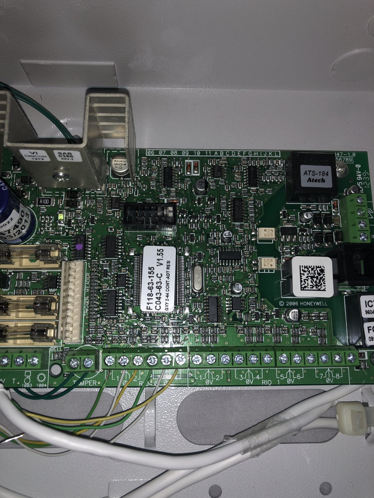

You can set zones as not used so if u r only going to be using 4 you can set all others as spare but you will av to put resistors in pirs and door contacts
Ok so you will need eol in pirs but your zones are wired wrong
So if your first green and white is zone 1
Yellow and green is 2
White and yellow is 3
Leave green as it is
White and yellow twist together
And then green on its own
That is zone 1 and 2 in the first 3 screws
Then white in next
Yellow twisted with a resistor next
Then resistor on its own
