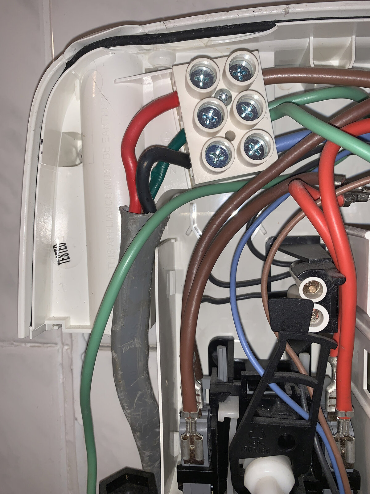

Hello
the current Mira 7.5kw shower is packing up, plastics has cracks and replacement parts are hard to find and so we thought we should upgrade to a 8.5kw shower. it has 40A mcb on the fuse box.
how do i measure the existing shower cable, the prints on the cable are badly scratched so i cant read what it says. do you measure the outer grey sleeve or individual wires?
thanks guys

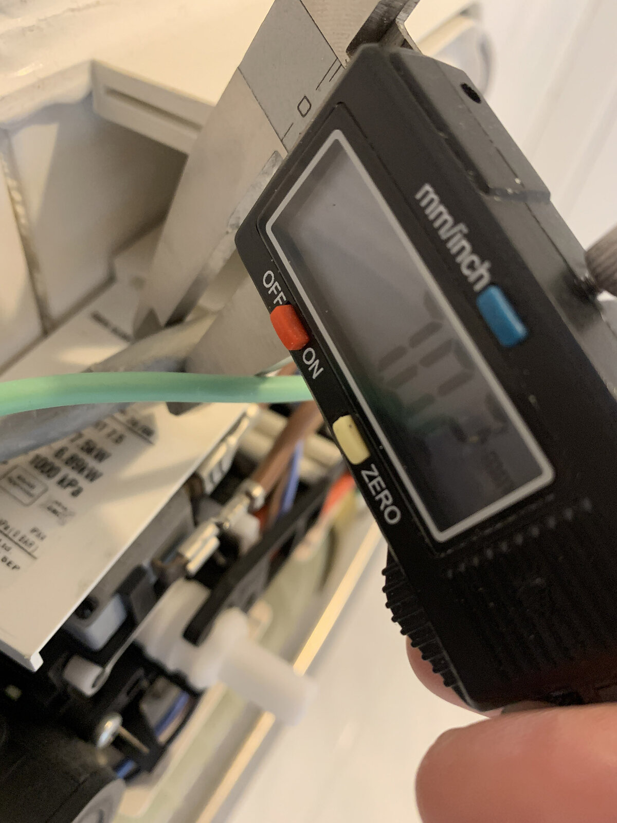

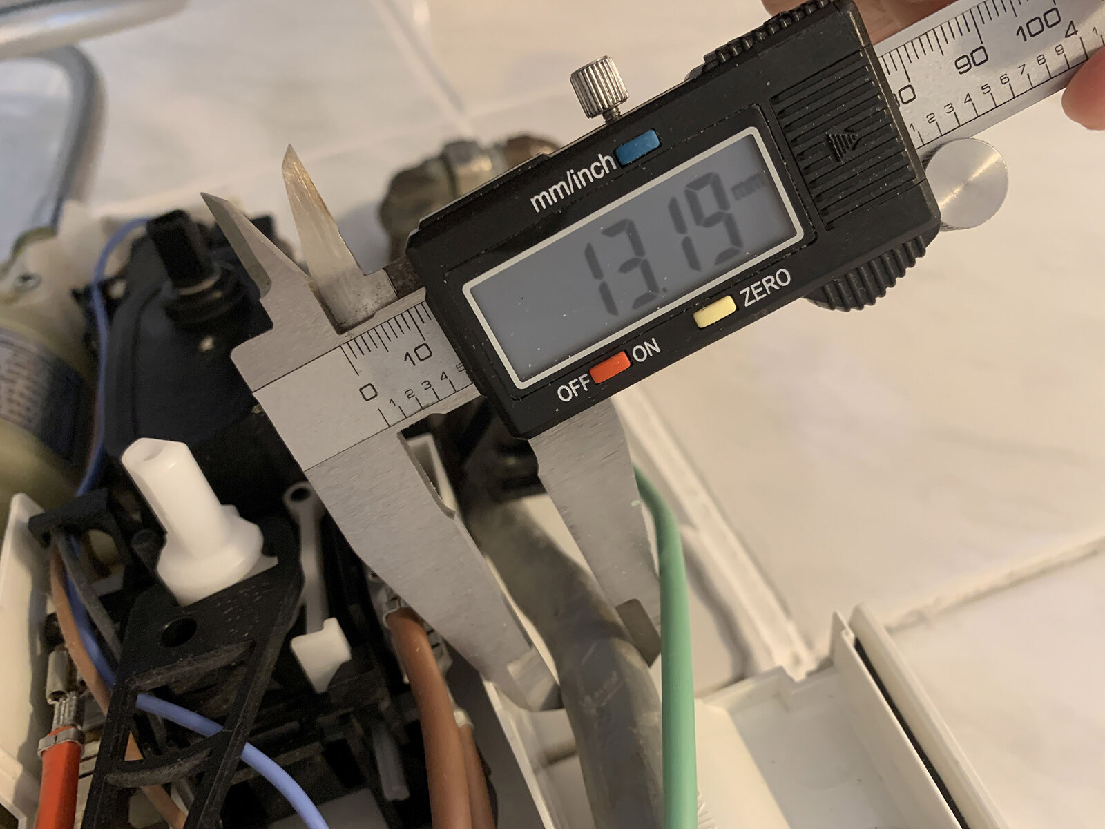

13.19mm x 7.02mm
does that mean it has 6mm cable?

Why don’t you measure the copper core with your gauge and calculate it as I have already explained? Much better than guessing using the sheath measurements.
Edit. Just noticed picture
Not a fan of using Metal calipers on Electric cable.

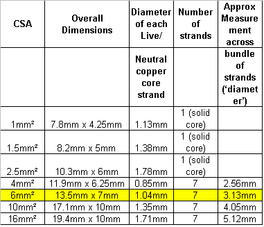

I don't know where this table originated but generally it seems to work
why not, if the power is off from the fuse box. i've already checked with a multimeter.
I think its potentially dangerous.
I would want to be 100% sure I had safe isolation before using a metal caliper on an electrical cable.
A multi meter is not an 'Approved' voltage indicator
It is difficult to know if a multi meter is working, or it could be on the wrong setting.

That - 1.04 - is the same as in the wiki link I posted, although both should actually be 1.09mm.
Edit - I am wrong. The figures are correct. Sorry

yep, i think mine its 6mm. it has 7 copper strands and 1mm each copper strand. 13.19mm x 7.02mm grey sleeve.
so 8.5kw could be fine. but just to be safe i gonna find another 7.5kw shower to replace with as i dont want electrician to replace the cable to higher rating as it will cost a lot of money..
