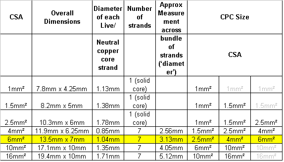

how to measure existing shower cable?

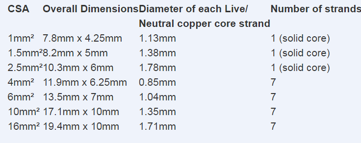

That - 1.04 - is the same as in the wiki link I posted, although both should actually be 1.09mm.
Ah ok, it is somethig I've had saved on my laptop for a while, I've not tried verifying the values. In fact there are CPC columns too but I'm sure it needs updating.
so 8.5kw could be fine. but just to be safe i gonna find another 7.5kw shower to replace with as i dont want electrician to replace the cable to higher rating as it will cost a lot of money..
There is no difference in the cable which would correctly be chosen and fitted for a 7.5 or 8.5kW shower.
Measure the copper core diameter with a micrometer and calculate the cross sectional area using pi times dia divided by 4. Multiply by the number of strands.
I'm surprised no-one has notice the rather obvious error in this. I thought if it came from Winston you'd be on it like a ton of bricks!
It seems I was wrong and the figures are correct; not sure what I did wrong.

But pi x1 x1 divided by 4 x7= 5.5 mm2. I guess it is 6mm2 and you didn’t measure the dia accurately.

4mm² + 32A OCD will generally just be acceptable for 7.5KW but not 8 KW although there are many 8.5KW showers running on such an arrangement.
I don't know where this table originated but generally it seems to work
As for 'where it originated', it looks very much as if it is a copy of what I uploaded to the DIYnot wiki years ago (that is, when I could actually access {to edit} the wiki - I thought that was the idea of 'a wiki'?!).
