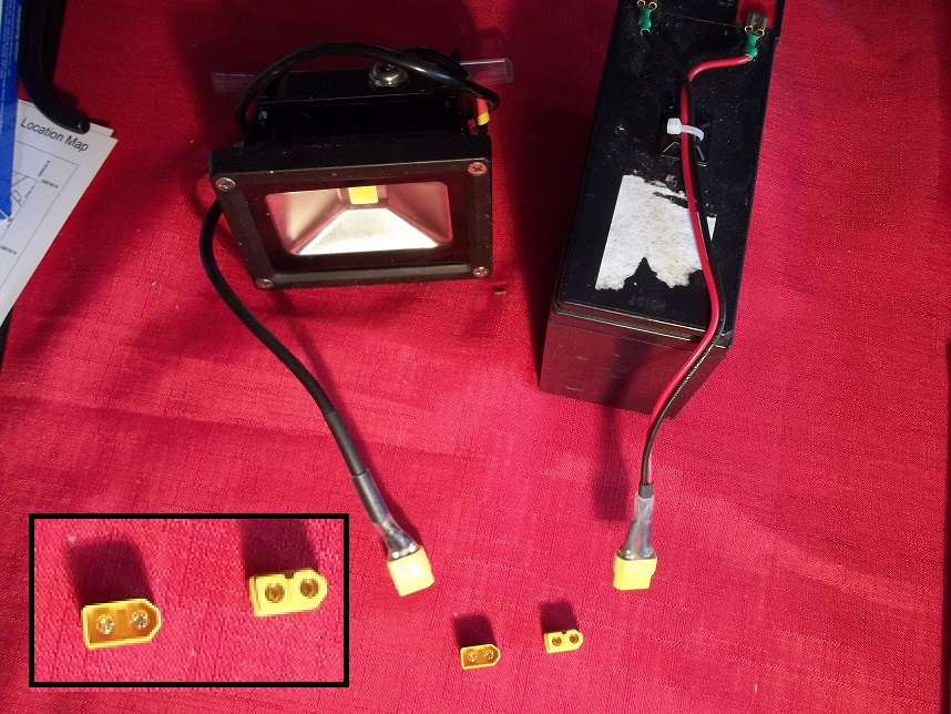

It does sound like reversed polarity could have been the reason
One option is to connect a polarised socket to the battery in a way that the polarity of the connection to the battery cannot be reversed/
Then put a matching plug on the lead to the radio observing the polarity.
Similar to this set up which I use for temporary lighting. Makes it nigh on impossible for the users to reverse the polarity to the lamp. I did not fit a fuse in the battery lead but to do so would be sensible to protect the battery.

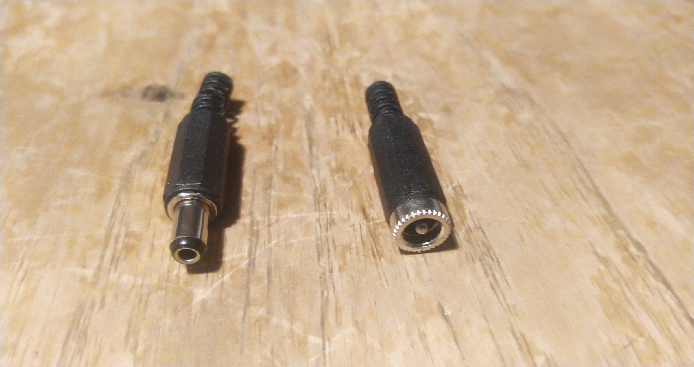

I'm using a 12v DC plug that fits the radio, and then a similar 12v DC plug & socket to connect/disconnect from the battery without messing with the terminals. I'll also add a switch and a fuse between the socket and the battery. So if I can get it right first time, and never switch the battery terminals by mistake, all will be well.
e.g. In the top right of your lighting rig photo, where the terminals attach to the battery box, if you connected the red wire to -ve and the black to +ve then the polarity would be reversed.
I'm currently using a cable with brown and blue wires. Maybe if I use cable with red and black wires then mistaked are less likely to happen.
