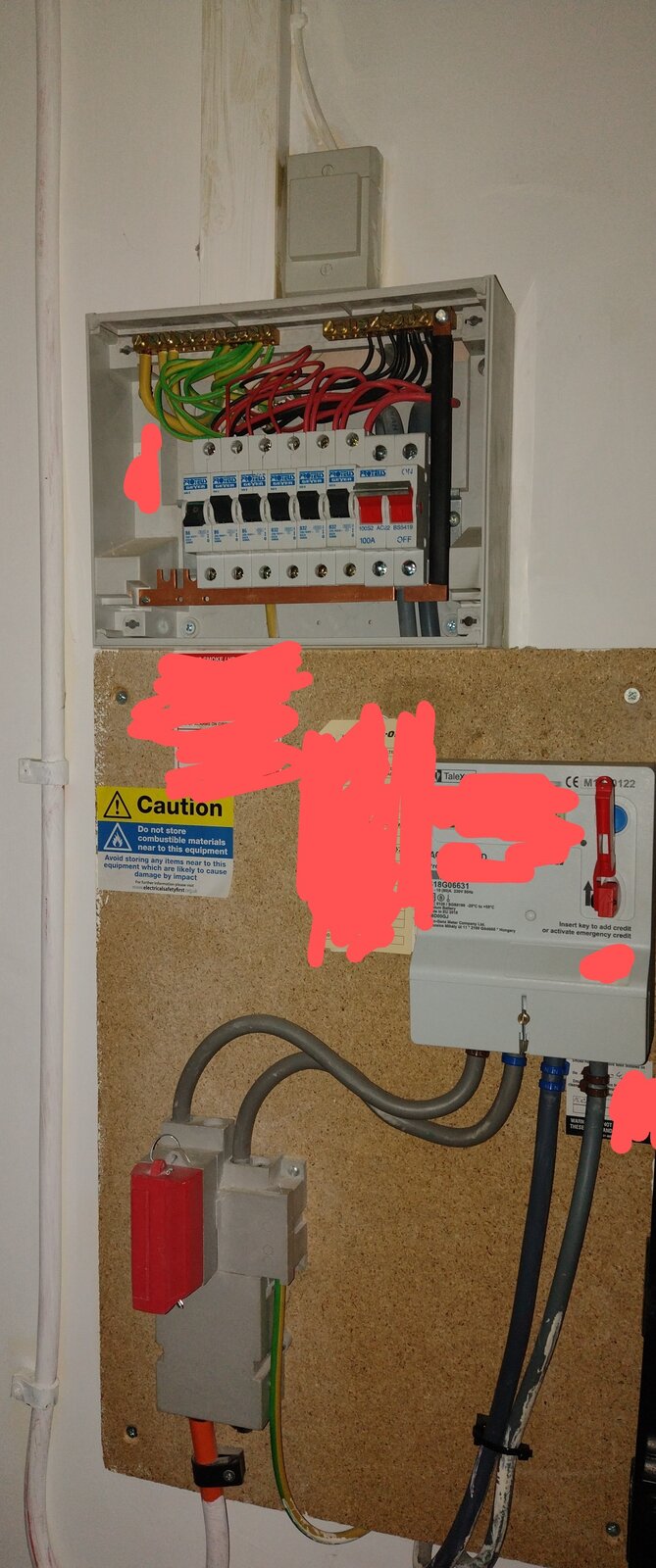

Given my setup (please see pic), how do i shut off power to the consumer unit?

What do you need to have done? The main DNO fuse would be an option for the DNO to attend to cut the seal, then a dual pole Isolator could be fitted.

Do not be tempted to pull that fuse yourself. It is potentially very dangerous without the correct knowledge and safety equipment.
Why do you have the bus bar exposed with the mains switch on?

I'm going to change the consumer unit.
I was hoping for a isolator switch to shut off power coming into the consumer unit.

If you do go ahead and pull the red fuse bear this in mind, so that you do it with full knowledge of the possible consequences:
If something goes wrong, the only protection between you and the transformer could be a fuse at the substation. If your installation is on the end of a long service, that fuse probably won't respond and in such a case the only real limit to the fault current is the impedance of the service cable. Should the cut out fail while the fuse is being removed (which can happen), a serious explosion with significant arc energy could result - the consequences being damage, fire, serious injury or death. The DNO use PPE for removing these fuses which you are very unlikely to own.
The safest solution would be to get your DNO to fit a double pole isolator between their supply and your CU. This is usually a fairly low cost (sometimes even free) option.

I get the feeling you won't be accepting any advice that differs from your DIY plan on this one, and you clearly live in an area where nothing bad ever happens, so your options seem to be:
* Switch off the red switch
* Cut the tag off the red fuse and pull it
* Check for dead and do the work
Or
* Check for dead
* Dismantle the CU, carefully cutting it apart to get the red switch out without damaging the cables
* Fit the red switch to an isolator enclosure like this one (https://www.cef.co.uk/catalogue/products/1667266-100a-dp-electricity-meter-isolator-switch) - discard or use elsewhere the supplied isolator if you can't find an enclosure without a switch
* Use the red switch to isolate the supply, fit new tails to it to supply your new CU
Be careful; this could easily be the last thing you ever do
Great advice. This is my first port of call.
