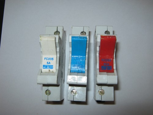

replacing cartridge fuses with mcb's
(the coloured fuse shields should not need changing, as the cartridge fuse shields are the same as the breaker shields). Turn the supply back on - job done.
Regarding the WYLEX
I dont think they are actually, the base for mcbs are different thickness to the fuse bases, and will affect how far the pins go into the blades
Its poor advise to change just one part.
If rewire-able fuses the bases need changing.
If cartridge fuses you may not need to change bases
so far i have to assume they are cartridge, that was pointed out to me in an earlier post
havent had one out yet...and if they are rewireable i definately want them replaced

sounds like wylex is the choice of the day ....i see proteus still do stuff...i looked on the website to contact them for the mcb serial numbers to fit this unit...they were pretty helpful

you have proteus, so I will shut up about wylex, it was more aimed at future user searches, getting the wrong idea NOT to change both wylex bits :)
Proteus, is CEF own brand.
They are a very big company but do get a lot of critisism though they aint the worst.
they also make a lot of industrial/commercial stuff, carphone warehouse amongst others used there distribution panels in nearly all there shops

Providing proteus send you mcbs that are same profile they should fit.
I dont know your board , but some unscrew then hook off the busbar, others you have to remove the busbar entirely to get them out.
If you can find pics of inside a board you will get the idea, though im sure the people doing the other work would fit them for you
No. They are not Wylex plug in efforts.
It's a despicable 1980s Proteus thing.

Those din-rail fuse holders are really past their sell by date! - Modern breakers clip onto the din rail, and are secured to the busbar with the bottom screw in most cases, and the red circuit phase conductor is connected into the top of the MCB, just like those old fuse holders, but much more convenient. Do check that the PFC falls within the MCB breaker's range, (usually 6ka/M6, but are available in 10ka/M10 versions too at slightly higher prices) before attempting such a change, unless there is a switch-fuse in the incoming tails feeding the board, as many others will probably state....

Nope it doesn't. It begins with an H, as DS has said. Tbf, I haven't fitted an amendment 3 wylex, but I did a plastic one in October or whatever, and it was awful. Hager are just much better thought out.
