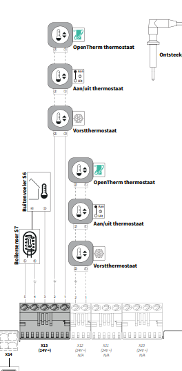

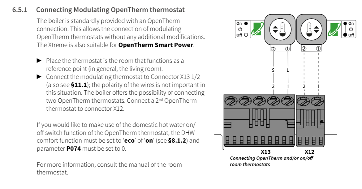

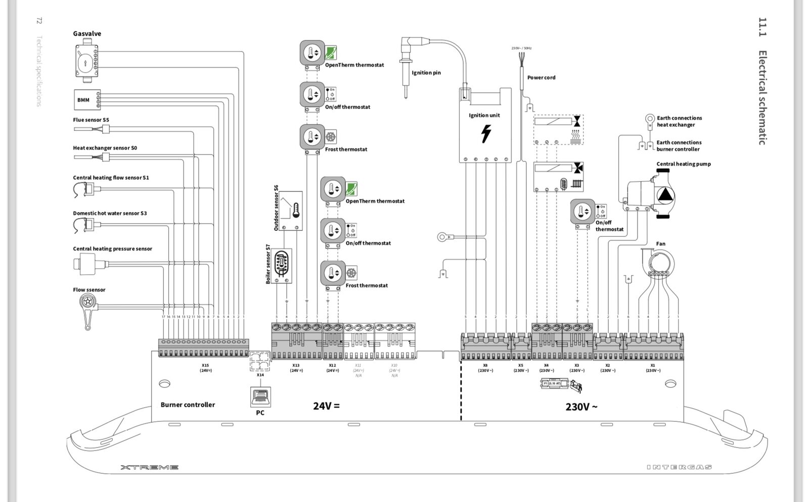

My current set up consist Intergas Xtreme 36 boiler with two Opentherm inputs. Nest 3rd gen connected to one Opentherm input to control the boiler. Second Nest thermostat E is waiting to be wired in.

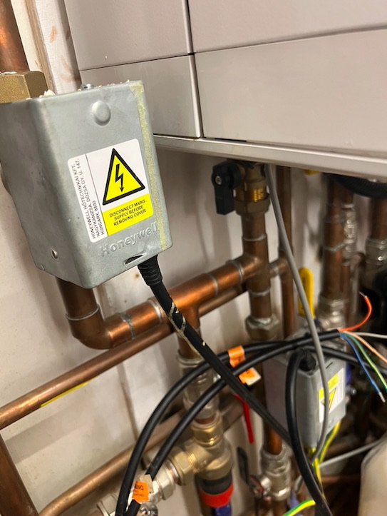

I also have 2x 2 port Honeywell V4043H1056 zone valves installed for zone 1 (downstairs) and zone 2 (upstairs).

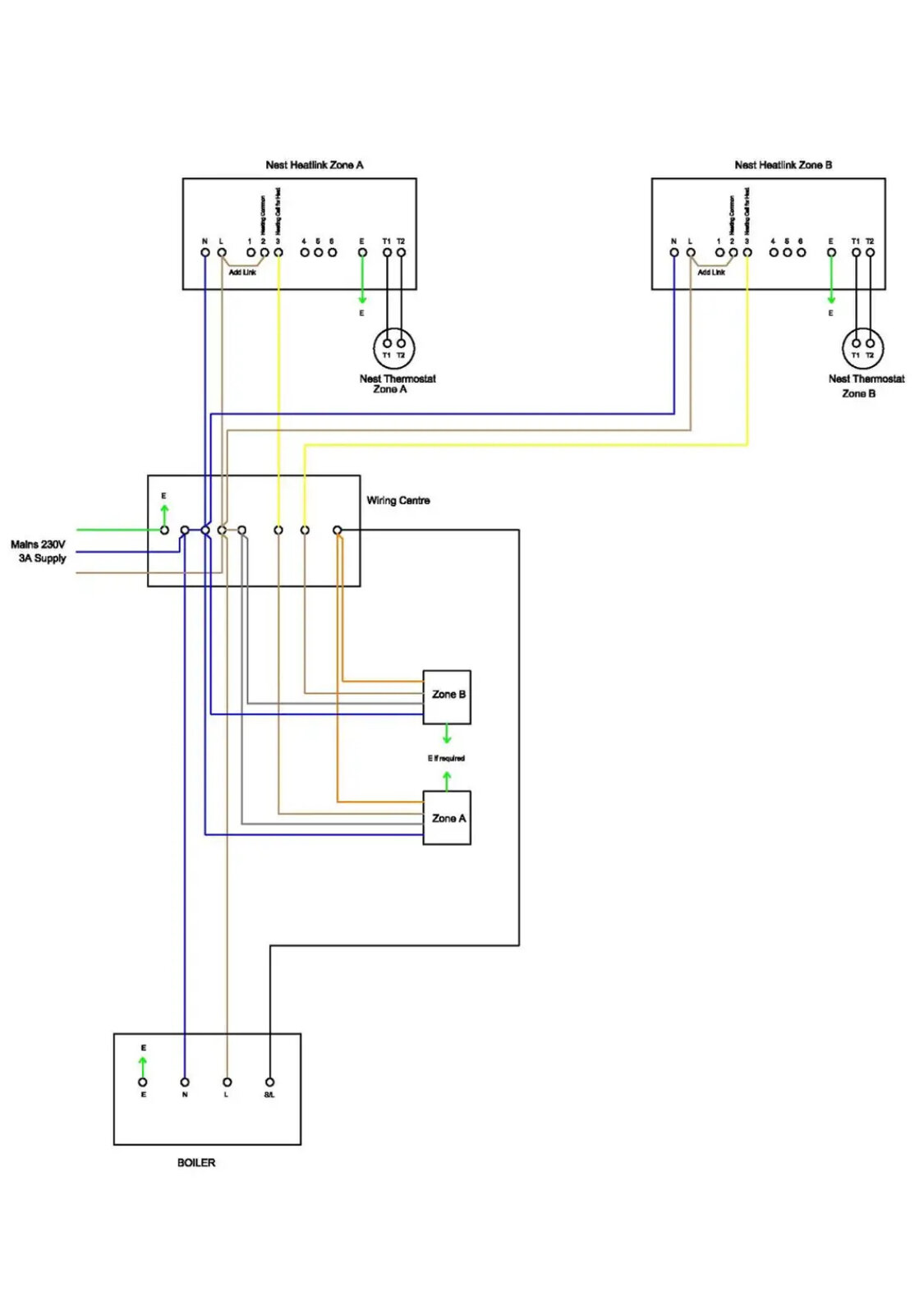

Would wiring look similar to this diagram created by @stem for similar installation? I'll insert picture of Stem's design into this thread for reference.
I would imagine that Nests connected via Opentherm to the boiler would call for heat and trigger the boiler to fire up instead of motorised valves or it should be wired in the same way as per diagram (valves call for heat) and Opentherm thermostats only control heat demand? T1/T2 on Heat Link would not be used, OT1/OT2 would be used instead and connected directly to the boiler Opentherm inputs (terminal 1/2 X13 & 1/2 X12).

My diagram doesn't use OT and I'm not sure how OT would be connected on a two zone system. OT modulates the boiler lowering its output when the room temperature approaches what is set on the room thermostat. Quite how one boiler would respond with two separate thermostat inputs that could be sending conflicting requirements I don't know. Although as your boiler has two OT inputs that sounds promising.

T1 & T2 on the Heat link is to provide the thermostats with 12V for operating power (they don't have batteries)
The Heatlink's would still need to be connected to the motorised valves as they need to be opened when heating is required. One motorised valve by each Nest otherwise no water would flow to any of the radiators.

OT1 & OT2 on Heat Link will be connected to OT input (terminal 1 & 2 X13) on the boiler PCB.

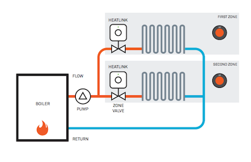

According to Google, Nest thermostats are compatible with zoned systems:
