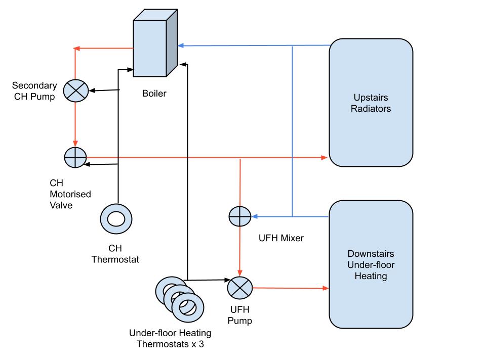

I'll draw a picture.

As the UFH thermostat does fire the boiler, there must be a link back to there - it should be possible to use this link in reverse, to enable the UFH pump from the main wiring centre.
Something like this. I haven' shown the three separate underfloor loops and actuators, but you get the idea.
Nobody would have designed it this way. I think the folks who build the house contracted the underfloor heating separately from the rest of the plumbing and they didn't talk to each other. I'm pretty sure the UFH was supposed to be a separate circuit, which is why (including the boiler) I have three pumps in a 4-bed house.
Thanks for the image, it also appears that you have 3 UFH stats, which brings me back to...
has it got a separate underfloor sensor?
Do your UFH stats have separate sensors?
These may make it more complicated to transition to a Nest.
However, your main problem seems to be that the UFH stats aren't triggering the 3 port valve.
I don't know about the others here, but I would attempt to tackle that, before thinking about the Nest.

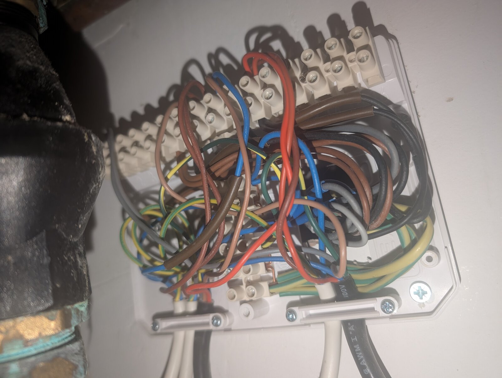

Meanwhile, this is the wiring centre in the airing cupboard. Possibly additionally complicated by our thermal solar, but I don't think that's the only issue here:
It looks like you have two 2 port valves, rather than a 3 port valve?
It looks more like an S Plan system, than
I have a conventional Y system (boiler, HW tank, CH).
That does make things (only very) slightly more straightforward.
In the wiring centre, does the flrst white flex from the right go to a pump?
